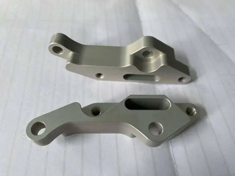

Disc brake adapter for a 97 marzocchi bomber z1 needed as I just got the disc brake and the hole spacing is different on the 97 forks. Pre IS apparently. Grrrrrrrrrrrrrrr

There were a very very small number of the 'Formula Standard' to IS mounts produced BITD but these are long since out of circulation in my experience. I have a set of 97 Z1's and had the same problem on my Spooky build, I resolved it by searching for and locating a #4 (Formula Standard) Hope C2 Caliper, it took a few months but they are more freely available than any other option. Good luck.

Posted on your other thread, you would do well to search the forum, big Eck made some adapters... And twin disks

A2Z components made adapters for those forks. Actually formula and IS mounts are the same bolt spacing as I recall, but the mount distances from the axle center is what is different. IS calipers fit formula mount tabs, but then the standard rotor size ends up a mm or so too large in radius, and the top of the disc rotor carves into your caliper as it spins. The 1998/99 Manitou forks used the formula spacing, when I ran a IS caliper on one with a 160mm rotor, it dug a groove into the top of the caliper as well as into one of the mounting bolts.

I'm beginning to think I would be better off swapping them z1's for some forks I can mount the brakes to. The IS bracket hole to the fork are about 1-2 mm further apart. Then the caliper isn,t far enough accross for the disc by 3mm ish and the disc needs to be spaced further from the wheel as the spokes are hitting the caliper. Grrrr. The other option is changing the front wheel and using V brakes. All I want to do is take it for a good hack in the forest.

Just a small correction:
- IS mount: 51mm
- old Formula standard: 48,55mm

If you have hope brakes with 185mm rotors, you can get away with using 183mm rotors from the V2 and use lots of spacers when mounting the caliper.

B3 on here makes adaptors send him a pm he specifically made a batch of these
