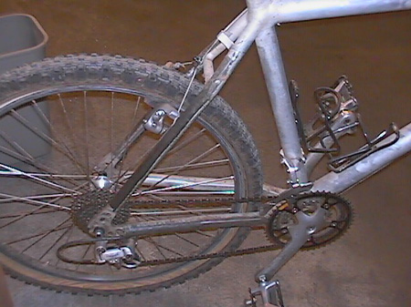

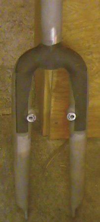

outch, is that the Adroit in question?
looks like all the carbon re-inforcements on the chain and seat stays and the fork crown were removed along with the paint. not good.
carsten

the carbon renforcement (Boron) wasn't internal?
PostPosted: Tue Nov 06, 2007 4:11 pm
Klein Guru / BOTM Winner
Joined: Fri May 05, 2006 6:06 pm
Posts: 984
Location: Houston TX
no, it was on the outside of seat & chain stays and the fork crown. the wall thickness is less in these areas and the carbon/boron was used to increase strength but not weight. it's the black stuff on the photos
Carsten

do you think there's a risk to break the frame and the fork without it?
PostPosted: Tue Nov 06, 2007 7:05 pm
Posts: 984
no idea but i would carefully check those areas after each ride for cracks.
just to give you an idea: the Attitude rigid fork in that size weighs 610grams and the Adroit fork 560grams so they took away quite a bit of material.
Carsten
