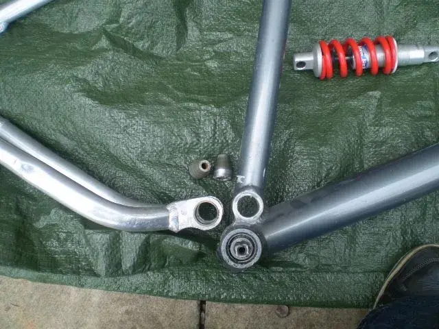

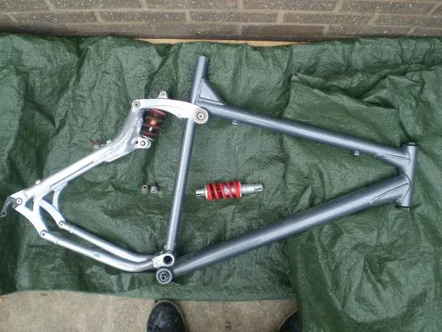

I am after some bottom swing arm bushes for my gt lts 3 they are the ones that attach near the bottom bracket. Pics up if i can get them up. Thanks. May let them go if i cant find a set.

there should be two 0.875" kevlar-reinforced Acetal bearings/bushes that fit into the swing arm, then a collet piece/spacer that fits into the pivot point on the frame and then the two cone sections you have to hold it all together.....working on that I would say you need the kit from betd that seems to replace the acetal bearing/bushes and uses a roller bearing

Thnaks for the info. I was getting lost with this. Ive ordered a set now so case closed. Hope to have it built up soon. Thanks to all.

Reopening as i still have not found parts for this. I think the bottom/chainstay main pivot has a internal sleeve? cant seem to find them on betd etc. Im sure the frames a 1996 lts 1 or lts team. help much appreciated. THE serial number is weird as it is: S7CA0039 Anyone any ideas? Thanks
