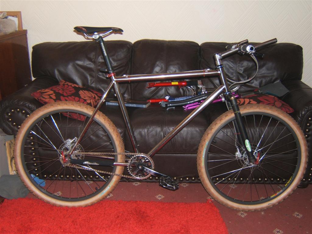

post a pic and a spec list andy I'm sure we could get it under 20!
PostPosted: Tue Feb 22, 2011 2:05 am
Gold Trader / MacRetro rider
Joined: Sun May 25, 2008 11:03 am
Posts: 18892
Location: Sunny Glasgow
Frame : Unknown Titanium [origin Italy]
Forks : Pace RC-31 hollowform carbon with unique stash pot on right leg
Bars : Kore Lite1
Barends : Unknown Titanium
Brakes : Hope Tech X2's Braided hose
Headset : Chris King 1 1/8" Nothreadset with 1" reducing cups
Stem : Specialized S-works Titanium stem
Grips : ODI Rogue
Saddle : SDG Ti Fly cro-mo
S/Post : Kore Forged
S/Clamp : Hope Bolt on
Cranks : AC Lo Pro Forged
Pedals : Atomlab Aircorp
B/B : Shimano UN-72
S/S kit : Gusset Cogs/Spacers/1/2 link chain
Wheels : Hope Bulbs 32h silver/ Mavic X517/DT butted
Skewers : Hope QR ti rear
Tyres : Michelin Wildgripper amber skinwall
PostPosted: Tue Feb 22, 2011 9:00 am
Joined: Sun Apr 02, 2006 1:03 pm
Posts: 11811
Location: Returning
Frame : Unknown Titanium [origin Italy] - whats it weigh ? under 4 lb OK
Forks : Pace RC-31 hollowform carbon with unique stash pot on right leg -empty stash pot
Bars : Kore Lite1 - swap for some lighter bars 140g ish
Barends : Unknown Titanium - bin them
Brakes : Hope Tech X2's Braided hose - fit cantis saves a ton
Headset : Chris King 1 1/8" Nothreadset with 1" reducing cups - okay but you'll find sub 100g headsets fsa cane creak
Stem : Specialized S-works Titanium stem - weight ? truvativ xr + 115g
Grips : ODI Rogue -heavy heavy heavy find 50g ones
Saddle : SDG Ti Fly cro-mo -fit modded flite slr or a roadie lite one 100gish
S/Post : Kore Forged - use or similar 150/200g item
S/Clamp : Hope Bolt on -25g e-bay special ,drilled
Cranks : AC Lo Pro Forged - dunno but prolly heavy
Pedals : Atomlab Aircorp -?
B/B : Shimano UN-72 -heavy heavy heavy even a 52 is 50 g lighter
S/S kit : Gusset Cogs/Spacers/1/2 link chain -? chain maybe 9 speed sram is lighter
Wheels : Hope Bulbs 32h silver/ Mavic X517/DT butted - heavy heavy heavy
Skewers : Hope QR ti rear - cheap e-bay ones are lighter
Tyres : Michelin Wildgripper amber skinwall - dunno what they weigh
look for something around 400g , wild slippers aint the most grippy either
constructive critiscm andy :lol:
here to help
