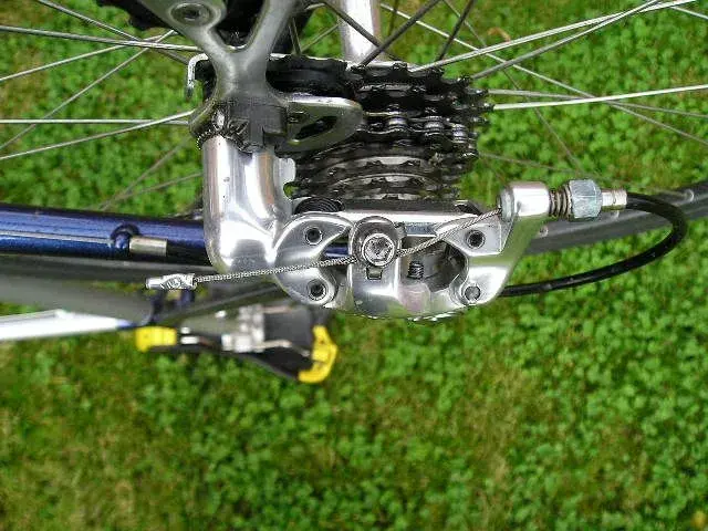

Campag front works okay with Shimano shifters.
Camapg rear works well with Shimano shifters ONLY if you put the inner wire on the wrong side of the pinch bolt. This is my Campag Veloce running with Sora STI on my Road bike.
PostPosted: Wed Oct 10, 2007 1:32 pm
Joined: Sat Jul 29, 2006 11:14 pm
Posts: 4057
Location: Somerset
Campagnolo mech, over shimano spaced block, using Shimano STI cable routing:
