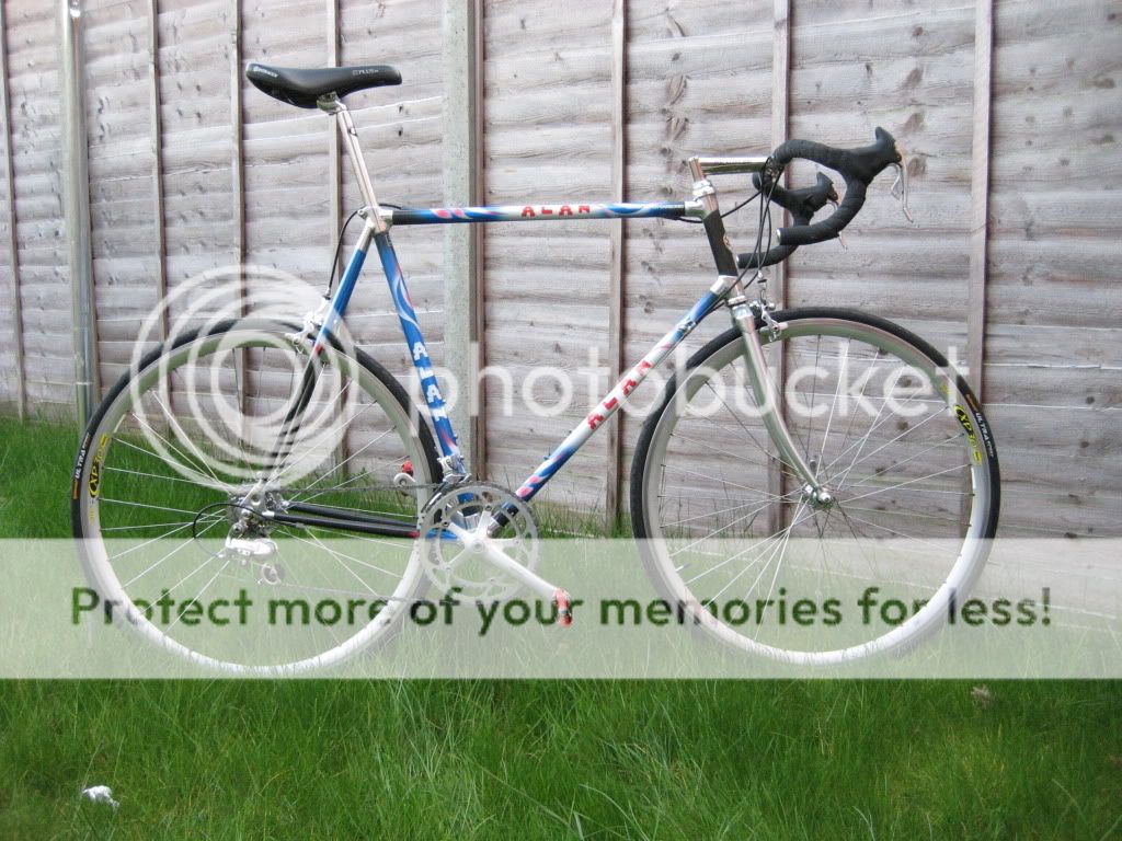

I bought this frame/forks from Wheelnut a while ago, been slowly collecting parts...
Built up at the weekend:
So whats it like...
Its a touch flexy, but not too bad, and is quite possibly the most comfortable bike I have ever ridden - on our 3rd world roads it just glides along, and is sooo light - spin smoothly and it goes like the the proverbial off a shovel... Fits like a glove too...
Need to source a new cassette - the one on it is a bitsa campag 8 speed... and the BB seems to short - the chain shifts itself onto the large ring by itself when down the small end of the cassette - suggests to me the chainline is off...

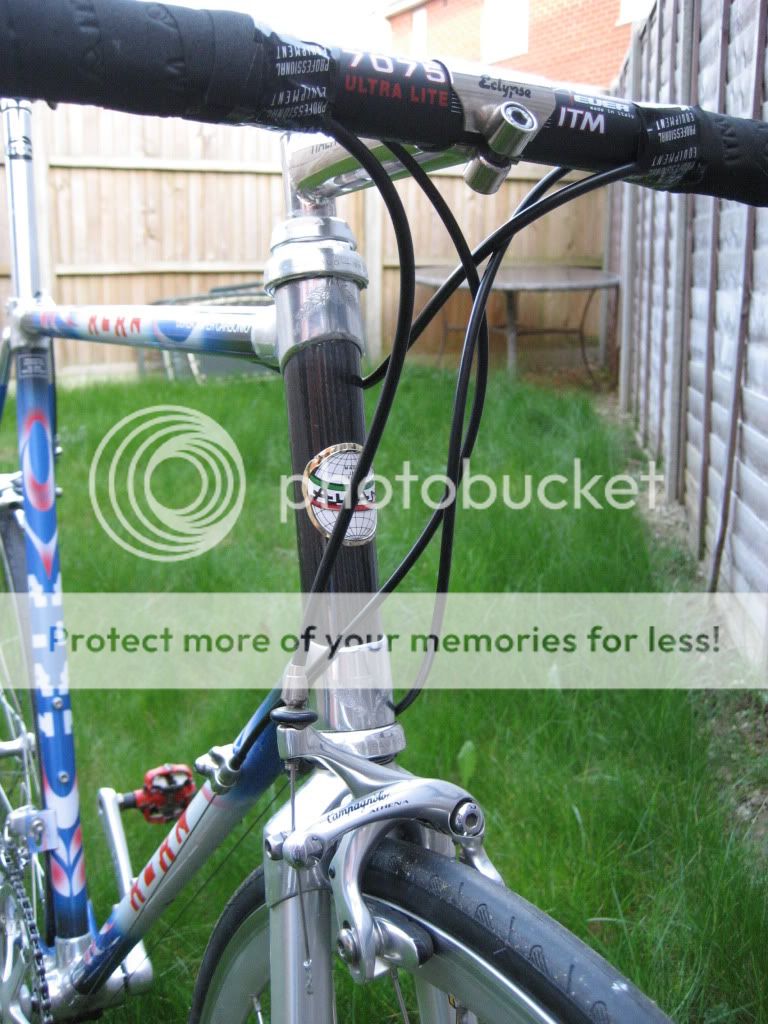

All parts campag athena 8, except chorus BB and headset...
Soon to be added Chorus Chainset and on the lookout for a Chorus/Record 8 sp rear mech.
Cheapo 25.0 seatpost, comfy bonty saddle, ITM bars, stem and tape...
('scuse the poor tape, I havent done it in a while and the red wine effect means I missed a bit! doh!)
Thoughts on a postcard...

Lovely job you've done there with the Carbonio, Fingers. :)
The chain problem is a curious one. I used an almost identical Campag double chainset with that same Chorus BB and never had that problem, although it must be said that I would never attempt to go small ring to small ring or big to big simply because the chain line will be compromised and you lose efficiency.
As for bottom bracket length, you generally want to go as short as you possibly can in order to obtain the optimum chainline. Perhaps the chain you are using is a not flexible enough. If it's old stock, the grease in the link pins may have hardened, making the chain stiff and causing the issues you describe. I would try using a different chain before changing anything else.
Anyway, I'm really pleased that my old Alan has found an appreciative home. Still curious as to its age though. I have a suspicion it might be late 1980s.

My research (and ebay watching) may suggest its early 90's????
Anyway Im not too fussed - Im very impressed with the ride, It goes out first when choosing a roadbike to spin... Sooooo smooth!

back to the chain problem. Are you using a 8 speed chain on 9 or 10 speed chainrings? If you are, this could be the source of the problem. Although, it will generally work ok, a wide chain on narrowed chainrings will allow the chain to slop around laterally, most noticible on small ring/small cogs. It doesnt ususally manifest itself into unwanted gear changes, but there will be a noticable tinkling of the chain catching the larger CW's teeth as the chainline is crossing over.

The drivetrain issue occurs with 8 and 9 speed chains... I have noticed the outer ring is a stronglight, so will be trying a set of campag rings on there soon...
Ill let you know how I get on!

Chainset issue solved...
Bought a chorus chainset (w campag rings) and it seems to sit slightly further out... Result - better chainline, no snagging and perfect shifts!
