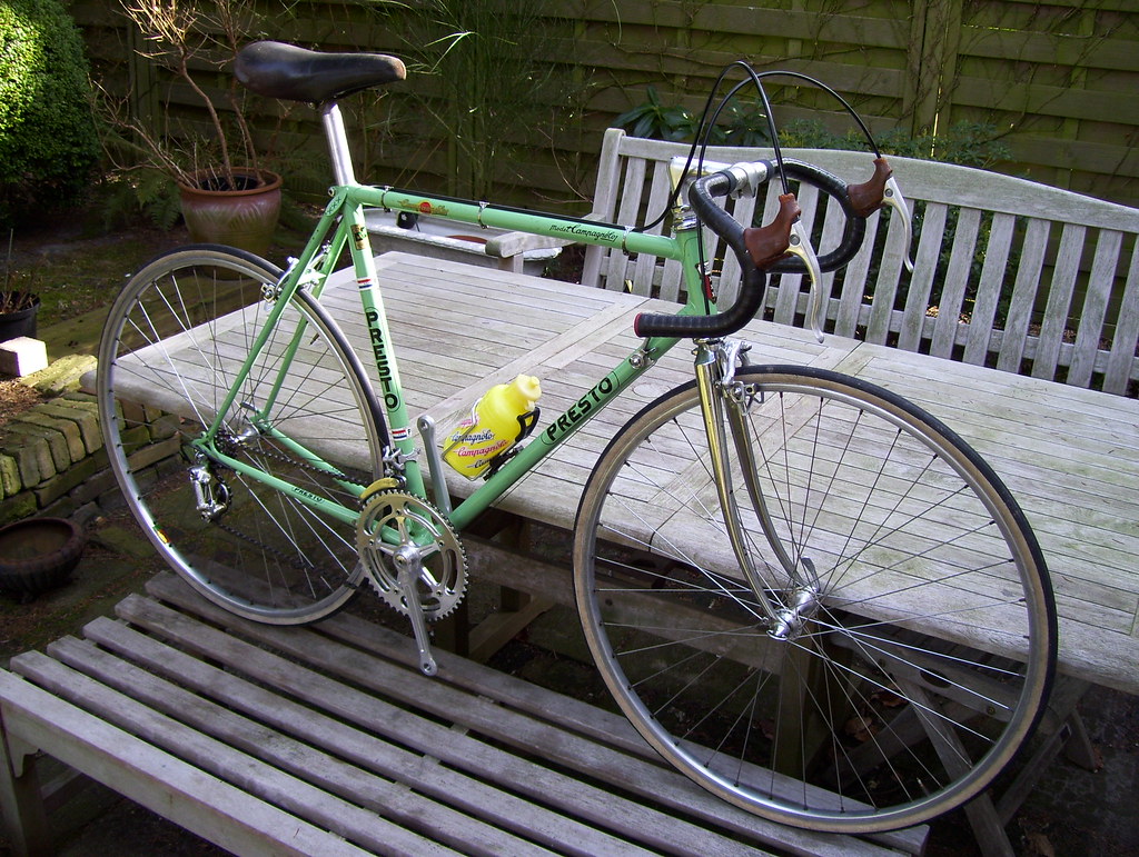

Something really different than the Vitus FCK9/Zap I am busy with now: A really fine steel frame with conventional Campagnolo Nuovo Record groupset.
I just finished the major overhaul. My aim with the resto was to leave the patina fully in tact, but guarentee optimal function at the same time.
The 1st pics -->

Very nice :D

nice bike mate.

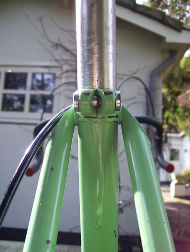

This mid 70s Presto (Amsterdam, Holland) frame is made by a masterbuilder with a very perfectionist attitude: Peter Serier. Peter had a background in fine machanics. Throughout the bike this shows. There are plenty nice touches.
Notice the slot with the drillings at the ends under the clampbolt. Peter considered that superior in constuction than the usual clamping-solution -->

thats a nice bike,and i am not really a roadbike person.

Lovely bike - and a nice restful shade of Green :wink:
I like the seat clamp arrangement. Very clever and probably less stressful on that area of the frame.

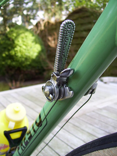

Nuovo Record shift-control >>
Looks like a regular shifter, but when looking closely you spot a 2nd small lever hidden under the shifter. This pic shows it better >>

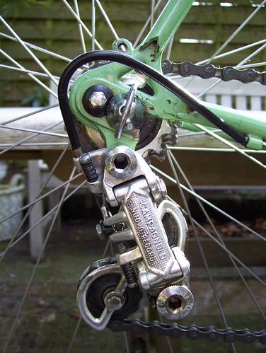

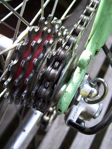

When you lift the bit you can position the shifter one step down and the chain will shift onto below plate that sits bolted to the frame >>
The purpose is that when you take the rear wheel out, you first shift down onto the plate and the chain will still be tensioned with wheel out.

Rear mech

'Portacattaneo' - I had a set once but the frame wasn't drilled to take dropout part. Not often seen fitted.

I'd heard of that chain carrier thingimijiggy before, but never seen one in situ. thx for posting up.
