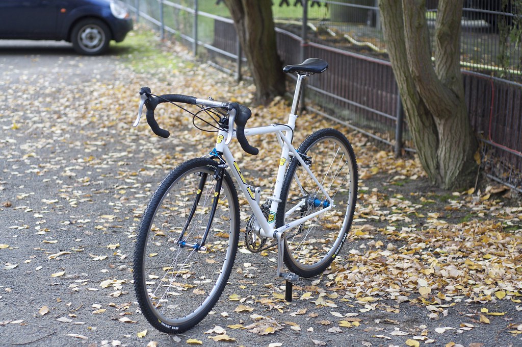

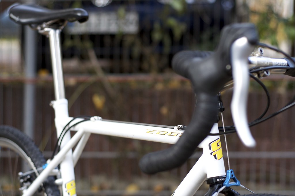

No nonsense and not time correct :lol: build of my GT EDGE CX 853 steelbike the little brother of this bike http://www.retrobike.co.uk/forum/viewtopic.php?t=74101.

That is stunning !!
Always wanted one of those and was gutted when i saw one go on ebay last year for 300 quid !

Yes it's very hard to find one of these frames i'm very happy that i found one for a "resonable price".

lfo you are very lucky to have found one, very few were made and all ride reports by those who have had them are outstanding.

Rare indeed, assume it dates from 98 or 99 from the decals.

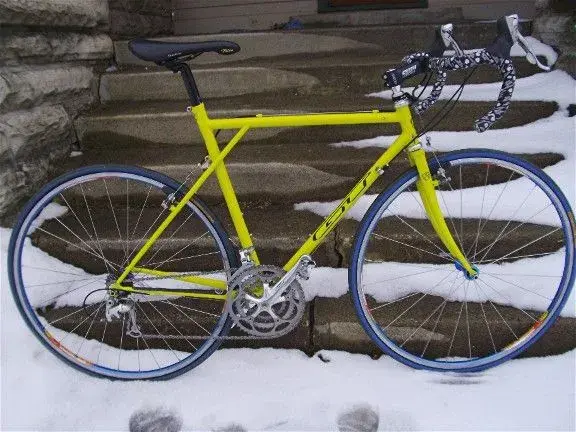

Rare yes, but I too got lucky :D
Details in the cross bike thread
