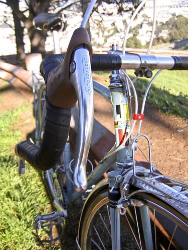

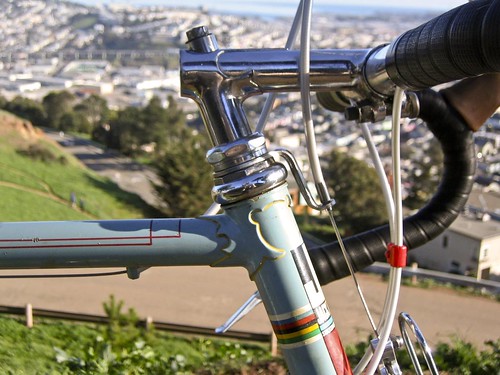

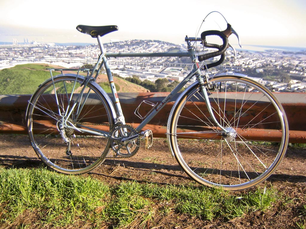

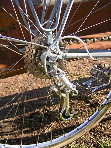

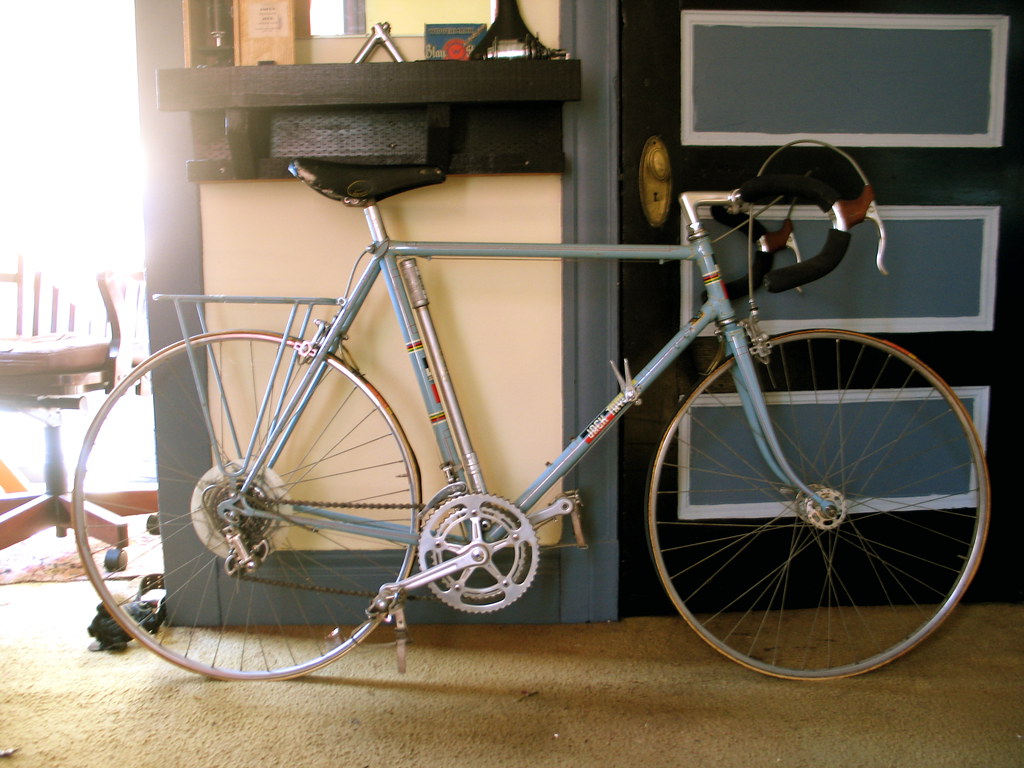

Bike as I got it:
and when i was done!
1970 Jack Taylor Tour of Britain
Headset: Campy Record (?)
BB: Phil Wood
Front wheel: Schmidt SON20 to MA2
Rear wheel: Phil Wood to MA2
Tires: Grand Bois Cerf
Fenders: Honjo Hand Hammered
Rear Rack: Original Jack Taylor
Front Rack: TA
Brakes: Mafac Racer with velo orange shoes and Matthauser pads.
Brake Rollers: Velo Orange
Handlebars: Grand Bois "Maes" I drilled to allow internal cable routing
Stem: Unknown Lugged British ?
Shifters: Dia Compe Silver
Front Derailleur: Campagnolo Record
Rear Derailleur: Campagnolo Nuovo Record with a cage swapped from a Campagnolo Rally Derailleur.
Brake Levers: Campagnolo Record
Seat Post: Campagnolo 2 Bolt
Saddle: Leather Cinelli Unicanitor
Freewheel: IRD 11-32 6 speed
Crankset: TA Pro 5 50-46-30
Chain: Regina Oro
the only original parts are the brake levers (though hoods replaced), headset, seatpost, saddle, pedals and toe clips

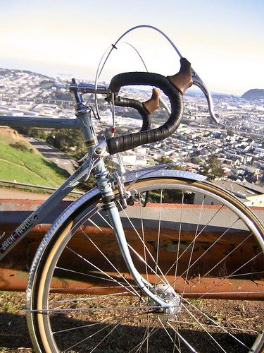

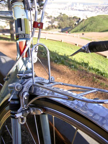

Looks good - like the paintwork on the frame as well. :)
What Mudguards are those?
Cheers :)

Very nice bike! My compliments! It is very close to a touring bike I would like to build in the future. I will surely use it as reference!

thanks!
DA - They are Honjo fenders.

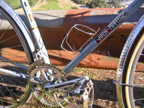

Looks great, nice job. A lot better than its original condition!
What BB and axle length have you used with the TA cranks? I've just acquired a pair to put on my '58 Pennine and not sure what to do. Mind you, I'll be using them for a double and you've got triple.
PostPosted: Thu Oct 15, 2009 4:09 pm
Joined: Sat Oct 03, 2009 3:24 am
Posts: 23
Location: san francisco
I used an asymmetrical phil wood with campy taper. 115-118 works for a double, 120-121 for a triple
Thanks for that. I was thinking around those lengths would be right but needed a confirmation from someone that's done it! I've actually sourced a possible supply for a couple of TA axles and cups so might be able to fit the real thing in due course.
