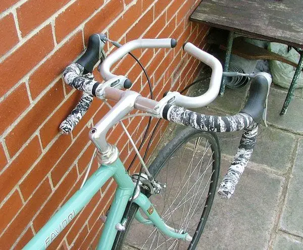

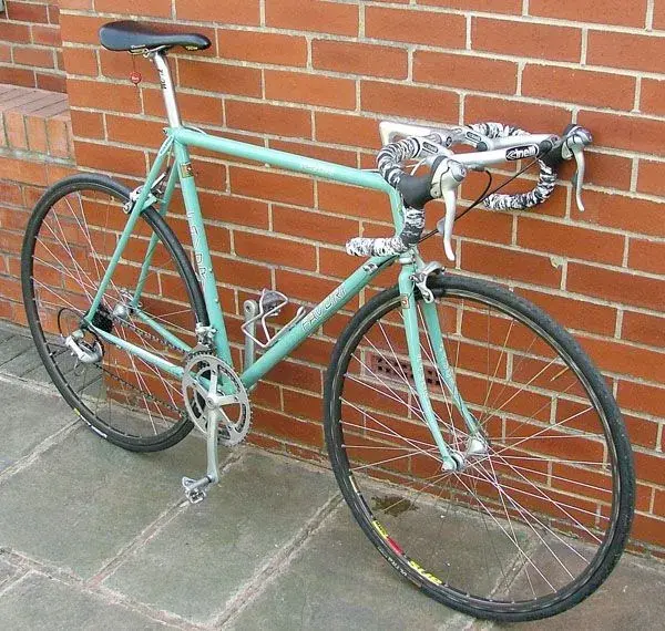

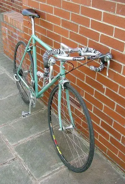

Last seen just as a frame I have now been able to build this into a complete bike using parts from my time-trial bike (which will hopefully be upgraded for next year). I went out on it this morning for a couple of hours and, apart from a few small position tweaks, it felt good. I'll try it on the group run in the morning which is around 50 miles and I don't expect any problems.
Frame: Columbus EL (the lightest Columbus tube set made) 57cm
Fork: Columbus EL with sloping crown
Headset: Campag Mirage
Stem: Cinelli XA
Handlebar: Cinelli 64-42
Bar Tape: Mottled Black & White!
Brake Levers/Brifters: Shimano 105 8 speed STI
Brake Calipers: Shimano 105 Dual Pivot
Brake Pads: Shimano
Brake Cables: Yes!
Shifters: Shimano 105 8 speed STI
Front Derailleur: Shimano 105
Rear Derailleur: Shimano 105 8 speed
Derailleur Cables: Yes
Cassette: Shimano 8 speed
Cranks: Shimano 105
Chainrings: Shimano 105 52-39
Bottom Bracket: Shimano UN54 107mm
Pedals: Shimano SPD
Rims: Mavic Open SUP Clincher
Hubs: Shimano 105
Hub Skewers: Shimano 105
Nipples: Yes
Spokes: Stainless 15/17
Tyres: Michelin Axial
Tubes: Yes!
Saddle: Titanium Flite
Seatpost: Zoom
Seatpost Binder: Allen Key bolt
Bottle Cage: Alloy
Extras: Cinelli Spinacci Bar Extensions
Weight: approx 21 lbs
I've realised that I don't have a very good side-on shot so I'll try and get one tomorrow.

What do you think of the Spinaci things Ned? I think I detect a real difference to say, the hoods. Could I feel any difference or would it take a stop watch?

John wrote:
Looks a solid mid 90s road iron built from quality tubing - bet it rides nice! TBH not heard of the brand though.
John, you surprise me. You've heard of Ellis-Briggs of Shipley though, haven't you? Ridden by lots of top Yorkshire roadmen in the past, Ken Russell from Bradford won the 1952 Tour of Britain on one and the bike is regularly displayed at the annual Classic Bike Show. 'Favori' was/is a 'brand name' they use.
Have a look here -
http://www.classicrendezvous.com/Britis ... s_main.htm
And you're right, it does ride well. I've been out with the weekly group rides several times on it for 50-60 miles and it's fine.
Regarding the Spinacci's, I fitted them for show rather than go as befits a '90's bike but in fact I've taken them off for actual riding as I didn't use them, especially in the group. I find them a bit short and low for comfort but I suppose if you get used to them there will be an advantage just like tri-bars. I can see why the UCI banned them for bunch racing as control is compromised in 'the tuck'. Better off with a proper set of tri-bars if you want to time trial or similar.
