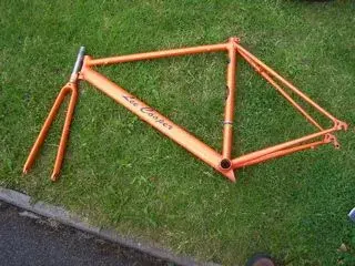

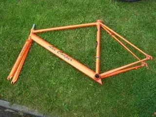

I started to look around and decided that I wanted to get a Lee Cooper (it was always going to be steel!), thinking that I would get one made. With money tight this was going to be a slow build. However, on this site on popped up, in great nick and a few days later the build started.

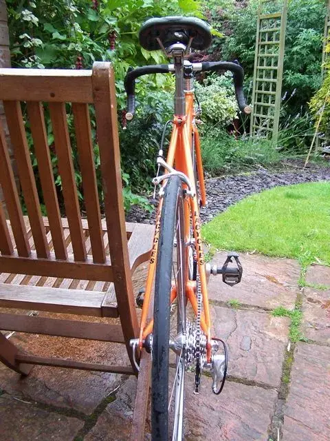

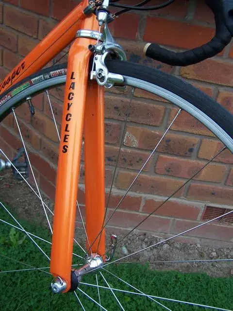

The bike then started to be built. There are a number of issues re the bike the first was that the fork's steerer was not that long so I have to use a BBB extender and the other was there was no cable guide for a fd, it was designed to be a single up front.
So the build started. The frame was near perfect.

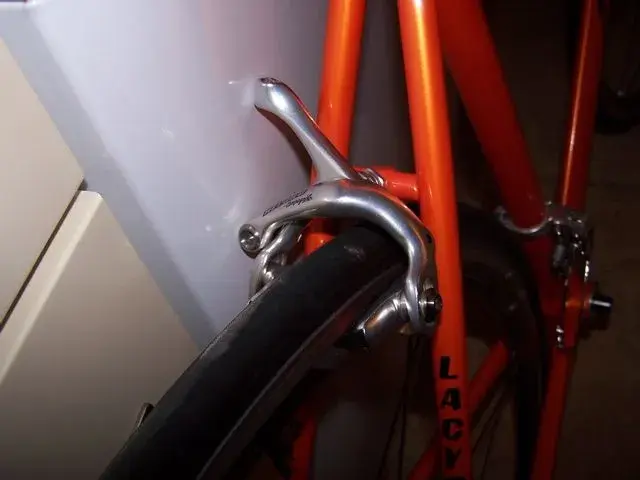

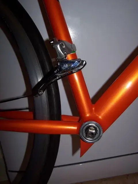

First went in the bb and probably my best photo. this was a campy record bb and nearly the only bit of carbon.

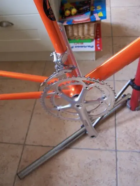

The headset, the crank, fd, brakes are campy record.

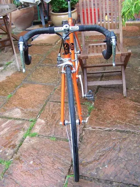

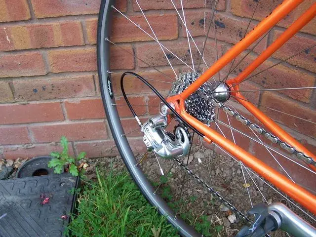

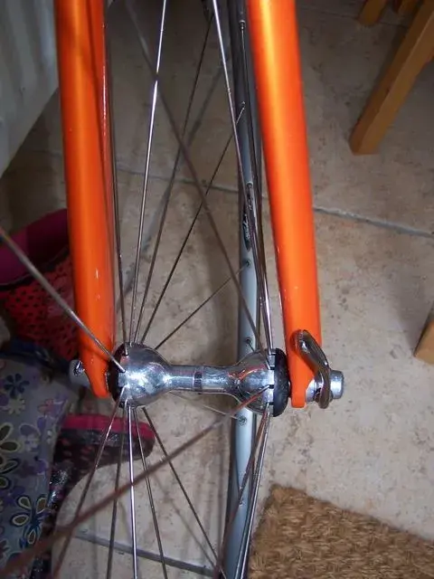

The bike as started to take shape, the final bits to get were a nice set of wheels and the rear.
The wheels are a set of Electons with Record Hubs.
I then choose to go with Athena and Chorus. The Rd and cassette is Chorus and the Ergos and seat post are Athena. The stem and handlebars are Cinelli and wrapped with Brooks and the seat is a Sella Itallia from around the 1998-2000 period.

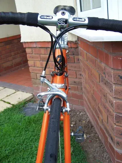

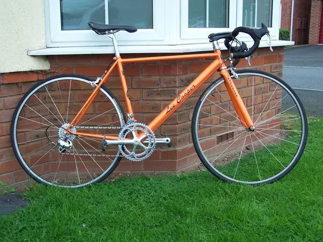

Now this is what my new pride and enjoy looks like.
I have had taken it out for a quick spin and feels great. The bike and has come in at 19.5lbs, which for a steel bike is great.
Hopefully this will bring me years of enjoyment.
