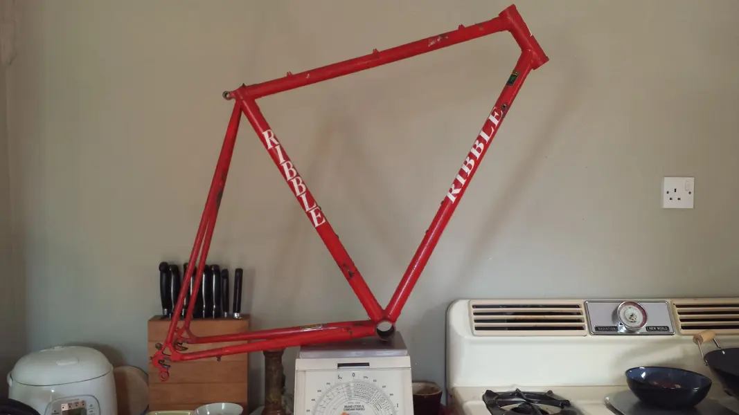

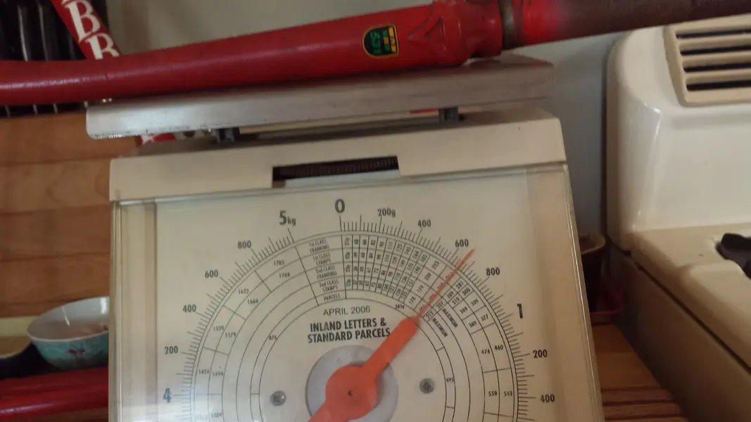

Had this old Ribble frame lurking in the back of the garage for a couple of years, so draged it out with plans to move it on. I bought it as a complete bike and had gradually robbed it of parts for other builds. Once fully striped down I couldn't believe how light it was and noticed that it was 531c and not 531db as I'd initially thought. On the scales frame weight is approximately 1790g and the forks approximately 660g. My next thought as it's bang on my size, is to build it up as a 'Modern Classic' road machine. :)

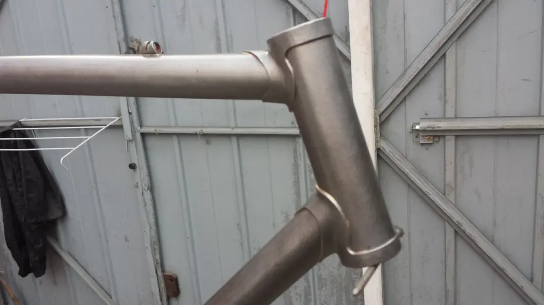

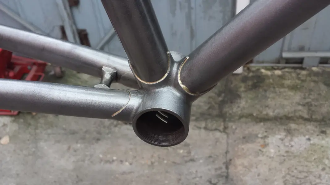

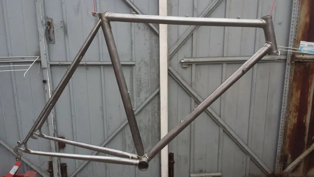

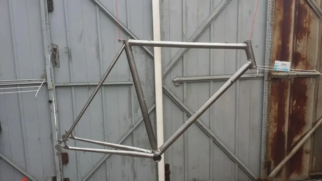

Next I had to make a decision about whether to splash the cash on flashy new paint n' decals or go down the raw naked steel route. I've always liked the look of raw Titanium frames with their black carbon forks...so that was it... decision made..less is more and splash the cash on a new set of wheels instead.
Old decals were peeled off with help from the good lady's hairdryer and the frame and fork chemically striped.
Into the hi-tech spray booth and the forks were grey primed and then three coats of gloss black laid down.
The bare frame was buffed using various sizes of brass wire wheels in my Hitachi cordless until a nice uniform brushed finish was achieved. I gave the frame a final rub all over with an aluminium pot scourer then cleaned with the good lady's nail varnish remover.
Back into the hi-tech spray booth the frame was strung up and two coats of satin clear-coat laid down.
Total cost of materials...
Poundland grey primer £1
Poundland gloss black £1
Lidl satin clear-coat £2.49
Now there's money in the pot for them wheels.... :D

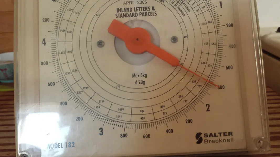

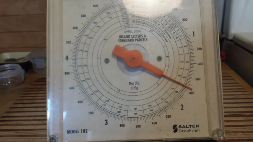

Managed to lose some weight in the process with the forks weighing in at 650g and the frame coming in at 1750g.... not to shabby at 2.4kg all in for a size 54.5cm CTT....Yeah... Steel is Real... :D

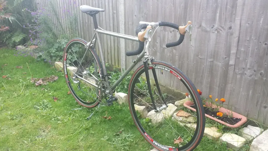

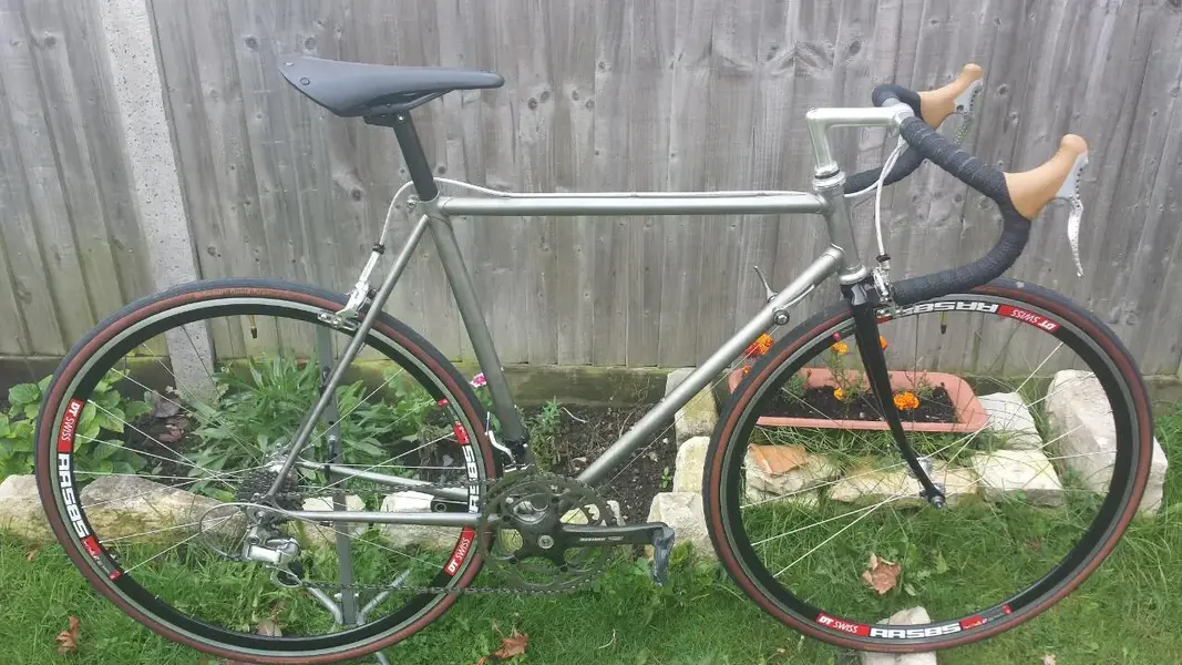

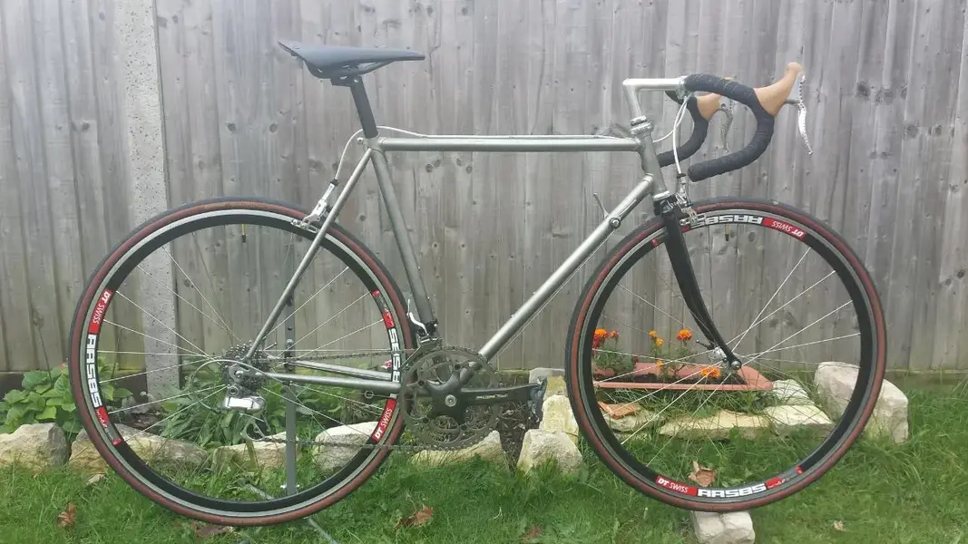

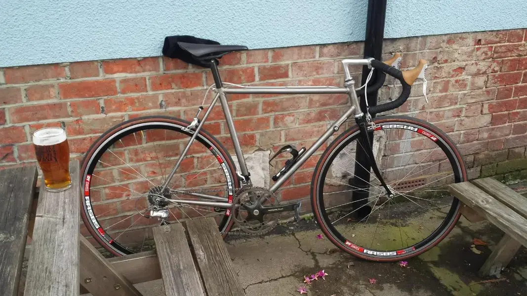

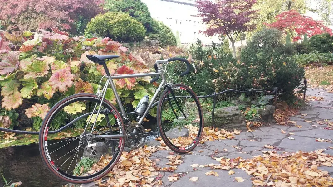

The Ribble has now been built up with what I would consider to be some of the best looking modern' ish components with some contemporary classic style additions. I have committed the ultimate sin of mixing Dura Ace with Campagnolo Record cranks so my apologies...I just think the carbon looks cool... 8)
Still waiting on head badge decals which I'm having especially made up.
Took it out for its first shakedown and was completely blown away by the ride quantity which is so incredibly smooth and forgiving with no vibration on the bars and rattling brifters as I find with modern machines. This has to be the smoothest, quietest and quite frankly the best bike I have ridden. Maybe it's the super smooth running Royce hubs and combination of Continental Grand Prix Classic 25mm tyres with supple Vredestan latex tubes have that have contributed to this. Can't wait for it to stop bloody raining so I can get out and enjoy the ride.. :D

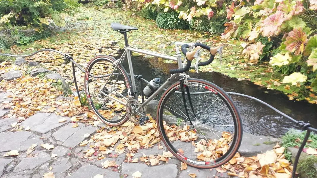

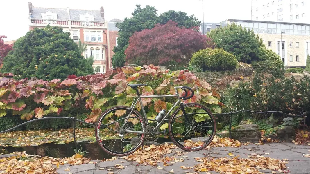

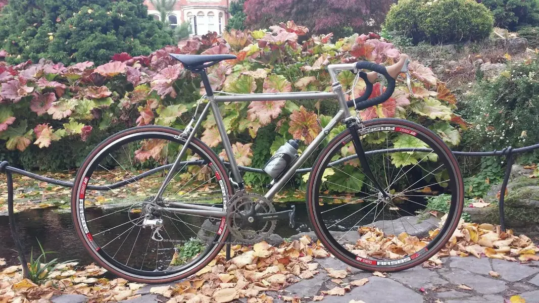

A few more pictures of the Ribble... hopefully the decals will arrive today... :)
