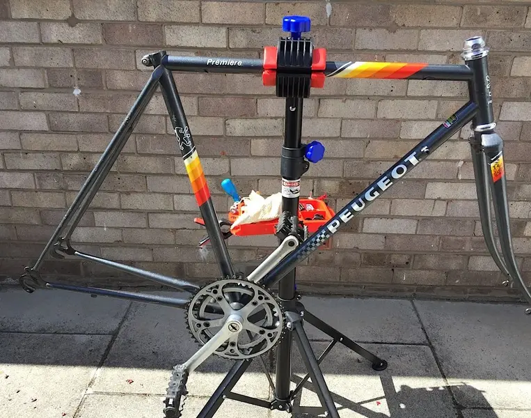

File comment: Wheels removed and ready for the bike rack.

After much thought I have decided to have the frame sand blasted and then powder coated in as near the original colour as possible then new decals applied. Only the cranks, BB, headset and cups still to remove. The derailleur, brakes and chain are all being cleaned with degeaser. The bearings, saddle, all cables, handlebar tape and brake blocks will be replaced. The handlebar stem wedge was badly rusted and seized, but with overnight penetrating oil applied and a bit of gentle persuasion with a rubber mallet and wood it came free and is now being cleaned ready to be reassembled.
More updates soon.
File comment: A bit more work before the respray.

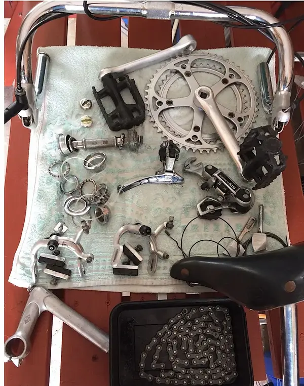

Headset,BB,cranks, cups and bearings races removed today. All in degreaser and waiting some fine rubbing. The frame is off to the powdercoaters in the morning. I will post some photos of before and after the work. Hopefully the rebuild will start at the end of next week.

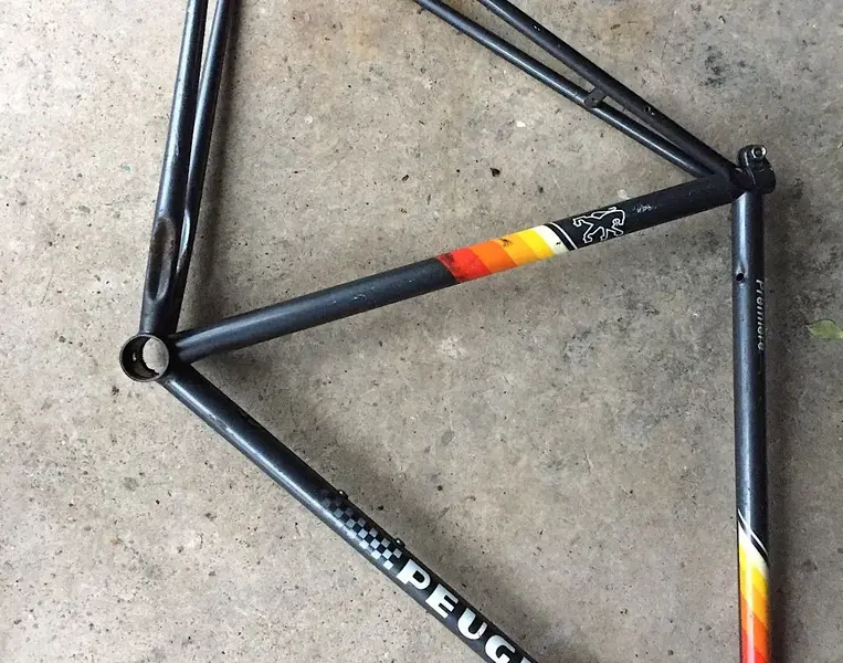

Frame gone to be powder coated.

File comment: Everything stripped and cleaned, grease and oil will be applied when rebuild starts.

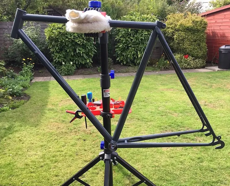

Delay in getting the frame back, only got it back this afternoon.
98% happy with the job. Small blemish on rear dropout and some powder coatings on the B.B. spline which I hope to remove with a little thinners tomorrow. Trouble locating the start thread! They masked the fork spline that is ok, but only plugged the B.B.
Will keep you informed as work progresses. Quite a good match to original colour. Frame and forks clear lacquered.
File comment: Frame ready to start rebuild.
