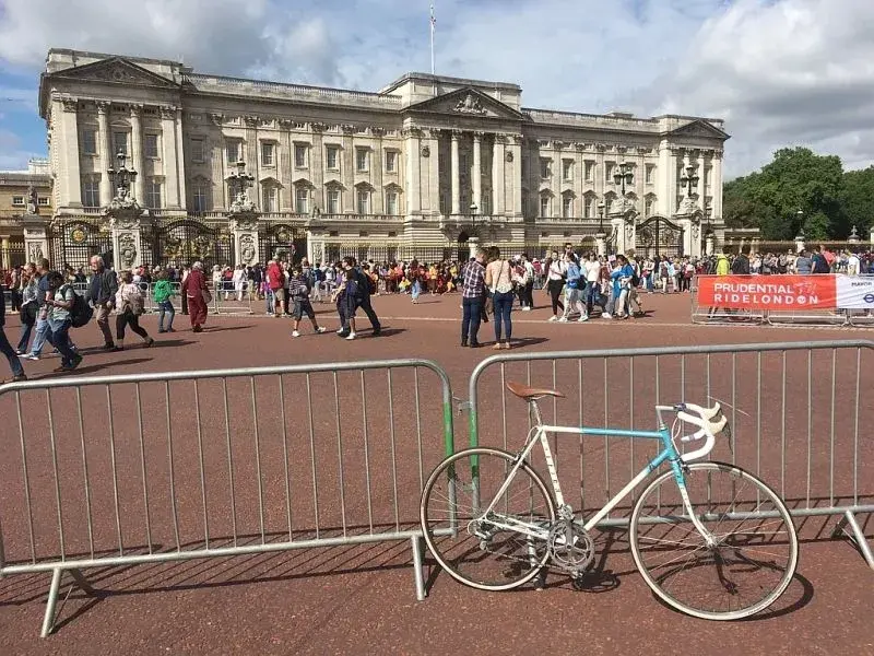

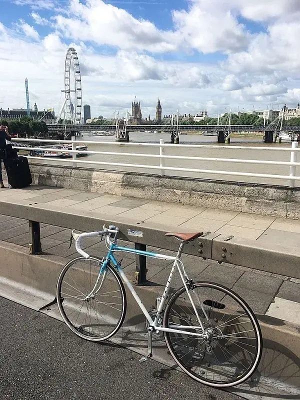

A little update.
I was forced to admit defeat on getting the rear hub open to service the bearings, so got it fixed - new cones and bearings - by a local bike shop, the wonderful Skinny Eric's Cycleworks in Hackney Wick.
It's also had new, modern, brake shoes and pads fitted because, well... being able to stop is good.
Since then it's been used more often than my Boardman CX, making the most of the good weather. It did 50km around the Ride London Freecycle with not a single creak or whimper and it felt very correct to be riding a proper British bike around all the 'iconic' landmarks.
