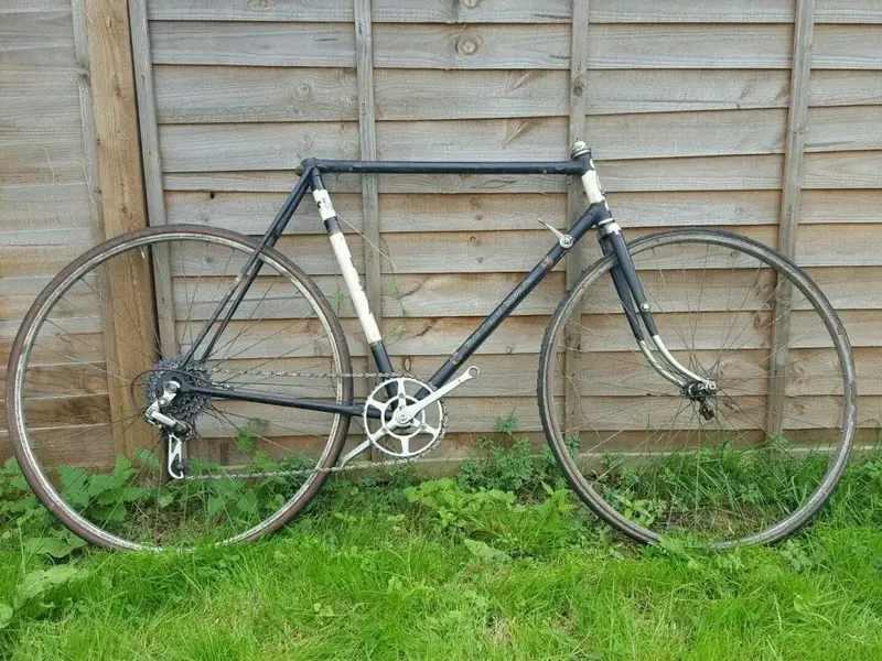

I've fancied a 1950's BSA for some time. I'm quite taken by the Tour of Britain model and have recently seen a couple of on here which have kind of spurred me on to find or build one. Okay, it's a factory bike, not artisan built, but I suppose I'm a BSA fan from my motorbike days, so with 531 tubing and good quality British made components, whats not to like? Anyway, I decided my preference is for a BSA Small Heath made bike, as opposed to the mid 1957 onwards Raleigh/BSA Coventry or Nottingham built jobs. Nothing against Raleigh, I have a couple and love them but this time I want a BSA made before Raleigh bought them out and used their name.
I started my search for a pre 1957 Tour of Britain with a frame size between 21" and 22". Little did I realise that time has marched on and while these bikes were once around in big numbers, I guess because they were relatively cheap, they don't seem to be anymore. Not that they are particularly sought after or worth much money, but I guess the passing of fifty to sixty years has taken it's toll and they're just not around anymore. Nothing came up as a complete bike in my search and after a while this is the best I could find, so I bought it on e-Bay. I'd describe it as a bit of a tired old boy that needs some loving (just like me!).
What to do with it? Well, hopefully the frame, forks, headset and maybe bottom bracket are re-useable after refurb. I'm really torn on a frameset re-paint but won't rush into it. On one hand I love originality and recognise that it only lasts until the first re-paint.. On the other hand, I hate doggy looking bikes so will see how the original paint comes up before deciding.
I think the frameset dates somewhere between 1954 and 1956? Pump pegs under the top tube and gear cable braze-on chain-stay make it different from the 1953 bike. The later 1957 bike has different paint and graphic! Any ideas anyone?

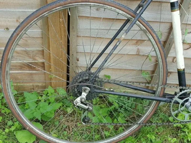

Anyone for Shimano MTB gearing? It's not staying on here..
To replace it I'm looking for a 53 Benelux derailleur and either a three, or four speed cyclo freewheel. I had thought a Mk.7 Benelux, but I don't think they came out until 1957, after my bike was made? I would like to stay with the original spec if I can. Does anyone know of parts for sale?

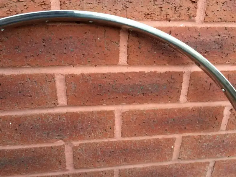

A bit of luck finding this hardly used 32 hole Dunlop Stainless Special Lightweight rim for my new front hub.
I need to have a measure up now to establish the spoke lengths.

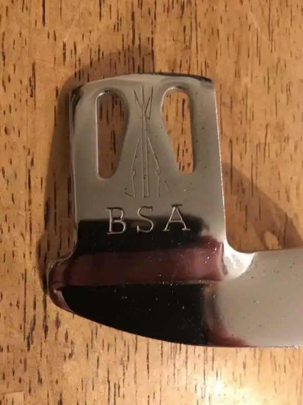

This might well be the wrong light bracket for my bike, but I couldn't resist it because it's logo'd (mug!)
Bruce or Mike, can I please ask you to confirm that the seat post diameter is 26.4mm. I want to buy one but am currently many miles from home so can't measure mine for the diameter. Many thanks.

Correct light bracket, mine is rusted to hell, but I won't be fitting it anyway.
That is a nice rim, they don't come up like that very often! I recommend Madgetts Cycles in Diss for your spokes and nipples. They have the proper 17/15 gauge spokes which are so much more elegant than the thicker modern spokes. I also used spoke washers because the steel hub flanges are thinner than alloy ones.

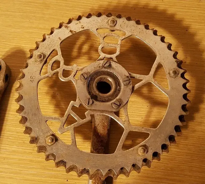

One of my buys is a half-step BSA chainset. I've never seen one for sale before and this monstrosity has had a hellish hard life. Absolutely nothing like yours Bruce. In fact I can't believe I paid money for it, it's that bad. Knackered small ring that I just know is going to cost a fortune to get lazer copied and overall, more chrome missing than still intact. I really must stop biding with a glass of red in my hand!!
Do you have the bottom bracket spindle dimensions for your half-step chainset Bruce? From what I can establish I think I'm going to be looking for something like a 135mm cottered spindle?

Can you post a picture of the knackered chainwheel? I have a spare one which I might be prepared to swap for a good cause. It has nearly all the chrome on the outside face, but not much on the inside, and the teeth are pretty worn. I am part-way through making a clock out of it, as I haven't got an outer ring to go with it.
As you can see, the teeth have more hooks than a cloakroom on the smaller chainwheel.
