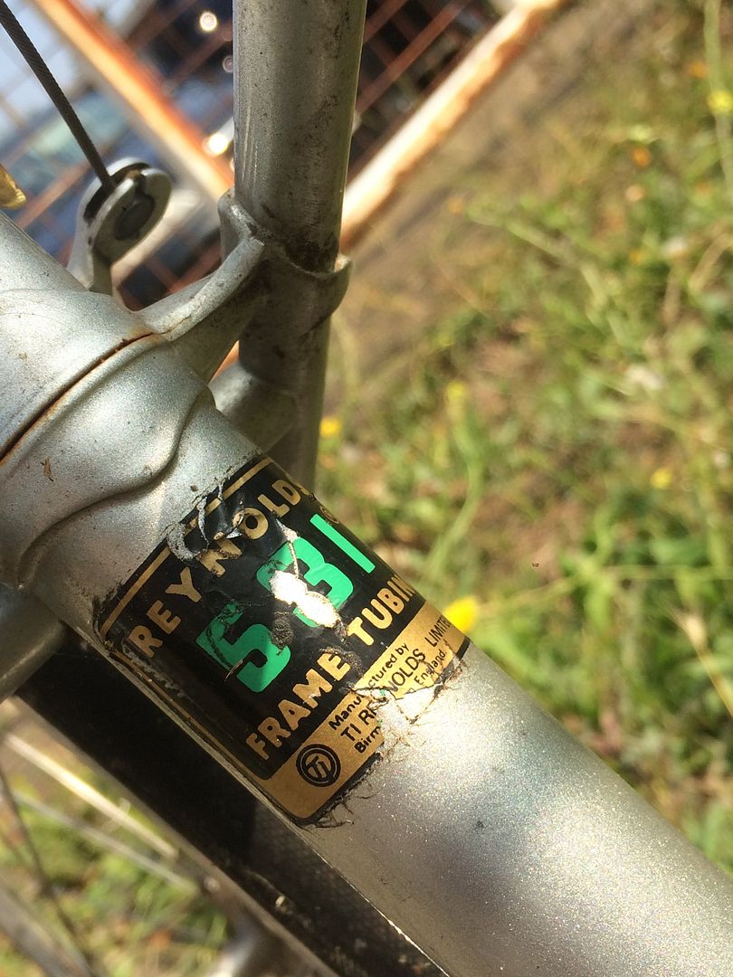

Flicking through Gumtree and an ad pops up for a "Cluad Butler bike" - bit of research via Google and from the 1 pic on the advert I could work out the 531 stickers and that it was a Majestique.

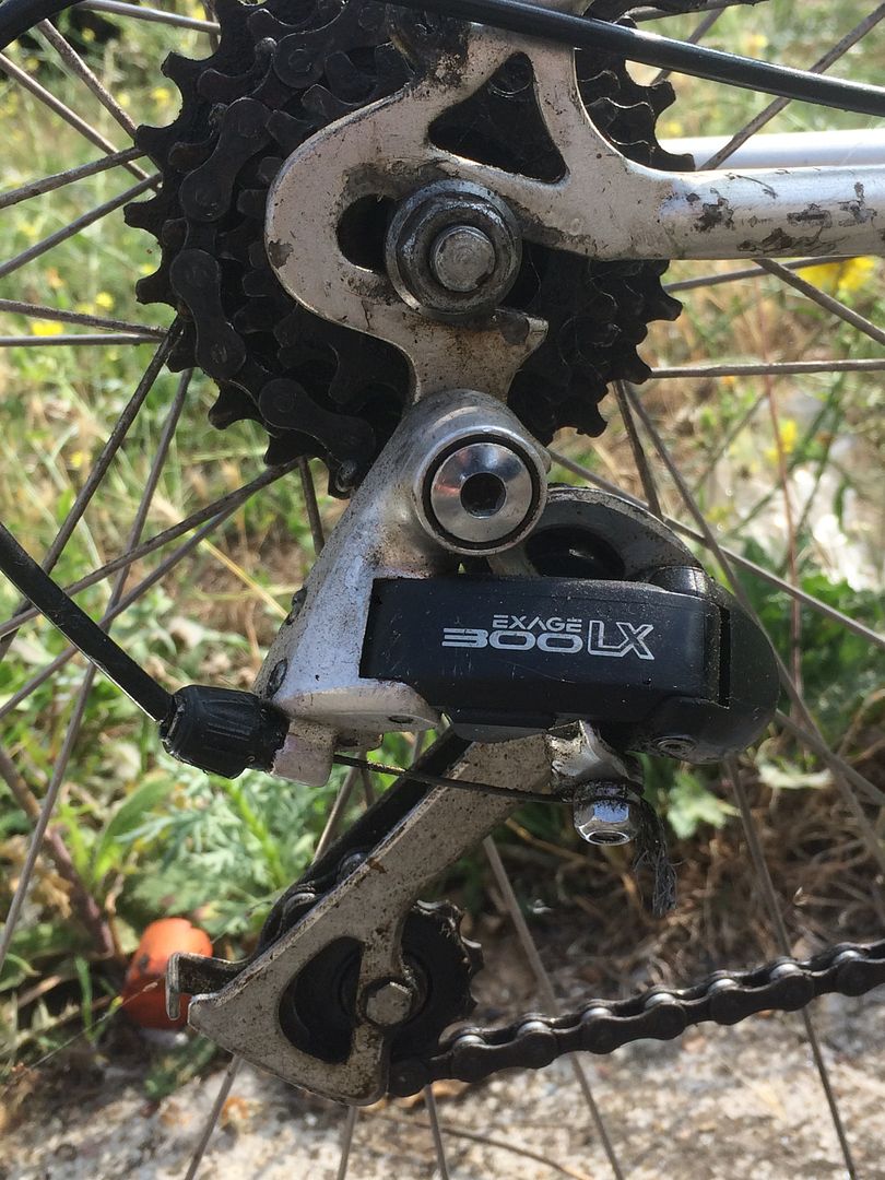

I'm desperate to find out what spec this bike had with regards to wheels/derailleurs/hubs etc. It currently runs crap thumbies on swept handle bars and Mountain LX/300LX mtb derailleurs - which will be the first things to swap out.

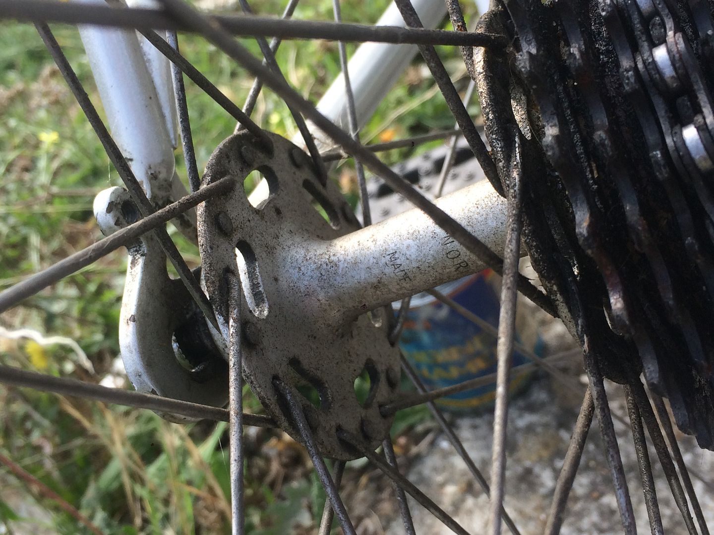

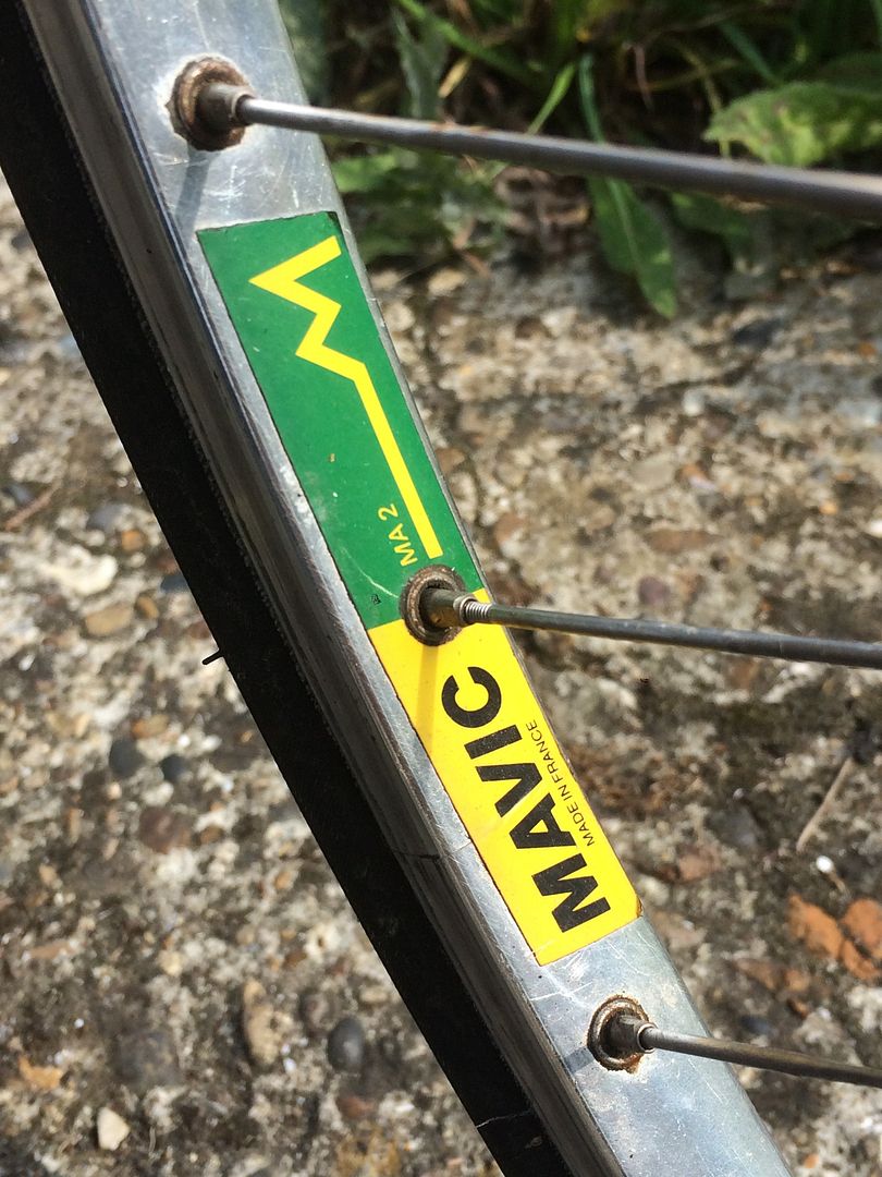

The wheels are a little odd too......both rims are Mavic MA2, but look too modern and show hardly any wear, and the rear hub is a Normandy large flange (nutted) an the front a "Sunshine" large flange with QR. Would it have originally run on 27" wheels - as these are 26"....?

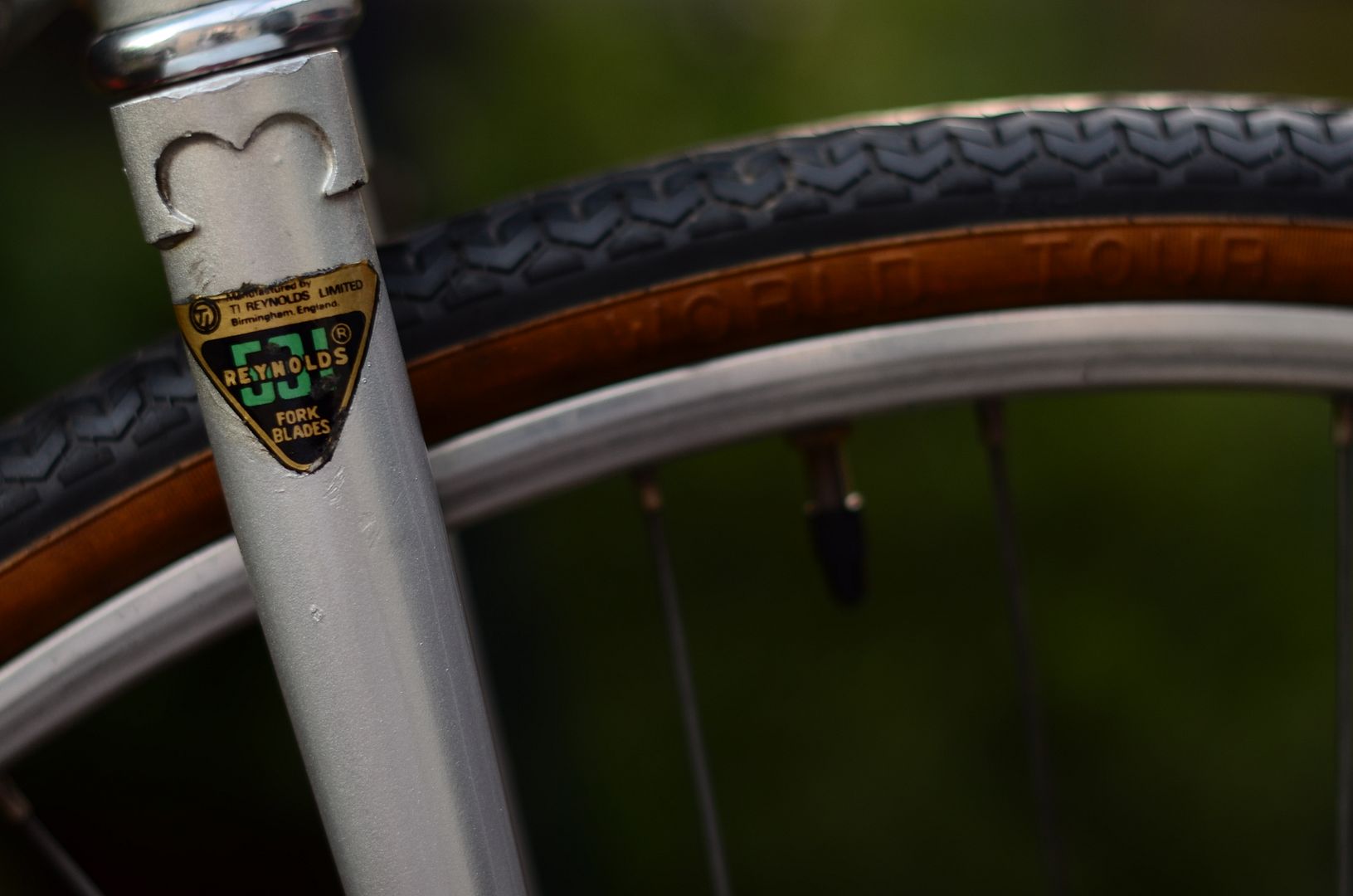

I would say yours is from 83 or 84 judging by the colour ("ice blue pearl) and the 531 decals (http://www.reynoldstechnology.biz/wp-co ... istory.pdf).
the spec for the '84 model is here:

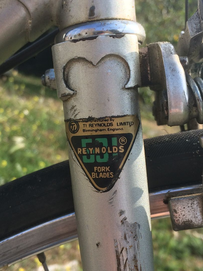

I thought it was this year initially, the Reynolds decal suggests '77-'82 (from this website at least)

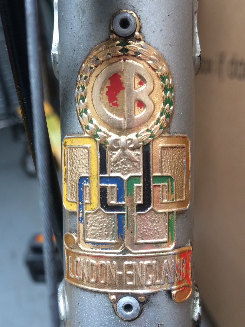

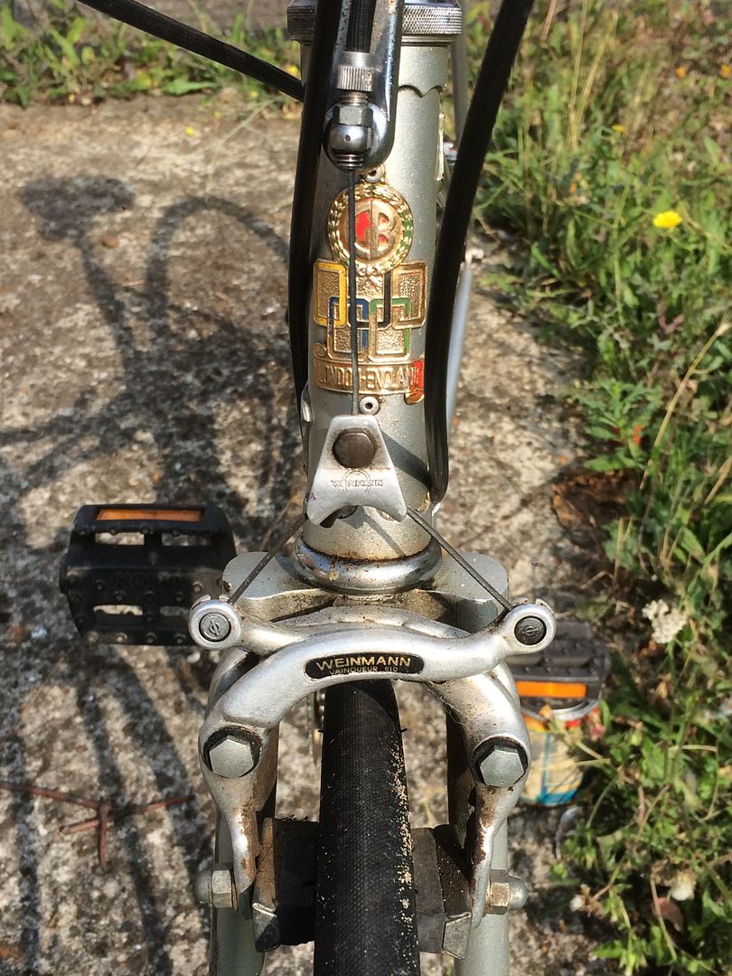

The only thing which makes me think it's earlier is that is has a rivet on head badge rather than a decal

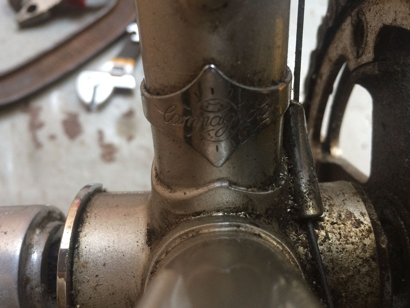

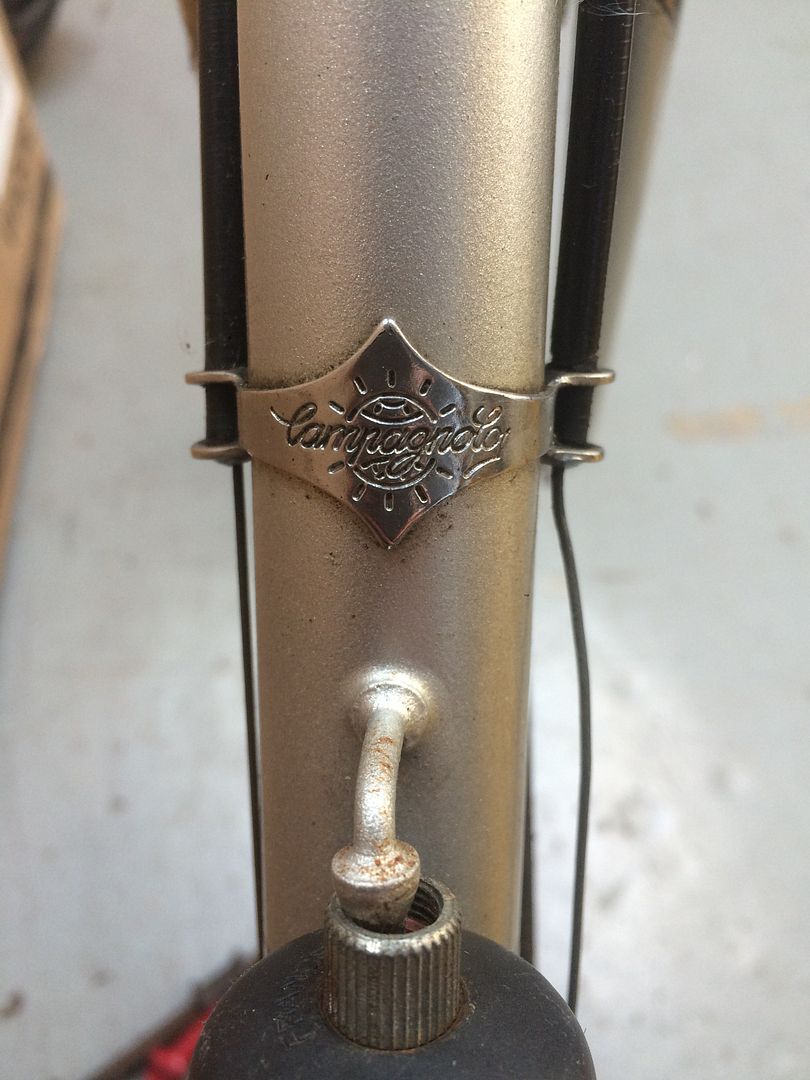

.......and it has campag clamp on cable guides and I can make out the 'olo' of campagnolo on the rear drop outs.
'84 catalogue also suggests a lamp mount boss on the front fork - which mine doesn't have.

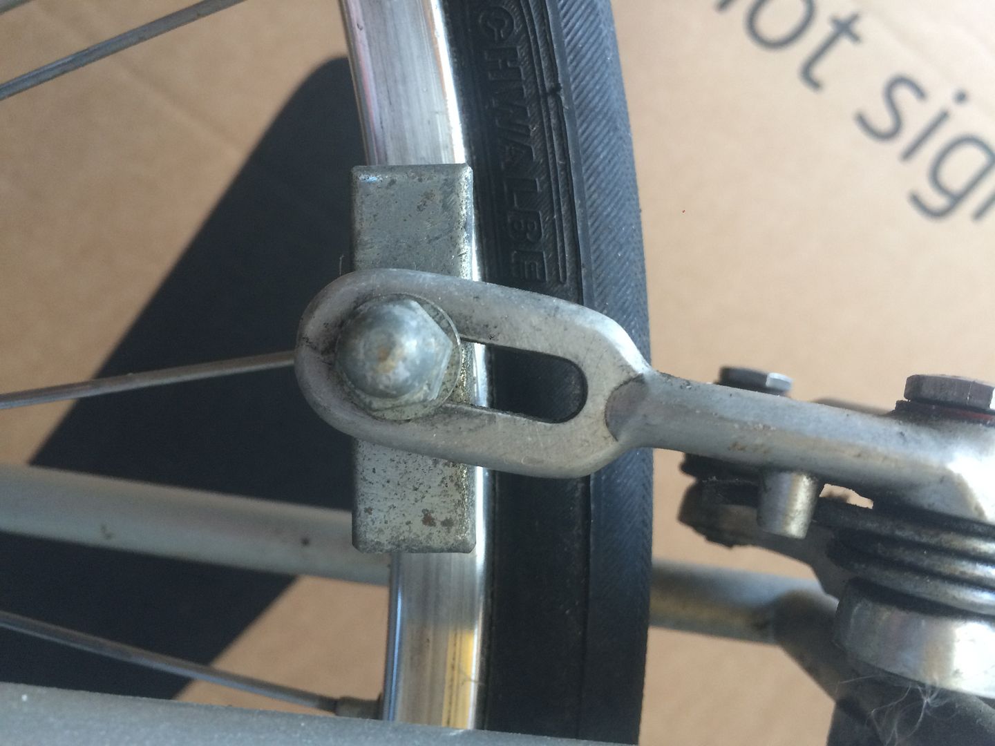

Also - my thoughts of whether it originally wore 27" rims is down to the position of the brake blocks - right at the lowest position they can be....
Ah, I'd spotted the Campagnolo drop-outs but not the lack of lamp boss and the proper head badge. So it Looks like it's a 77-8 model. All the later models have a lamp boss. There's a referbed Majestique somewhere on retrobike where the owner suggest CB swapped to a decal head badge sometime in early 78.
The 'Majestique' decal on the chain stay threw me off as i thought the had started with a script font and changed to the crown style later.

I got given a spare set of 27" rims from the guy I bought it off (as I was leaving he said "d'ya want these?"). Not sure they're the originals, he said they were off a Dawes racer he'd stripped. The front wheel is a chrome rim and properly corroded but the rear is alu rim, sunrace freewheel and is like new (aside from being filthy). No wear on the rim, hub bearings are perfect and sprockets look like they've not seen a chain. Turns out that the freewheel on the 26" wheel fitted to the bike is goosed anyway so I've fitted the 27" rear and am now on the lookout for a 27" front wheel to match.

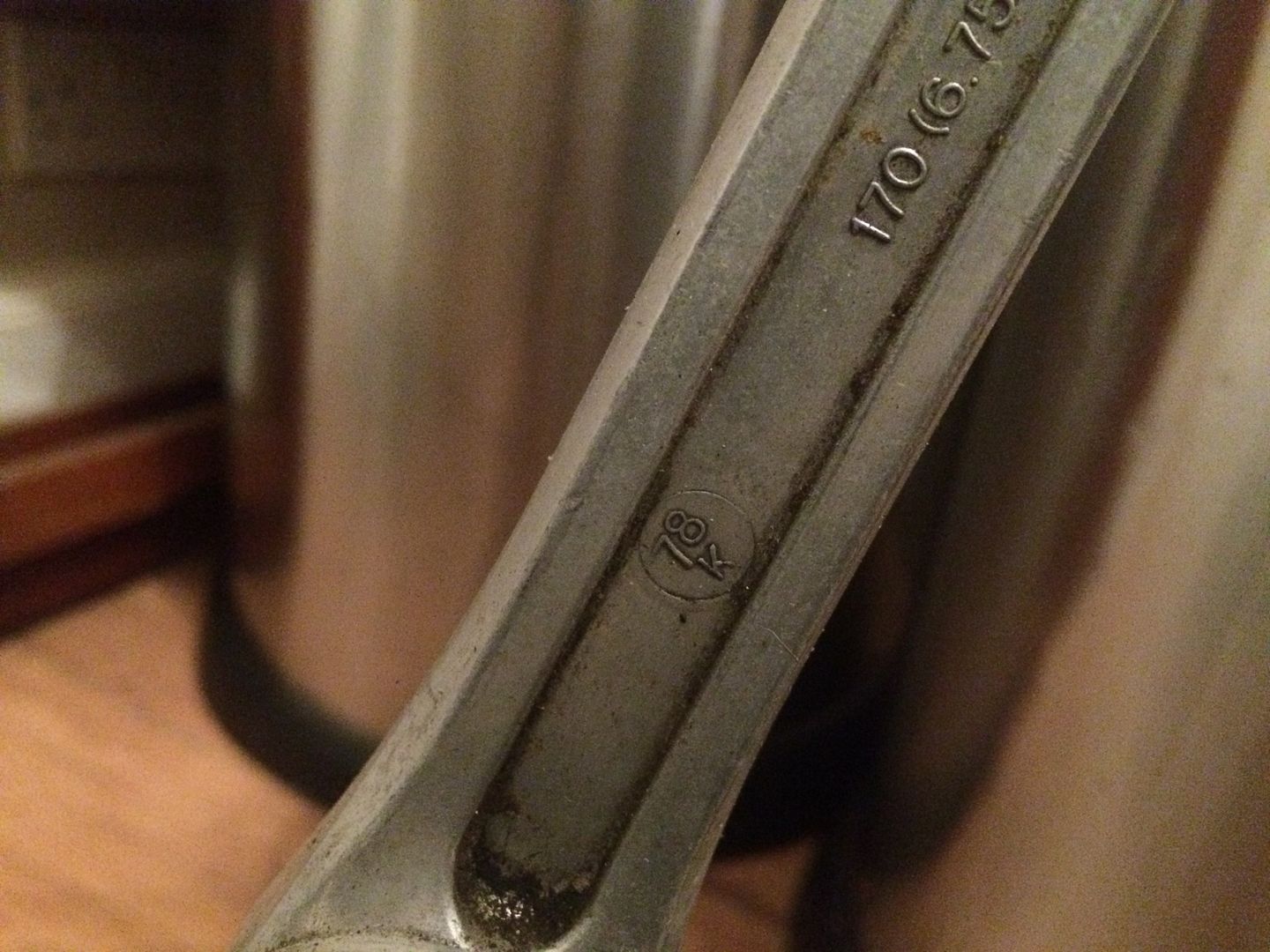

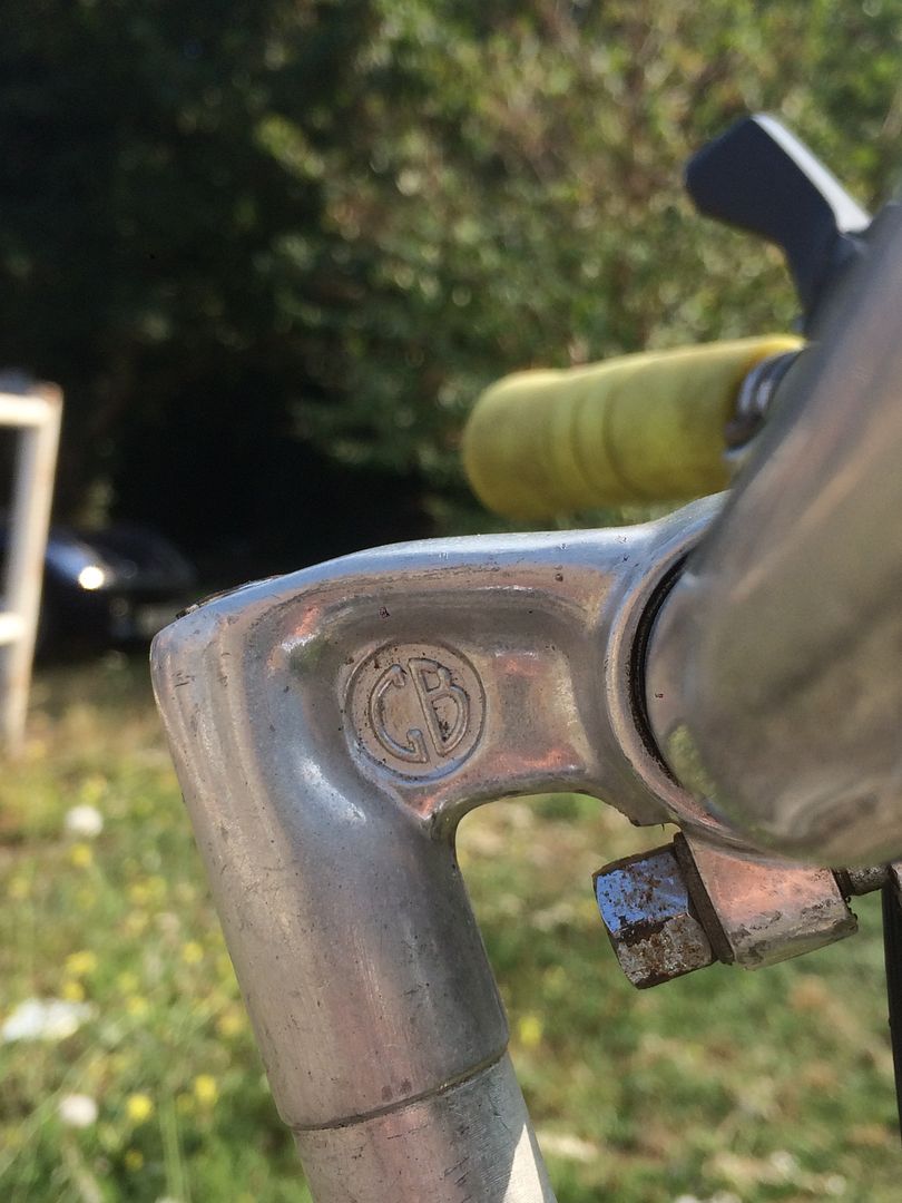

Oh,and they'll probably be some type of data stamp on the weinmann's or the cranks.
Cool - thanks for that info - will have a scout around for numbers later. Presumably the frame will have a number too - can you date Claud Butler bikes from the frame serial number?
Not sure how to decode CB frame numbers but I’m sure someone on here will. …although I have a vague memory of reading that they get confusing in the 70s and 80s…?

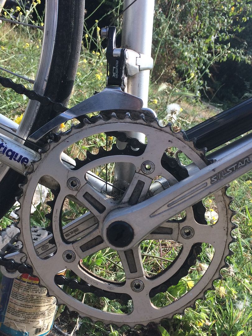

According to the My Ten Speed site -http://www.mytenspeeds.com/My_TenSpeeds_1/FREE_SITE_VINTAGE/VINTAGE_5_Component_Numbers.htm - the brake calipers should have a month and year code on the back inside a circle of numbers and the crank should have a two-digit year inside a regular circle.
Yep, that was the refurb I was thinking off - looks a lot like yours down the cable guide and the lack of lamb boss. The owner of that CB still seems to be active on here so might be able to help. Squinting very hard it looks like that has a Huret front mech as mentioned in the ’77 catalogue. Further squinting on Velobase and http://www.disraeligears.co.uk/Site/Hur ... 90%29.html suggest that
that it could be Huret Eco?

Good info right there! Had a quick look at the cranks tonight and they have a 78 inside a circle.....

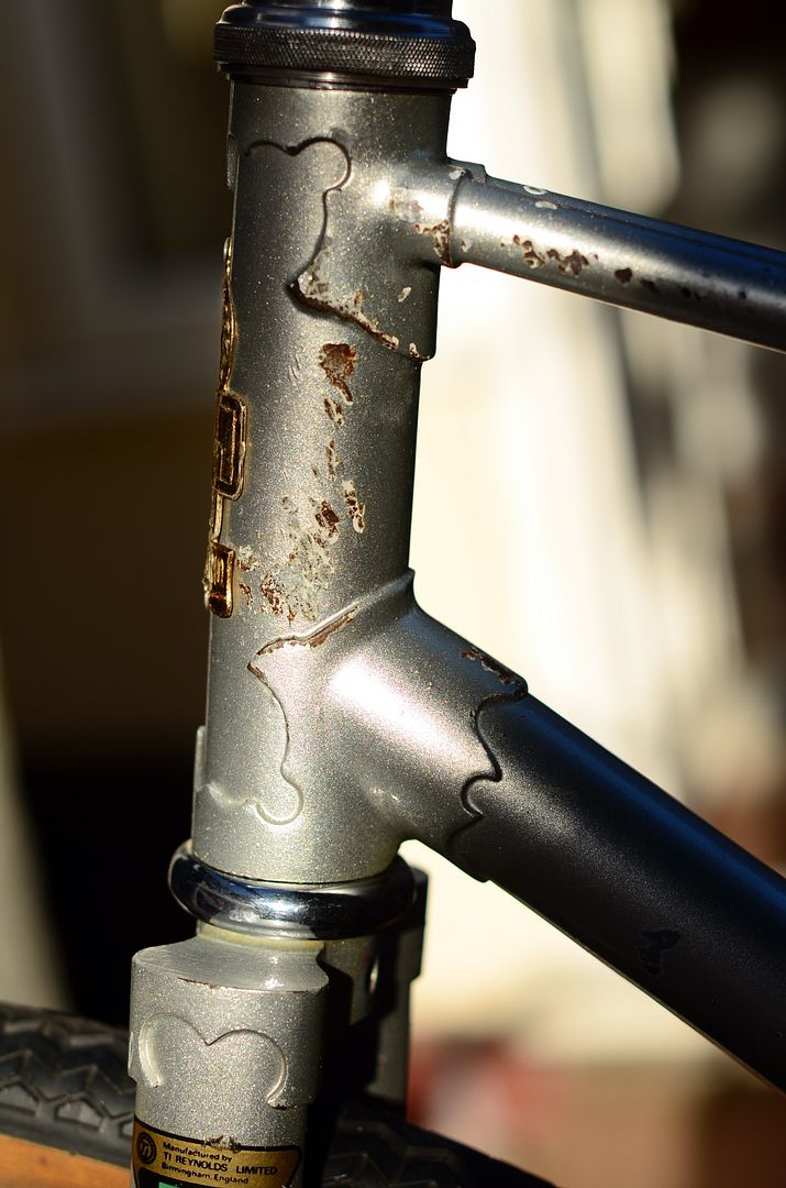

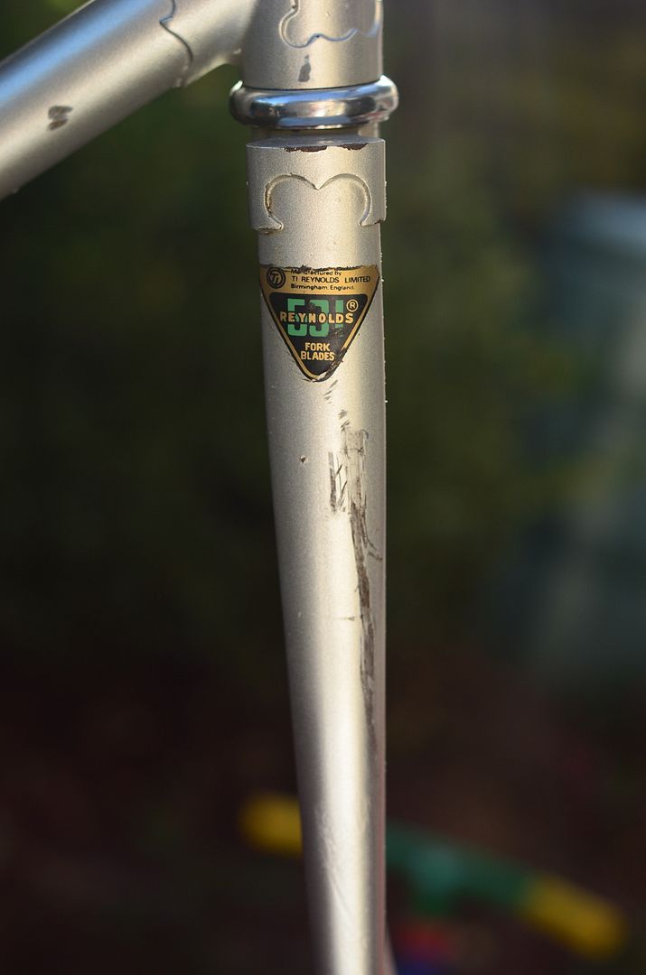

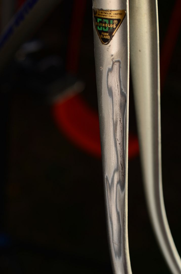

Frame paint is not bad but there are a couple of nasty scrapes which have been bugging me. I don't really want to completely respray/refinish the frame before rebuilding.....so I decided to try out some silver automotive wheel paint that I have left over in my paint collection. Using zinc-rich primer as a base it turns out to be a damn good match!
Fork scuff:
Rubbed back:
Painted:
Lacquered:

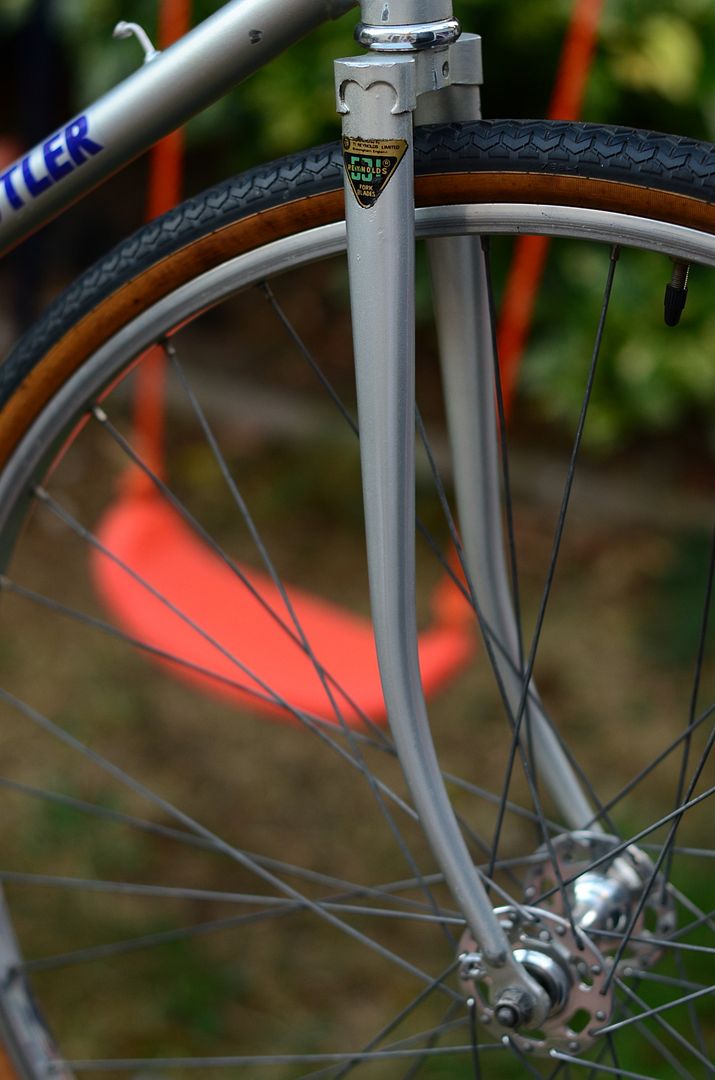

New (old) 27" front wheel courtesy of forum member Oaklec (cheers Chris!), a slightly longer stem in preparation for the swept back North Road style bars that should turn up next week.
Next up - to sort out the paint damage on the head tube in the same manner:
