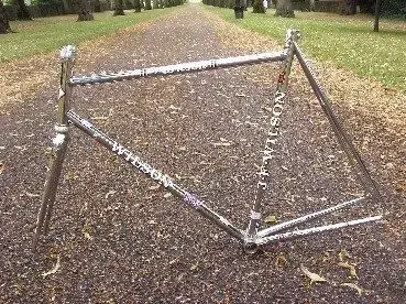

Can anybody shed some light on this frame style? Roberts
The History Man
BoTM Winner
rBotM Winner
Overbury's Fan
Been wondering why the extended seat and head tubes rather than just raising top tube. Was thinking tall chap with short legs but short reach. Puzzled.
Any insights would be great. Thanks THM
Hi its to make larger frames less gate like making them easier to handle and hence quicker of the spot (esp advantageous for criterium racing)

That just about sums it up :). The trend from the mid 70's to ride smaller and smaller sized frames until today it looks like they have nicked a kids bike lol
Shaun
Also must make the front end stiffer, as the steel headtube shouldn't flex as much as a raised stem.
