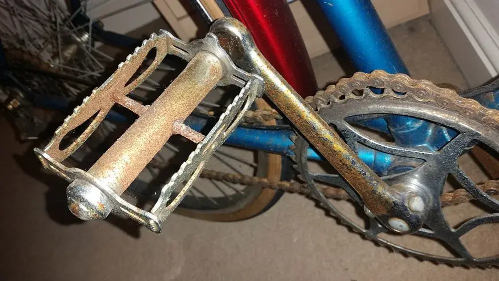

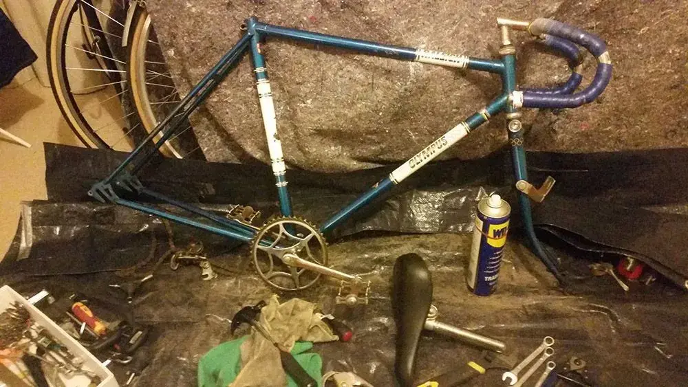

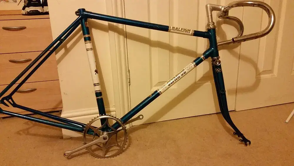

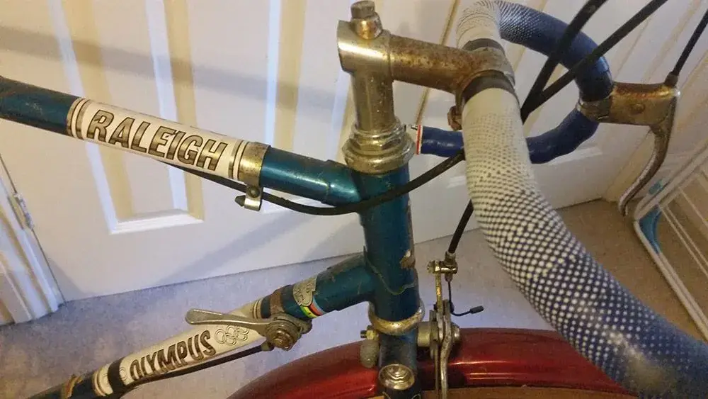

Restoring this for a relative after sitting in his garage for the last 30 years and then falling off it when he took it for a spin around the block. He then decided to ask me if I could restore it to somewhere near it's original state - as in the Raleigh ad attached.
It would have been the cheap end of the racing bike market I think, it's certainly not going to win any prizes at L'eroica, but it's a nice little project and I just happen to have a load of spares in boxes which will fit a treat. Had to have the LBS saw off the cranks though, the cotter pins were rusted solid and the brakes are shot to hell - which may explain why he fell off!

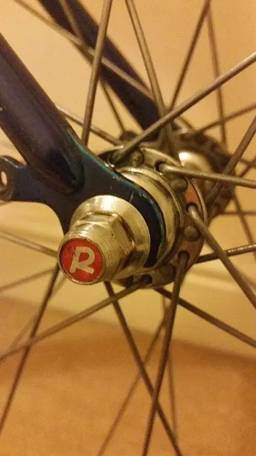

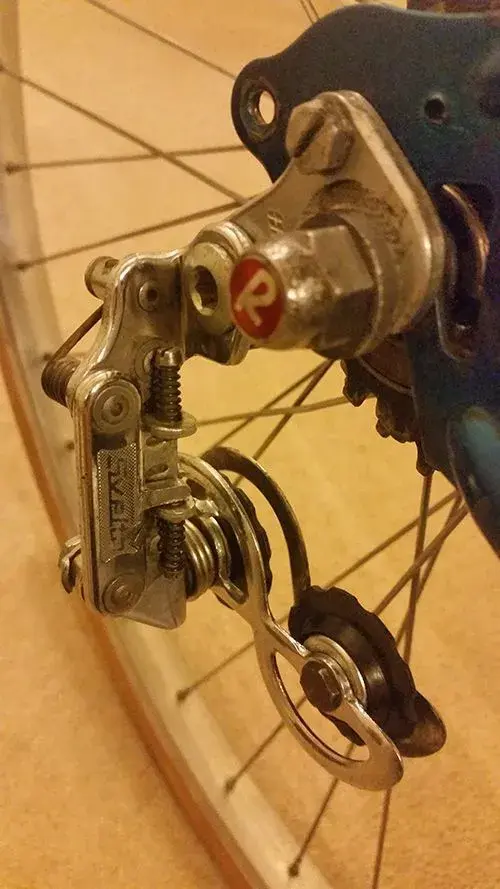

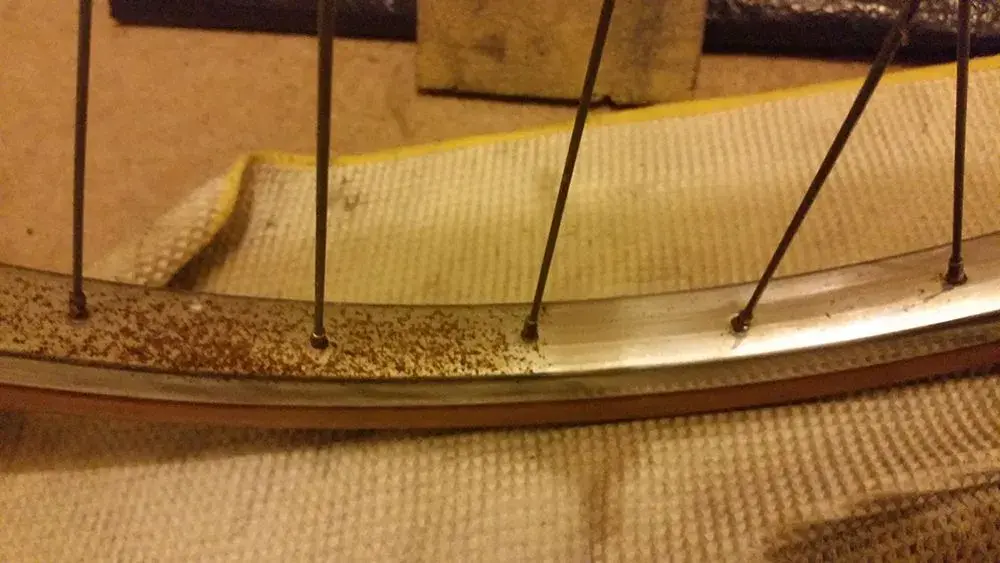

The Olympus coming along nicely, after lots of Xmas free time.
Mostly involved lots and lots and lots of scrubbing away rust with Coke and Tinfoil - amazing stuff, I thought the brake calipers were too far gone but they've come up as good as new. The original headset was seized though and I've replaced with a reasonably old-school looking headset and stem, which aren't exactly period but made do from parts available. Levers, calipers, rims, hubs (and spokes) all scrubbed and polished. Just need to get it all back together now. Replaced the derailleur with a nicely scrubbed up Svelto and found the correct cranks and BB to match original. Just need to wire up the gears and brakes, and bang on some bar tape and should be almost ready to rock.
