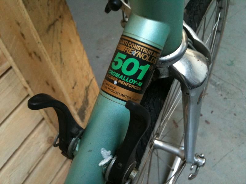

I gave it a quick look over last night, adjusted the seat position and dropped the stem a little (as it was extended past the max line) and naively decided to ride it into work this morning without really giving it a proper once over.

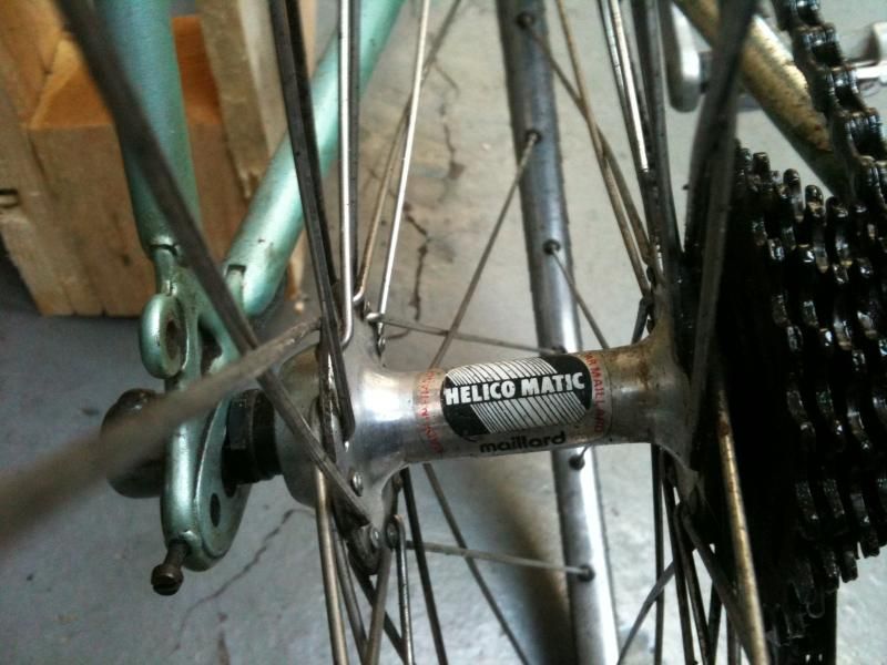

A mixed bag! Lovely bike to ride, and finally a bike that actually fits me! However about 2/3 of the way to work the rear end started making some nasty clonking clanking noises....worse when pedalling but still present when free-wheeling.
I made it to work only to find that the rear hub was missing a locknut on one side!! The outer bearing cone on the RHS had gradually started to unscrew itself......
Closer inspection shows that the other cone is quite pitted to so I think someone has been tinkering and has either forgotten to fit the locknut or lost it/not realised how important it is.
Aside from that she's a lovely old gate.....I know nothing about road bikes, let alone Peugeots from this era so any tips/advise on owning one of these racers is very much appreciated! There's plenty of tweaking and setting up to do (notice the brake block position as an example)! Anyway - it's a train ride home for me tonight.....but I can't wait to get it fixed and get back on it.
Quick (crap) iPhone pics from this morning:

Lovely bike, rather like an old peugeot myself. Are you sure its the rear hub and not the free wheel ? Those mailard ones tend to loose their locking ring and then slide about.
Re: First time Roadie.....1985(?) Peugeot PH501(?)
Cheers! I'm loving it - it's certainly got potential.....
Freewheel looks OK (need a special tool to remove if my research is correct - one with a built in bottle opener?) - it's just missing a lock nut on the drive side.
The adjustable cones look a bit poo....they are quite pitted, which means I'll be throwing them away. I've read that the bearings are smaller than most due to the design of the hub and there are no replacements for these cones. I've also seen statements to suggest that the helicomatic freewheel/hub is a great idea on paper but isn't actually that good in reality, and that they're best to be replaced rather than used......which is all very debatable or course!
Anyway I've maybe got a replacement on the cards thanks to a friend & retrobike member SIMONFREESE - and if that doesn't workI've got a spare 700c rear Mavic MA2/Shimano 105 wheel which could go on.

I had a dig around in sherly's bike emporium (aka the man cave) last night and robbed a locknut off a spare 700c wheel that I have. I stripped the hub down, cleaned out the sludge/swarf(!), flushed out with liberal amounts of GT85 and then reassembled with fresh grease/new locknut. It's borderline graunchy (certainly not buttery smooth) but is usable for the time being. Be interested if you find the wheels as spares - let me know what you want for them or if you need anything as swaps.

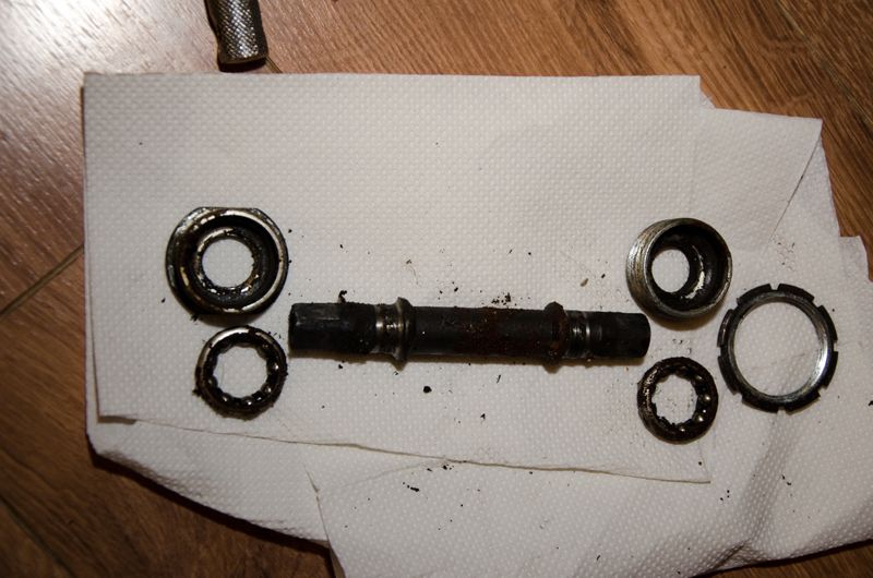

Swapped the saddle over for a Flite Titanium too while I was there. No tyres as yet today - hopefully tomorrow as the current ones are a little past their best.......and the bottom bracket has a lot of play in it too. This needs investigation - hoping a stripdown, regrease, adjustment will cure.

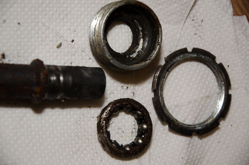

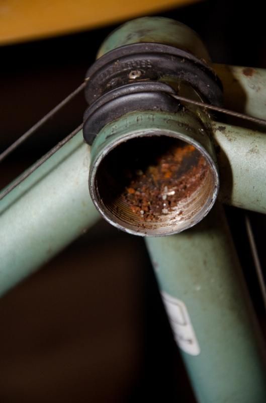

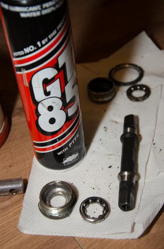

Job done last night - stripped the bottom bracket out, cleaned out the crud/dead grease/rust, re-greased and re-assembled.
How smooth should these cup-cone adjustable bottom brackets be?
I played with it a bit last night and couldn't get it buttery smooth without a little bit of play. Presumably because it's worn? I've not adjusted many of these so I'm not sure what is achievable. I think I'll eventually put a sealed cartridge in for convenience.....
