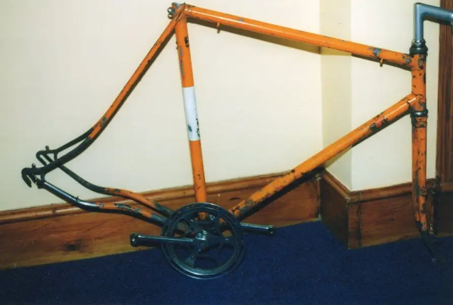

My father-in-law gave his winter bike to me at the tail-end of the last century when he decided to stop the twelve mile cycle commute to work near Tewkesbury. He acquired it from another member of the Cheltenham club he was in at the time as a project. It was in a bit of a state, the paint was no-longer original and now a home-applied flaking dirty orange. None of the components were original, these had gone before my father-in-law bought it. Some of the small brazings had snapped off and the head-tube badge was missing. The frame was basically sound but in serious need of a re-spray.
I took up the project baton and started riding it to work while I planned what to do and saved up the money. Unfortunately the rear right drop-out snapped somewhere round Bracknell, slightly forward of the serial number. The frame went into the attic while I mithered over what to do.

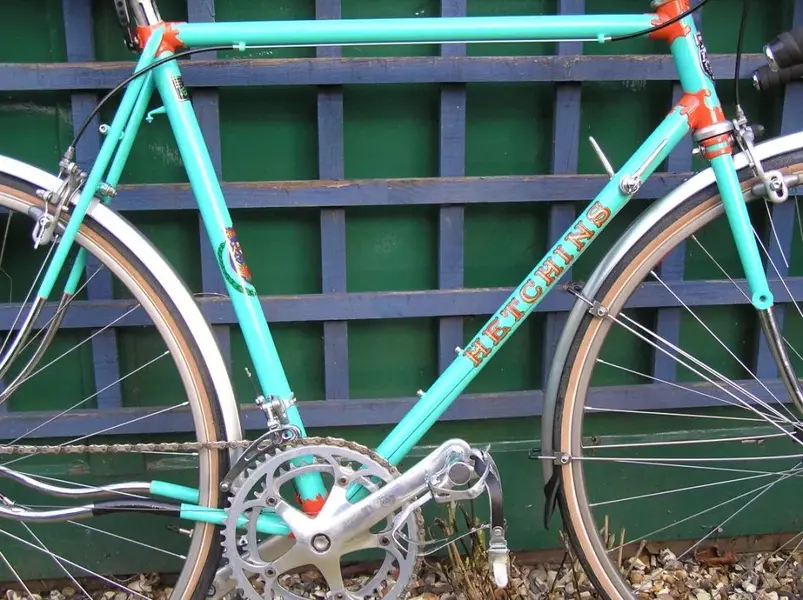

Talking to a few riders at work inspired me to get things moving again. I started to get hold of some useful components from friends and found out about places like campyoldy, hetchins and H Lloyd Cycles. After speaking to people like Len at the Hetchins Register, Ricky at AW Cycles in Reading and folk at Bob Jackson's I drew up a plan based around the concept of refurbishing a vintage frame to make a rideable machine that would still look good. From Len I found that The bike was sold wholesale to Hamlyn Cycles, Cheltenham in 1954 for £13. 6s. – a discount of approximately 20% on the retail price. I didn’t have an unlimited budget and was daunted by the prospect of digging round in cycle jumbles for bits of Chater-Lea for the next ten years or so. I would fit what vintage gear I had and grub around for other components, replacing with vintage piece-by-piece. I bought as close as I could get to replica period transfers and an unpainted brass replica cast of the Mazak original head-tube badge from H Lloyd’s (chromed locally). Note – replica slightly smaller than original (1mm smaller rivet spacing) and with less definition due to copying process.
The frame was sent to Bob Jackson’s to do the following: replace rear dropouts and re-stamp the serial no. (I still have the original); add new front mech lever braze and matching LHS cable tunnel over the BB; add 1 pair of bottle-cage brazed to the down tube; repair the pump braze at the back of the seat tube; add new rear carrier brazes to the seat stays; half-chrome the forks and stays; attach transfers; paint and attach head-tube badge; respray frame in peppermint enamel with lugs picked out in orange enamel. The orange gives me a tiny thread of continuity to the colour I received the frame in. I chose enamels as Vade Mecum, while a true lightweight model, was never high-end and I didn’t feel like over-egging the pudding.

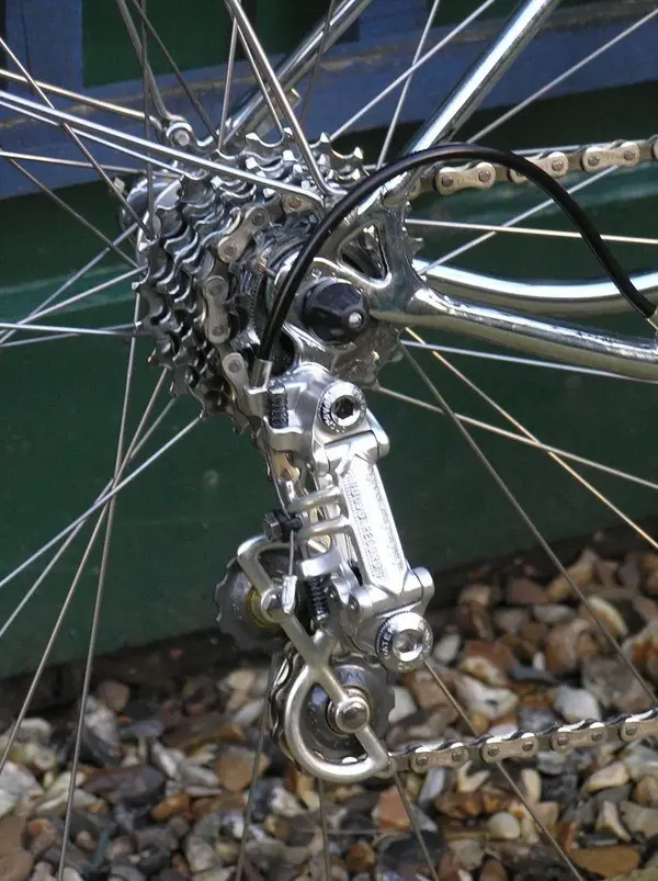

Front/rear mech + levers: Campag Nuovo Record from Campyoldy.

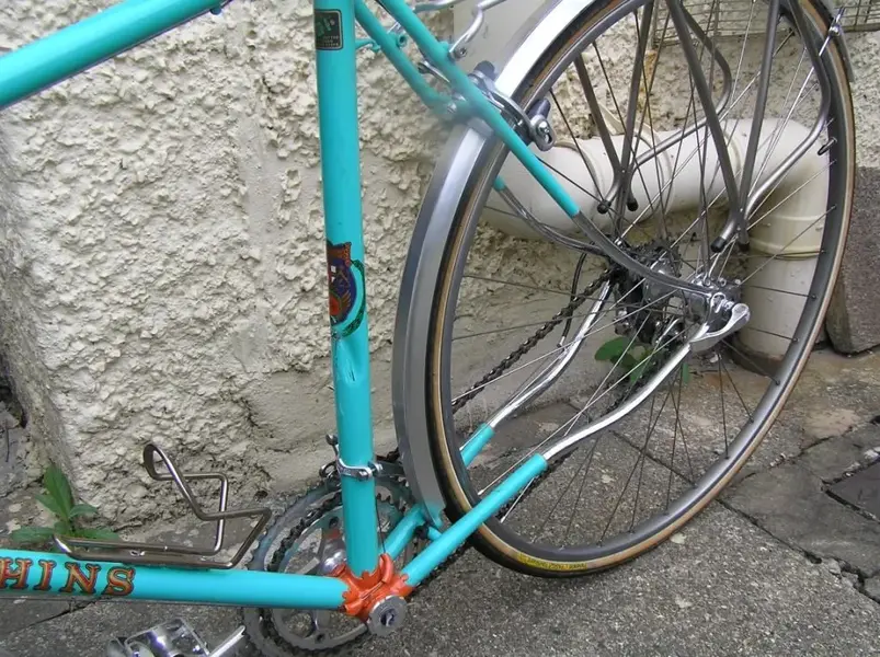

There were some disappointments. I asked Bob Jackson’s to fit me a H/S and didn’t talk to them about it, it came back with a rather out-of-keeping Shimano 105, still it matched the anodized-grey 3TTT stem that I’d found locally. The new LHS cable tunnel was a bit more obtrusive than the original RHS one, a shame since Jackson’s were the licensed Hetchins Builders round that time. It became obvious it had been a struggle to fit the head-tube badge as when it fell off about six months later it was clear it was only partially riveted. I still struggle with the decision to spoil the line of the seat stays with carrier brazes but have found time and again their usefulness in allowing me to get from place to place unencumbered by rucksacks. No matter how much I tightened the mech levers they only seemed to give friction for short periods of time. The gear-cable line was poor, I should have had a cable runner put under the BB and moved the chainstay cable stop under the tube.

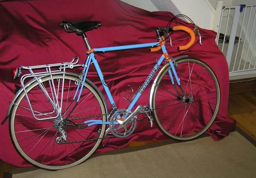

Fortunately the driver stopped. With liability sorted out, Ricky at AW Cycles organised a second refurbishment/repair for me. We settled on Argos. The frame came back better than before in pastel blue enamel #32 and tango orange enamel #77. Full credit to Argos, their respray was much better quality than the original – a much smoother paint job. The lugs are now lined in white (admittedly not requested first time round) and the head-tube badge has stayed on (magic?). I got hold of some Campag (C Record I think) levers and hoods to replace the Weinmanns and am sticking with the gum hoods until they rot off – they seemed harder to get hold of a few years ago but I think there are more around now, perhaps replicas? Ricky at AW generously swapped my Campag Nuovo Record levers for some beautiful Simplex Retrofriction braze-on levers. They fit the frame bosses better, give amazingly smooth shifting and do not need constant tightening – Thanks Ricky! The crying shame here is that the seat tube was unrepairable, it’s now 853! I could either whine on about how it’s not a Hetchins anymore and chuck it in a skip, or get it sorted and keep it on the road for the pleasure of the ride. Old is the new new after all, perhaps in this case new really is the new old?
