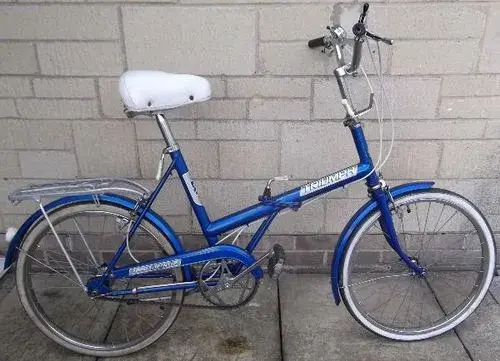

I guess here is the best place to put this. Raleigh Twenties certainly weren't for offroad use, so they're not a BMX or an MTB. They were intended for use on roads, so I reckon that makes them road bikes! :)
This all started with an idea last autumn. It was looking like another windy winter, which I just can't be bothered with on a 16 mile commute. That meant having to use the sodding trains, and waiting around a lot for them. The previous year, I'd tried taking my bike on the train, so I could cycle to the station and get an earlier train, but when it got crowded I'd often find myself unable to get on. :|
The solution? A folding bike! Decent folders were expensive, though, and cheap folders were crappy and embarrassing. That's if it was cheap and modern-ish. There was a crappy option that was cheap but quirky enough to not be embarrassing, and everyone's favourite bike tinkerer was a big fan of them: a Raleigh Twenty!
So, I ended up with this:
Which soon became this:
The plan was simple: fit BMX-sized wheels, put on a good seat, and upgrade the headset. I expected obstacles, and it's a good job I did - there were many! :p
