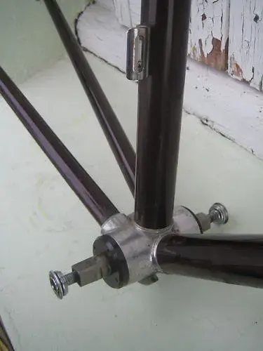

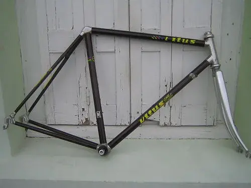

Quick question, here are a couple of pictures from when I purchased the frame earlier this year. The frame has a "braze on" type front mech holder that can be removed easily so I can fit my "band on" front mech. Im guessing that there isnt any issues doing that unless I vastly over tighten it? Should get down to some wet and dry sanding this weekend
