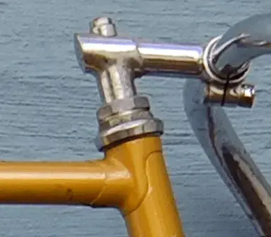

I know it's gold 'n all, but it looks remarkably like my track bike which is a Russian Спорт XB3:
Fork crown detail (I drilled mine for a brake):
The giveaway would be the Russian size 26mm steerer and bottom bracket with right-handed threads on both sides.

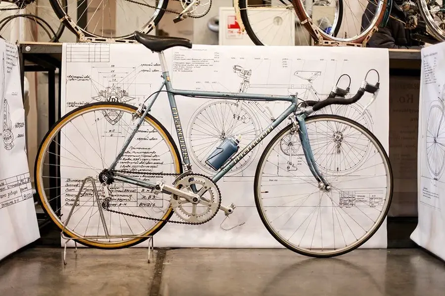

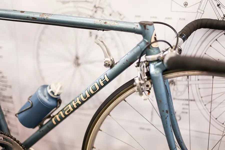

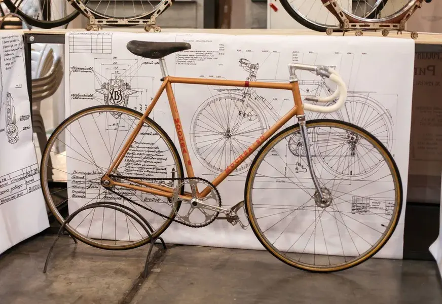

СПОРТ was made by ХВЗ (Kharkov cycle factory).
ТАХИОН is a product of (ЦКТБ Вело) which was also located in Kharkov.
Some pictures of production (ЦКТБ Вело):
Moscow-80 (7,5 kg, Cr-Mo frame, parts made from aluminium and titanium)
Tahion with original parts.
