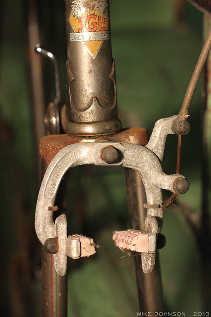

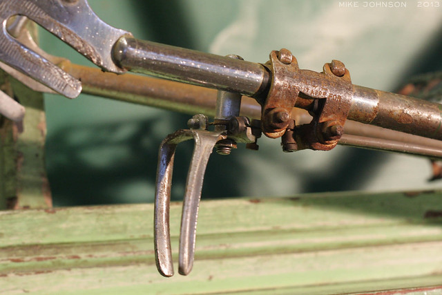

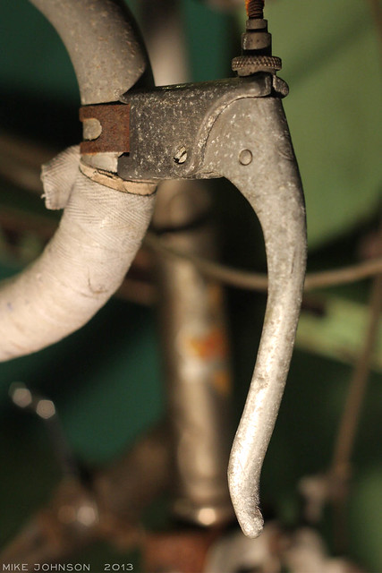

Brakes and levers - GB Hidunimium
GB Hiduminium brakes by zombikombi1959, on Flickr
GB brake Hiduminium levers by zombikombi1959, on Flickr

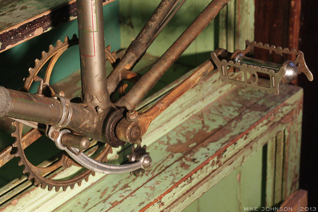

Pedals - Chater-Lea, with the Tommy Bar hole 1939>
http://www.classiclightweights.co.uk/chaterpedals.html
IMG_5313 by zombikombi1959, on Flickr

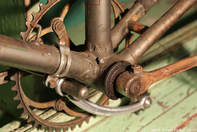

Chainset and cranks - Durax Supercourse. The pedals and cranks all turn smoothly, so hoping the bearings and surfaces are good, but the chrome is in a very poor state. Lovely fluted cranks.
Durax Supercourse chainset by zombikombi1959, on Flickr
Jim Guard bottom bracket by zombikombi1959, on Flickr

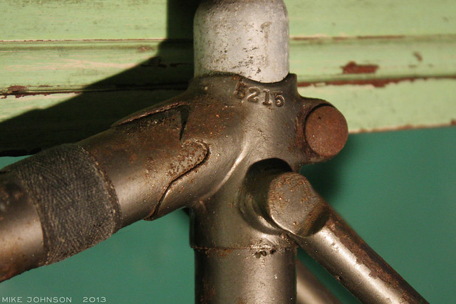

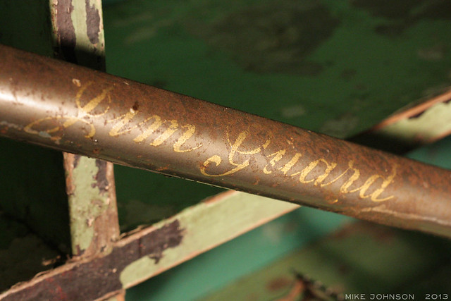

And the frame? Looks to me to be all original paint, box lining and transfers to me, with chrome for ends and dropouts. Pretty tired. I'm not sure what the feeling is towards preserving original paint here ... One mans Patina is anothers Cancer ... Well, I just think you need to check out the kombi to see what side of that fence I am on ...
Loch Linnhe Lunch Stop by zombikombi1959, on Flick
I have been told Jim had his frames built by a North London builder. The guys over on CR googlegroups had ideas but nothing confirmed yet.
Any tips on preserving and restoring the paint and chrome appreciated. I've been reading about the benefits of linseed oil on here and the LFGSS forum.
Jim Guard down tube transfer. by zombikombi1959, on Flickr
Chrome for ends by zombikombi1959, on Flickr
Jim Guard by zombikombi1959, on Flickr
Jim Guard frame number by zombikombi1959, on Flickr

but has very fine , coloured detailed lines, would they be coach painted it would be fascinating to see you try and restore it on the cheap and try all those techniques mentioned. failing those a complete shot blast re chrome repaint cause it deserves it! .i would like to know where you can get transfers like that duplicated and ok to laquer over .
the head tube badge is amazing and actually has 'southampton' written on it !

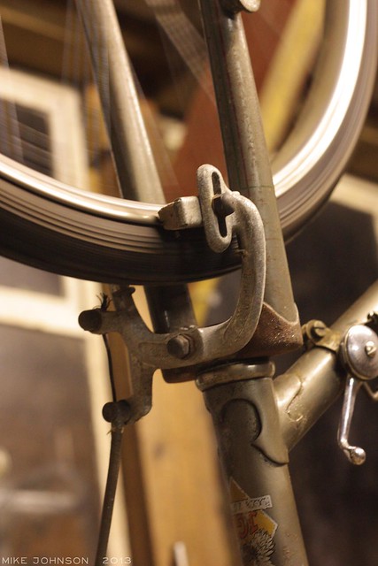

But couldn't resist spending 20 mins out there tonight ... I hadn't established yet what sized wheels I need to start looking out for. If this was a 50's machine, then I had assumed it would probably take 27 x 1 1/4 wheels. I know this is only a general rule of thumb though.
(See Alex VT's article in Classic Lightweights)
http://www.classiclightweights.co.uk/wheels-avt.html
I didn't think I had any 27" wheels to test this, but then I found them on an old 70's Carlton I'd picked up as a project for my son. They fitted fine, but the brake blocks in the caliper were way inside the wheel.
So next up a 26" was dropped in ...
Working out the wheel size by zombikombi1959, on Flickr
The old fibrax brake blocks don't look like they've been moved around at all on the calipers, so I'm guessing this is the wheel size it has always had, and what I need to look for.

Also took a snap of the BB. Not sure what the marking signify, apart from BRITISH MADE obviously.
GR23? Looking through some threads on here I spotted the same markings on a Gillot.
