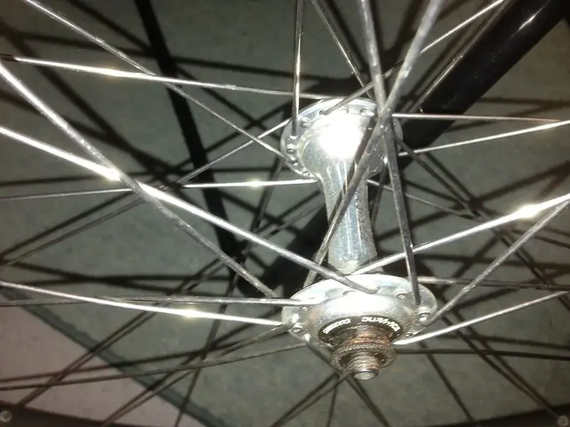

Hi - my Research come to the result, that Mapei rodes during early 90s FIR Pulsar Squadre Corse rims.
Here my front wheel which I have in stock for the moment I will find a Mapei-C40 1st Gen - I had also a 2nd rim but the
FIR lettering was not the same - the Letter of FIR decal was totally White not White-rimmed
