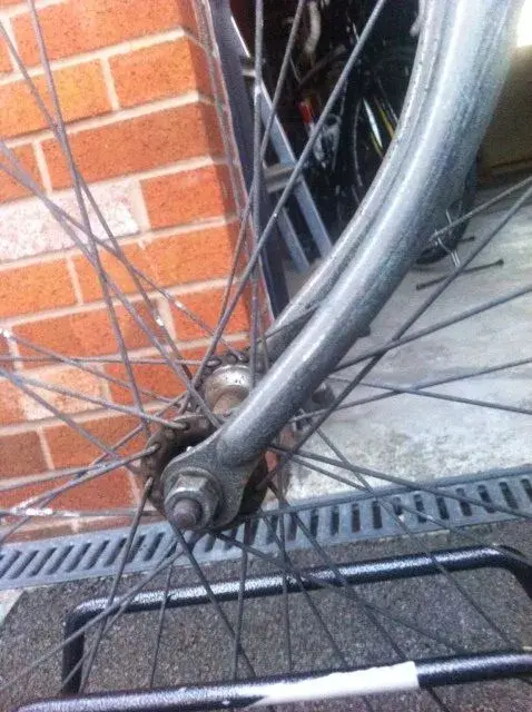

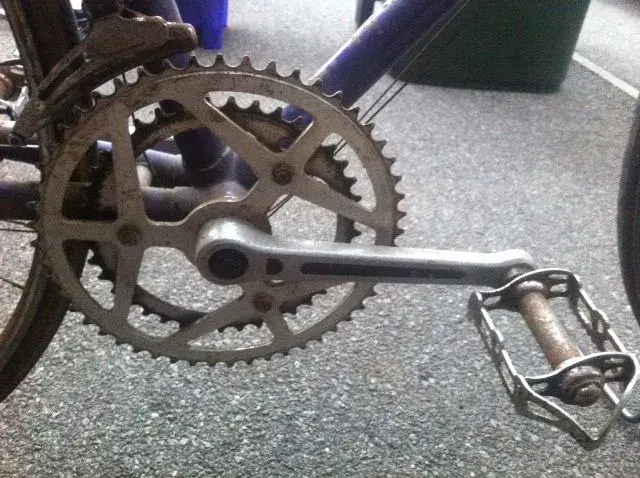

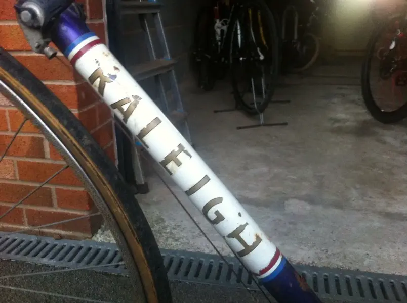

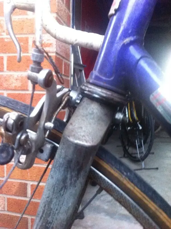

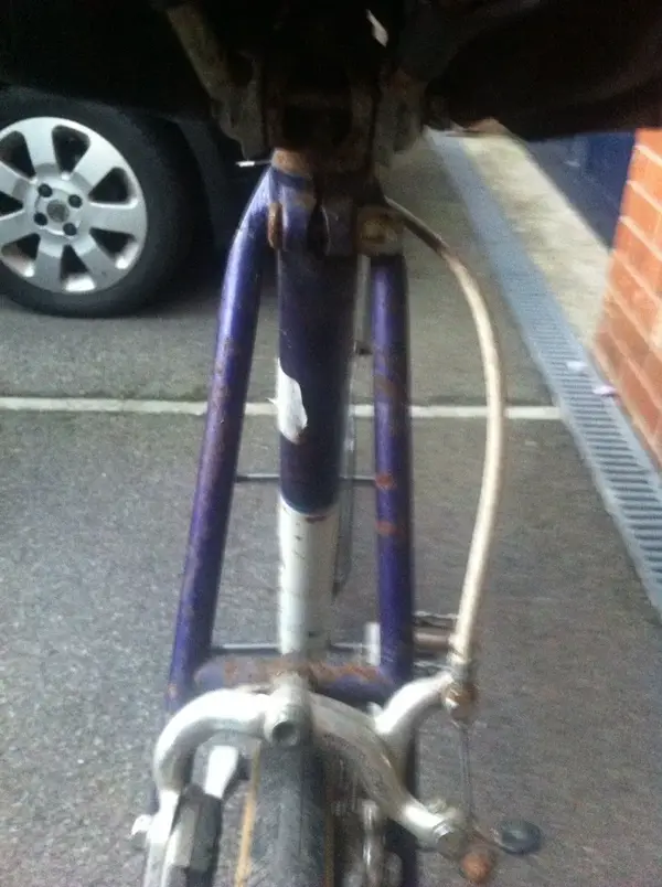

Pictures as follows, serial number on bottom bracket reads WA6000082?

Hmmm... Interesting
The frame number means
W - Worksop (Carlton built) if prior to 1981, otherwise built at the Lightweight Unit at Raleigh
A - January built frame
6 - either 1976 or 1986 (don't think it will be 1996, but I could be wrong...)
Has it been painted? I don't recall ever seeing that paint scheme, or for that matter the decals.
Are the gear changed brazed on, or band on?
The chainset looks older than the rest of the bike
The Shimano 105 Golden Arrow brakes date it at approx 1985/1986 I believe
What is the rest of the group set?
Are the wheels steel rims?
I'd have to say that the internal cable routing is throwing me, as every Raleigh I have seen from the 80's had brazed on top tube cable guides, it's the later 1990's bikes that tended to have the internal routing
Could just be a 'bitsa' bike, i.e. a frame with lots of donor parts

The brake set seems to Shimano 600, not sure about the crank, possabley a suntour unit, front a rear mech a shimano but pre indexed gears. The shifters are a clamp on design with cheap plastic levers.

The gent said the bike has been in a garage for years and doesn't know much about it, i noticed the rear cable layout and presumed it be a 501 frame.

Forks on my 1986 Team Corsa:
Forks on my 1985 Competition (these are 531):
They 'look' like the latter

It's odd, because looking at the lugs on your frame they are very similar to the 'lower end' Raleigh ones, which includes the likes of the Record Sprint which had 501 tubing.
If you look at the lugs on my 85 and 86 W prefix frames above you will see that they are more ornate..
