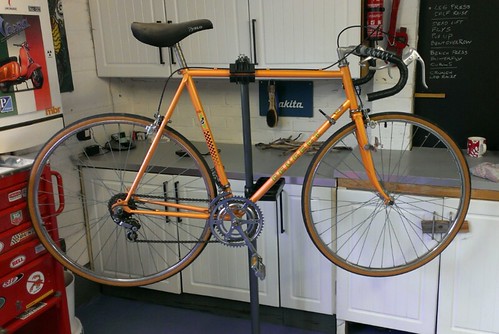

after starting to lose the will to live searching for the right bike to restore & ride I bumped into an 1981 Peugeot Du Monde on ebay that seemed a good purchase. I'm not that fussed on the credibility of the tubing or the high end finishing kit as the bike is going to get well used, hopefully for L'Eroica next year if all goes well, and having the lightest steel frame isn't much of a concern for me at all. The listing said this:
Peugeot record Du Monde road racing / touring bike
in rare orange colour
Very Retro in very superp original condition
60cm frame
27 in wheels with 2 brand new never been ridden touring tyres
Weinmann alloy brake set
Atax stem
from 1981 in good condition for a 32 year old bike
10 speed Simplex gears with plunger front mech
The pictures looked clean...
le monde 1 by vonhoolio, on Flickr
Le monde 2 by vonhoolio, on Flickr
So £137 later it arrives... wonderfully packed.. :lol:
Le monde 3 by vonhoolio, on Flickr
Its in great condition. I'll take more picture tomorrow if I get the chance. I have no real idea about the bikes provenence, I'm just going to strip it, polish clean it, rebuild and stick a decent saddle & tires on it (keeping the rest as standard).

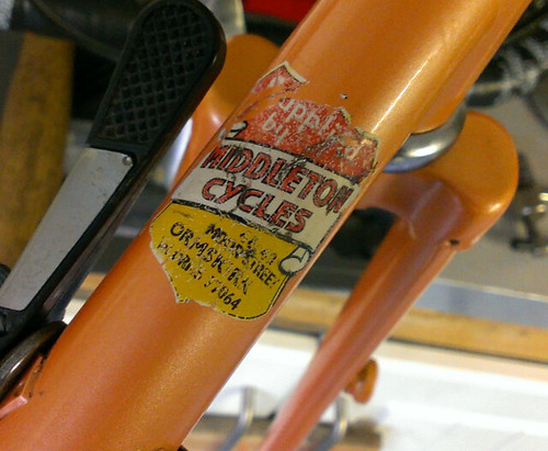

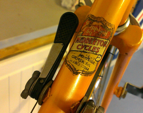

The 1st owner supposedly bought it in 1981 from Middleton Cycles in Ormskirk, the badge is still on the bike..
le monde 4 by vonhoolio, on Flickr
it cleaned up ok too...

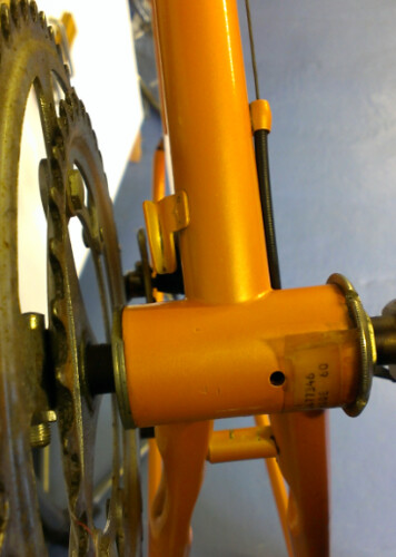

Other than that is has a sticker under the bottom bracket .. looks like a shop / stock sticker..
le monde 6 by vonhoolio, on Flickr
It says...
1677346
H10E 60

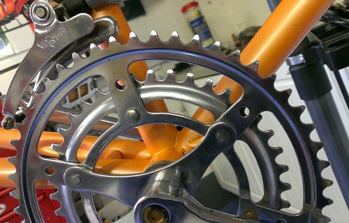

Chain ring looks in great condition to me

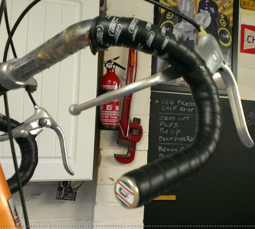

So far the bar tape is goosed (looks yuk anyway) so I'll be putting some new black stuff on there. I need two brake cables/outers and I want a saddle so I'll look at an old Brooks b17 in black simply because I like them....I'll be on ebay tonight...

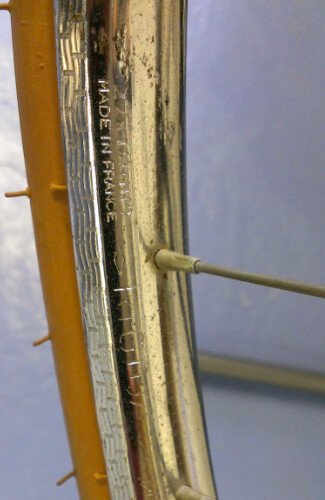

Next on the list to polish is the Rigida chrome rims with the serrated brake surface...I'm not sure how to clean the spokes though....or if I should even bother..

Scotchbright pad and WD40 for the spokes, those pads won't stop in the wet, you need leather faced pads for chromed steel rims!

H10E is the model number of your Peugeot, 60 is the frame size, date should be around 1979
