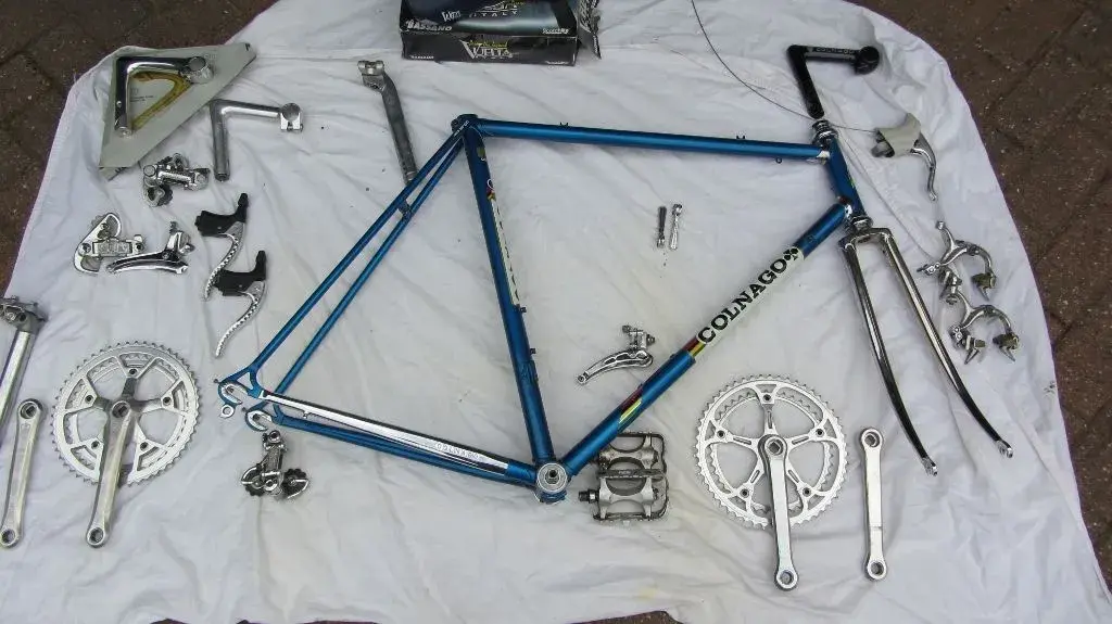

Ok folks here its is,
Don't really know whether I am bold or foolish but here is the Colnago stripped down to nearly its bare essentials...
Pretty sure now that it is a 1981/82 frame similar to that ridden by Freddy Maertens in the 1981 world cup (thanks Deax) and seems to have had some race history judging by the number hanger and info from the PO.
The headset was a bit rough so I thought I should take the opportunity to repack and re-grease it, BB ok though so that's staying in.
I'm going to rebuild it in the spirit of the 81 championship winner but it won't be a replica. So far I've got quite a few bits from the PO, my own collection and some Ebay finds but I still need bars and the right front and back mechs in particular.
If anyone can add anything about the frame or the detailed spec of Maertens bike it would be a great help.
I'm not going to repaint the frame, its in good condition and the few marks add caharacter in my view. But it would be useful to be able to touch up the odd chip and scratch. Does anyone know if you can get the paint?
To be continued....
Dave

Bike would almost certainly have been Super record in 1981, someone on here will have a more exact idea if you were looking to match bars and rims etc.
As far as touchup goes any professional auto paint store will color your frame's paint for a fee. This is really the best way to go because even if you get the exact paint code the finish on your bike may have faded over the years. Only down side is the minimum purchase is usually a pint (here in the States anyway) which is a bit much for simple touch ups.

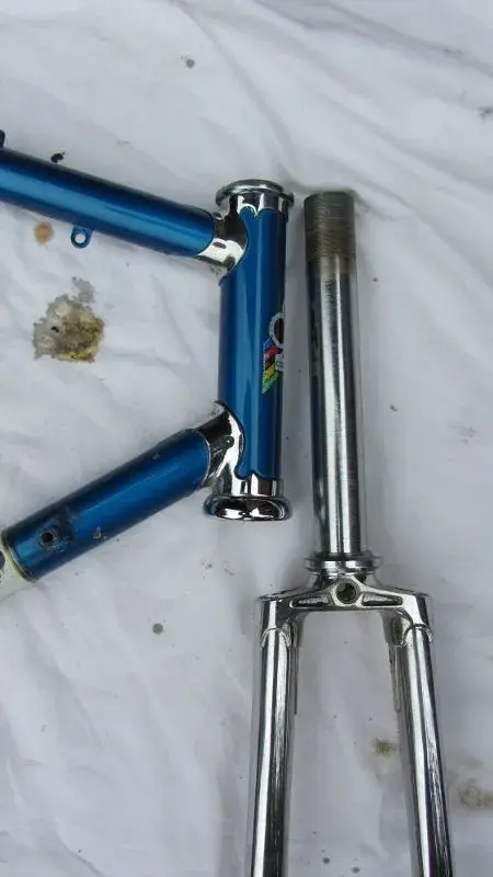

Headset rebuilt and forks back on. I've touched in the chips and dings, but left the rest of the paintwork as it was. Peugeot Aegean Blue seems like a pretty good match though the local Halfords staff did look at me a bit strangely when I went in carrying the frame trying to match it with their touch up paint.
A couple of things I noticed while it was stripped down:
- It has a number hanger on the top tube which may mean it was originally for a pro or serious rider
- The headset and bottom bracket threads are both British, which I am told means it was manufactured for the UK market, unusual?
- It was apparently originally bought from a bike shop in Romford (but not Rory O'Briens) but the PO can't remember the name. It would be good to find out...

I have never seen a English thread Colnago of this vintage that would be very unusual.
If you were going for a totally period correct build with a 1981 frame then the Nuovo Record front and rear Mechs would work, assuming the "patent" date on the rear is correct. Both chainsets are too new as is the Triomphe brakeset, the Chorus/Triomphe post and the pair of Triomphe/Victory mechs. The NR post may be a bit old fashioned looking for 81 but it works and I like the black pantoed 3TTT stem.

Has to be Nuovo Record Gruppo on this machine - good luck on the build

Thanks for your comments and help guys, especially the links to period pictures. I would really like a clearer picture of Freddies 1981 bike as ridden but haven't found a really good one yet - can anyone help?
The frame came to me with some Triomphe/Chorus bits which I think were fitted when the bike was rebuilt in 1985. I agree with Ian that NR is right for this bike (although I do also like the look of the later Record chainset)....
So I'm trying to put together as many period NR bits as I can but in good condition they are quite hard to find and therefore expensive! So some compromise is likely I'm afraid - I am keen to get it on the road and after all I can always swap components if better ones come along later!
Dave
