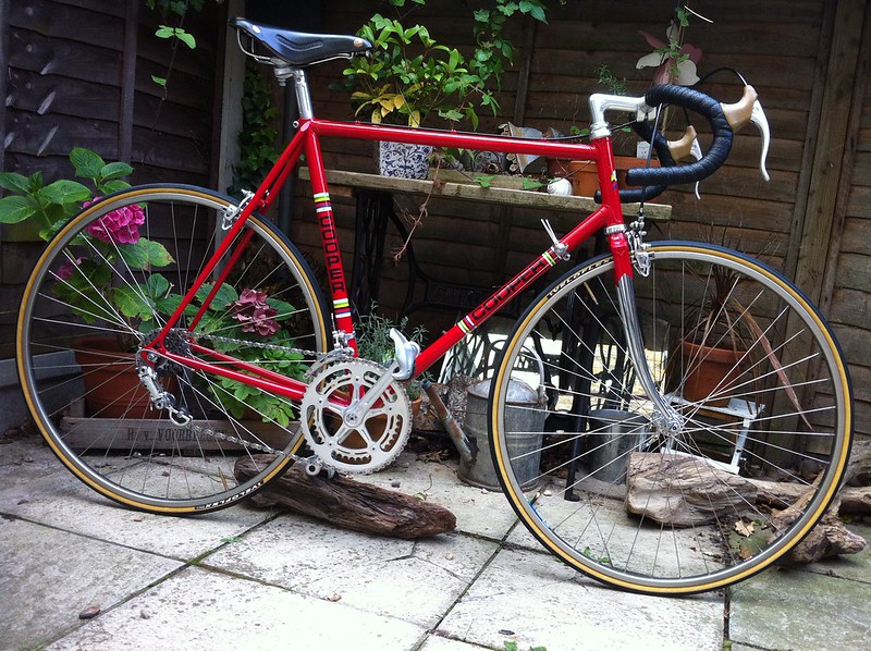

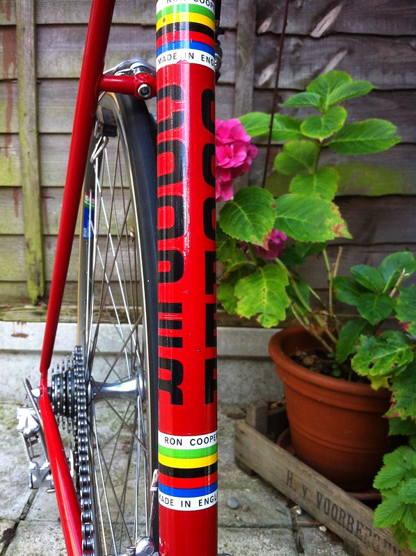

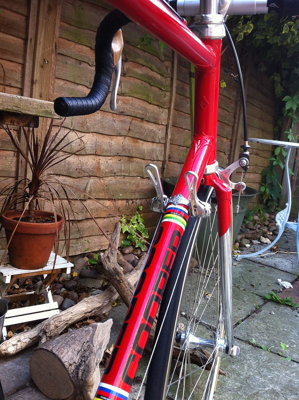

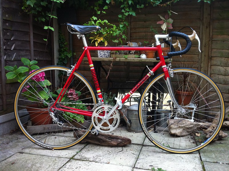

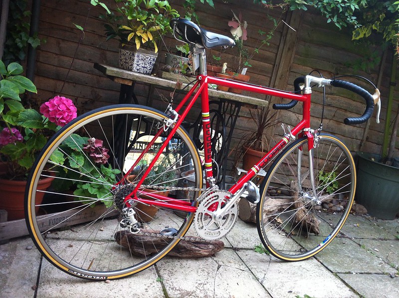

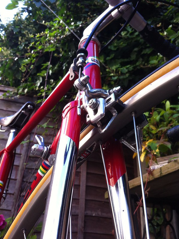

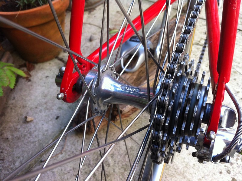

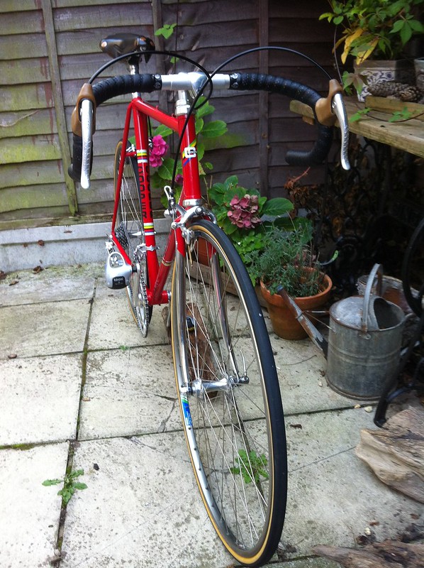

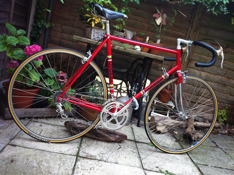

I bought a few months back on ebay, was in a used condition shall we say, I was a little unsure if it was the right thing to do, it was rideable but not where I wanted it, but I could see the potential. So far I have stripped it all down, cleaned, touched in, regreased and built back up, with a few nos but mainly decent used parts I could get hold of and afford. Things changed: bars, stem, brakes chainrings, front/rear mechs, saddle/seatpost, rear hub, chain and freewheel. The rear wheel was built excellently by a local guy in Southend at a very reasonable rate, if anyone needs such a service pm me and i'll give the details.
We've covered a few hundred miles so far and it is a delight to ride, I'm totally smitten with it.
Here's the vitals, hope you enjoy. Thanks so much to any of the people who hooked me up with parts from here to finish the build.
Frame/forks: Ron Cooper frame #009 (1982ish?)
Headset: Campagnolo 304/104
Stem: Cinelli 1A (re-issue)
Handlebar: Cinelli Criterium 65-44
Bar Tape: Cinelli Caleido EVA
Brake Levers/Brifters: Gipiemme 700CA/CC (Crono Sprint)
Brake Calipers: Gipiemme 700CC (Crono Sprint)
Brake Pads: Gipiemme Crono Special
Shifters: Simplex SLJ Retro-Friction
Front Derailleur: Campagnolo NR 1052/NT
Rear Derailleur: Campagnolo NR Pat 80
Cassette: Regina BX (14-24)
Chain: New KMC
Cranks: Campagnolo Strada 172.5 (not dated)
Chainrings: Campagnolo NR (54-42)
Bottom Bracket: Campagnolo NR
Pedals: Look 136
Rims: Nisi HR-22
Hubs: Mavic 500
Hub Skewers: Mavic 500
Tyres: Veloflex Master
Saddle: Brooks Team Pro
Seatpost: ITM corsa superleggero
Seatpost Binder: Gipiemme
Weight: approx 9.5kgs

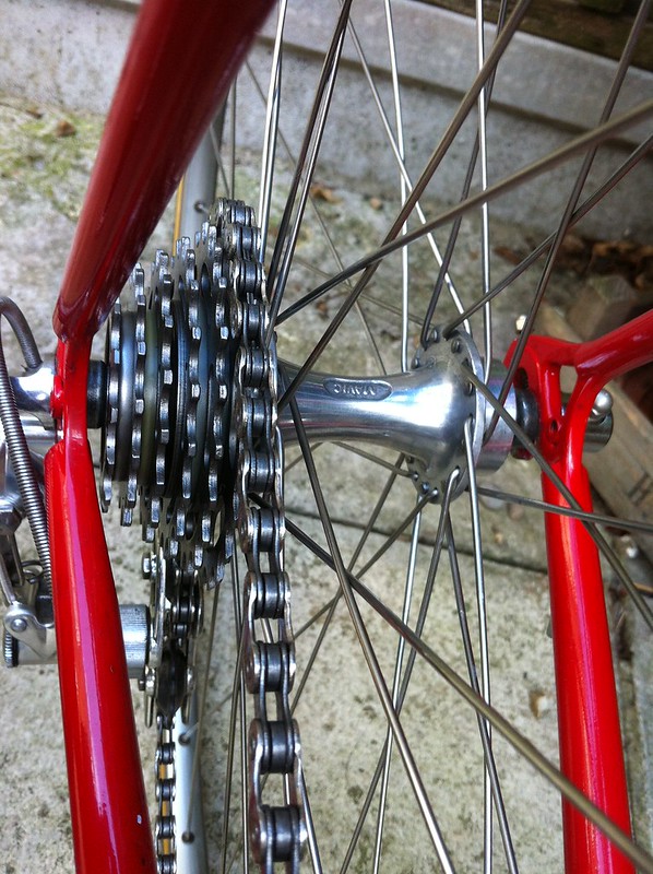

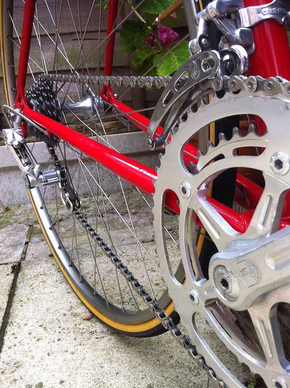

You done a good job there 8) I'd like to see a couple more links in your chain as the tension on the campag rear mech spring will have it snapping after awhile.
I thought it was a little tight too, I went with the Sheldon guide wrapping both the big rings + 1 link and it feels much happier than when I tried a longer length as it was skipping and jumping all over the place and really unpleasant, but that was with the old f/wheel and chain though so with this fresher set up I may have a little more success.... a perfect excuse to have some more intimate tinkering time me thinks now the nights are drawing in :)

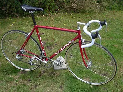

Congratulations on the build, that looks absolutely gorgeous! Got to be a Road Bike of the Month contender if you wanted to submit it.
Must admit I've always been partial to a Red Ron Cooper. I missed out on this one a few years ago and always regretted it, wonder where it is now?.....
Are you local to Southend in Essex? If so I'll keep an eye out for you and wave you down.
Well done again!
Steve.

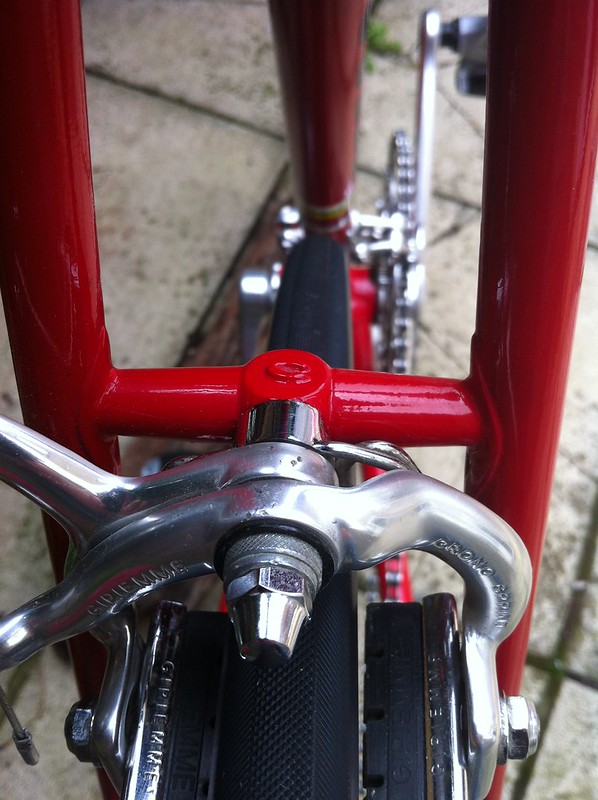

It's interesting to see all the little details on RC frames and his frames seem to differ from one another, truly handmade. The triangle "C" on the inside of your head tube, the rack eyelet inside of the dropout, "C" on the brake boss, chrome, and how the seat stays join the seat tube. All these are totally different from mine, and a very nice touch I will add.
