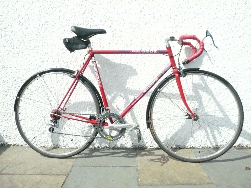

They're great old bikes, I've recently fitted mudguards to mine for the winter

Encouraging to see some newer bits bolted to yours. Mine has Simplex derailleurs at the moment, seem to remember my original bike had Hurets.
Out of interest, what chainset are you running and if you don't mind me asking, how much did it cost you?
I bought the bike new around 1985 and fitted a full Shimano 1051 groupset in 1987 and it's been like that ever since.
I still have my original Simplex rear and front derailleur and a few other original parts knocking about
