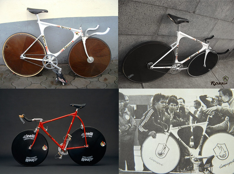

Wow, that's hot...it's my dream bike also
Go with baked-enamel if you can
I've had many bikes finished in both baked-enamel and powdercoat by a few different companies and find the baked enamel to be superior overall
I only choose powder-coating in some cases because it's cheaper and the bike has less value to me (usually a cheap resto that I'm selling on)

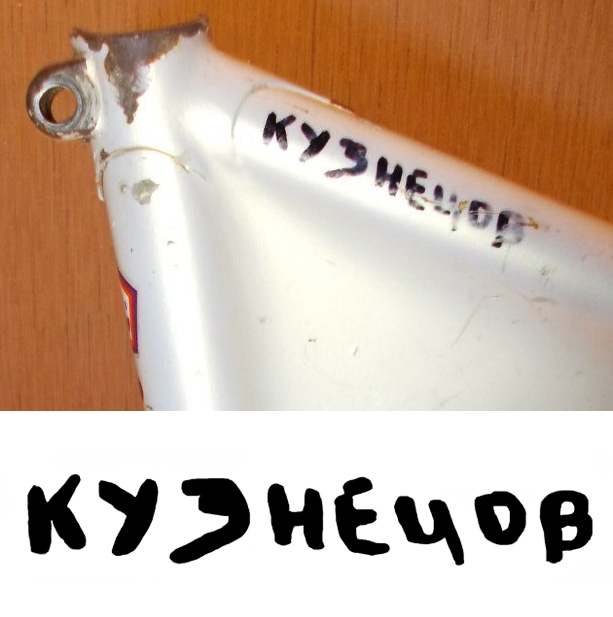

I totally agree with not using a heavy media for shotblasting. I want the lugs crisp, so I think I want to remove the paintwork myself by hand. I need to inspect the steelwork underneath the paint before I give it to a professional frame painter anyway.
I think my direction would be to remove paint by means of a chemical stripper, carefully applied with a brush as not to get any inside the frame. Once the paint is removed I will smooth it down by hand. It's then when I will be able to see if I need any brazed fillings. I have been in touch with a great frame builder who is happy to help out with these fixes.

Today I took the plunge and started stripping the forks. I used Nitromors as I have used it effectively in the past. Brushed it on, let it bubble up and scrapped it off. It killed me inside taking the paint off such a beauty, but I know it's for a good cause. I came across something which I didn't expect though. Some of the smoothed fillets I thought was brazing, was in fact body filler. All round the inside of the forks where the tyre runs was body filler. I didn't know whether to leave it or scrape it out, but I started scraping back down to the steelwork. I then proceeded to smooth the steel down and started cleaning it up. All seemed ok, no rust spots or anything.
A little inspection on the frame and the large structural fillets on the inside of the main triangle of the frame are body filler filled too. I'm not too sure what to do with these yet. Obviously they are the trademark features of the frame. I think i'm going to be very gentle with removing the paint from them and smooth them down retaining them for painting. Possibly topping it up with a newer layer of body filler?? I didn't expect this and haven't used bodyfiller before so if anyone has any advice on this I would be very grateful.

Well at least you now know that you'll need to enamel it and not powdercoat it (it wont adhere to filler)
Body filler is easy enough to use, just follow the mixing intructions and get the right grit sandpaper and you'll be able to shape it nicely
