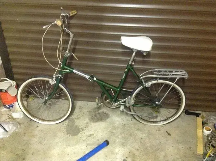

Just got back from a jaunt up to Cheshire to pick up a Dawes Kingpin. Been looking for a cheapy one to do up. With the fuel it owes me very little.
The wheels are rusty, and I may look to a re-chrome if this is possible. Getting replacement alloys might be tricky, and look wrong in the smaller diameter BMX type rims.
Headset is perect, some chrome s missing from the QD levers. The SA hub looks fine and I'll overhaul it. Paint is superb and. Love the overall finish. All in all worthnall the hype compared to other folders.
Will have a think what to do with it re: handlebars, etc. for the moment this post trip excited photo will have to do!

Cheers Meejoir! These Dawes have Standard threads on BB and Headset so upgrading should be easier than a 'Twenty'. TT handlebars and a slightly longer steerer might be in order cos I'm a big bugger :-)

Stripped the bike tonight. Wheels are knackered but the SA rear hub is a pretty nice one with nice sounding pawls.
The only challenge I can see is that some muppet has tightened the seat post with the post only partly inserted and dented the top of the tube and bnt the QD clamp out of true. Not sure how to fix this but I'm tempted to get a lug brazed on by a frame builder and avoid the problem completely.
The steerer is absolutely mint as is the bottom bracket and headset. The bottom bracket is completely sealed from the other tubes which may explain its mintyness!
Photos next week I promise!
