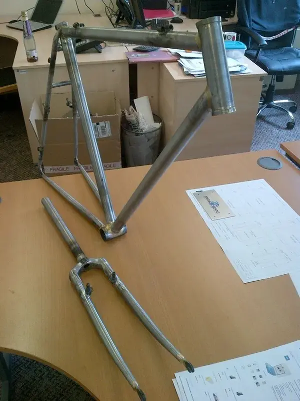

My Brand new old fashioned Neil Orrell crosser in Columbus SLX. Soon to be bright yeller and taking me over the three peaks.

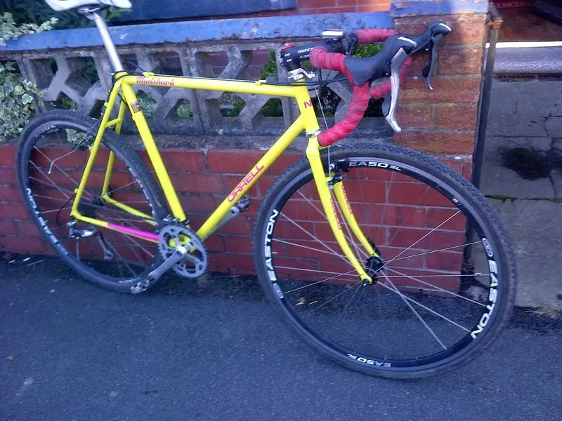

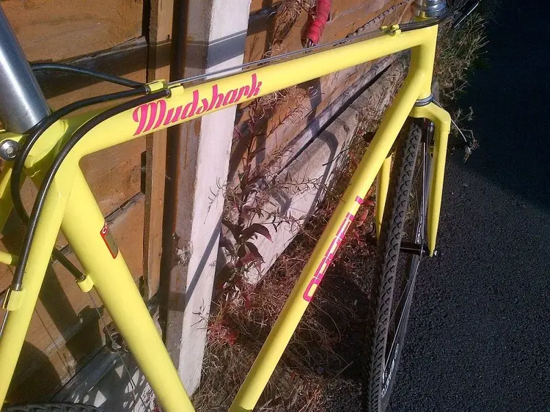

Rockin, as they say. Tis mint.

Thats a lovely build, i too quite fancy a cross bike, what size/type wheels/tyres have you used, what else is needed to convert (say a reynolds 501 80's/90's roady), and what costs am i looking at to make something a bit better than entry level?
I have got some spare road bike mechs (which are fairly tough), but am i better off using MTB mechs?
 Post subject: Re: Just picked this up.
PostPosted: Wed Aug 14, 2013 1:46 pm
Joined: Tue Aug 02, 2011 9:24 pm
Posts: 362
Them's are Easton EA50s, with 700 x 35 schwalbe landcruisers (de rigeur for the Three peaks)
don't convert a road bike- not enough clearance. Find a tourer with canti bosses and plenty of room for tyres. MTB mechs allow bigger cassettes but make sure the work with your shifters....Costs? piece of string.......
