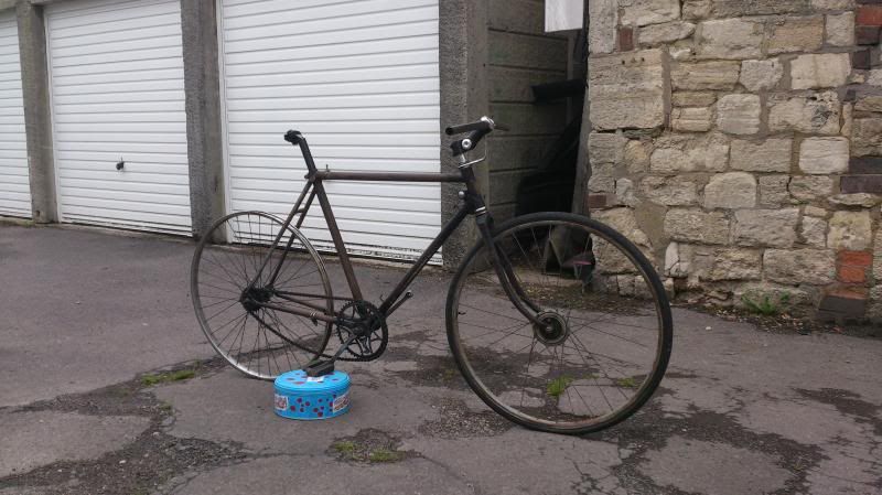

Thought I'd introduce my rudge project.

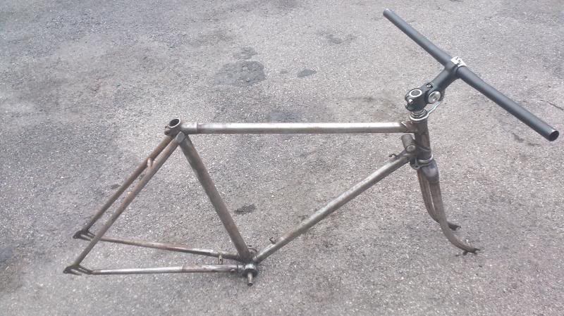

I went out on th bike one evening as the british summer was defying the odds and actually being warm and sunny... post this I decided to hang about and do some work about the garage. This was intruppeed by the owner of the garage clearing out the opposite unit.... que the question.... "Is there anything you would like in here.... there's a few old bikes.... we are going to throw it all away" At this point I SHOULD have said no thanks but it came out as Ok, I'll take them....
So I became the owner of the frames two Raleighs, a Triumph, a Sun, a Rudge, and a few wheels (all scrap)
Here is the Rudge as found with two of the wheels and a few bits I had laying about from an aborted MTB project.

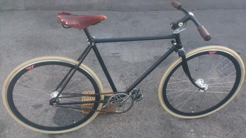

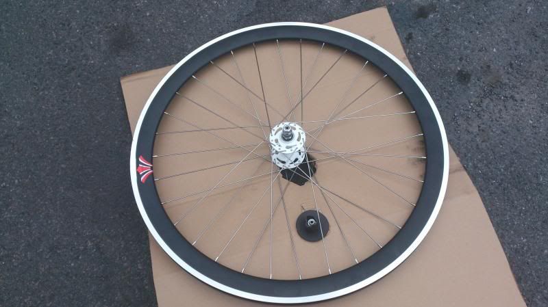

Now.... I've always wanted a single speed / fixie... que a plan....
Find these on ebay....
Strip and re-paint the frame...

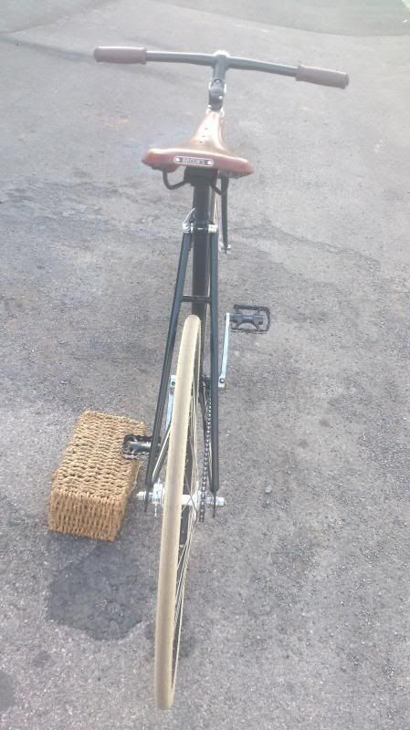

Add a Brookes saddle, leather look grips and cream tyres, clean up the crank and you get:

Cheers.
The tyres are Schwalbe Durano HS399 700x25

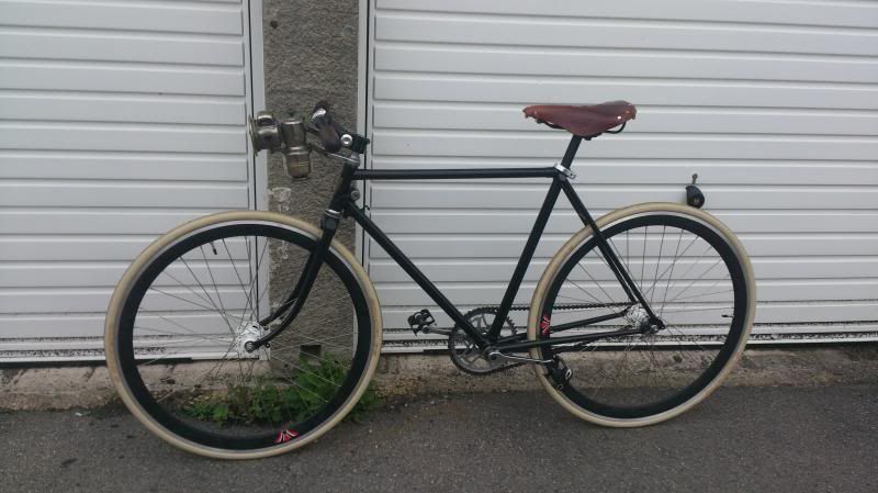

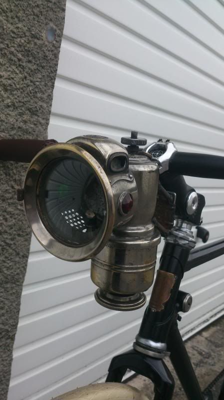

Latest addition to the bike....
A vintage Carbide lamp. Unfortunatly it can never be fired up again as the water vessle and the top of the carbide chamber are rotten. But plans involving LED's are afoot...

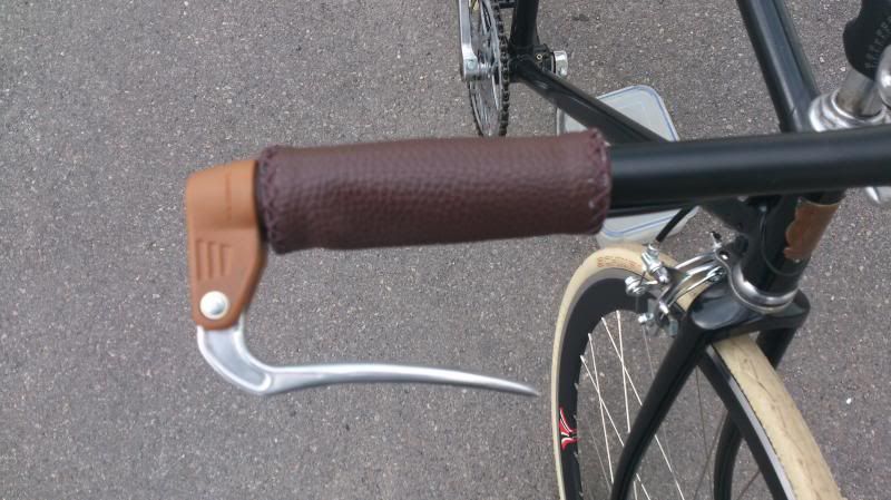

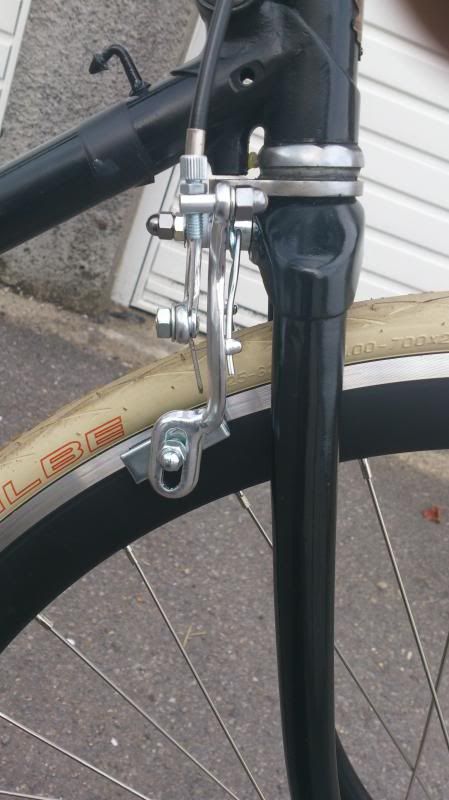

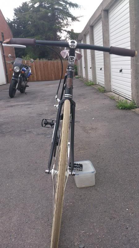

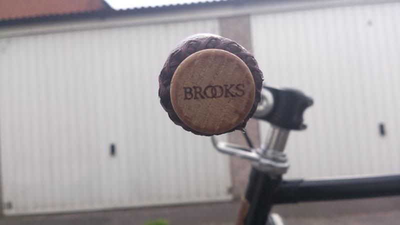

This weekends ride finally spurred me into fitting some brakes....
The newish two tunnels cycleway near Bath is great for this bike.... it really can get a bit of momentum on the long flat straights... but slowing down isn't soo efficient and my knees complained... :facepalm:
So this happened:
The caliper is a touring bike deep reach, bent to suit the rear ward (and angled) mount. These had to be used as standard road calipers do not have the reach and the cable pull is too tall and narrow to allow any steering lock.
For a lever, a Dia Compe reverse time trial lever with the ball end modified to the old spade style. I'm not sure about the brown, it may get re-painted soon, but I'm happy to have brakes.
Added bling came form this for the other bar end...
