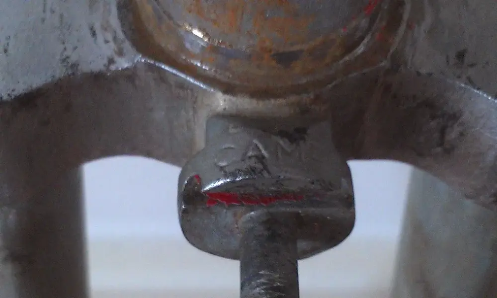

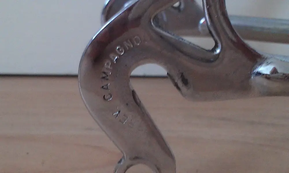

One thing I did notice when in bare metal state was that the braze-on brake bosses had Brev Camp stamped into them. Front & rear drop-outs also bare the same, so despite the shoddy condition, here was a frame of some quality, certainly very, very light and definitely worthy of restoration. Oh and the five numeric numbers on the BB - no answers on the www and no info on Poyner so I left that at that (more of this to come)
Some more pics of the dirty part of the job...
File comment: Rear braze on brake boss - Campag

File comment: Vertical dropout

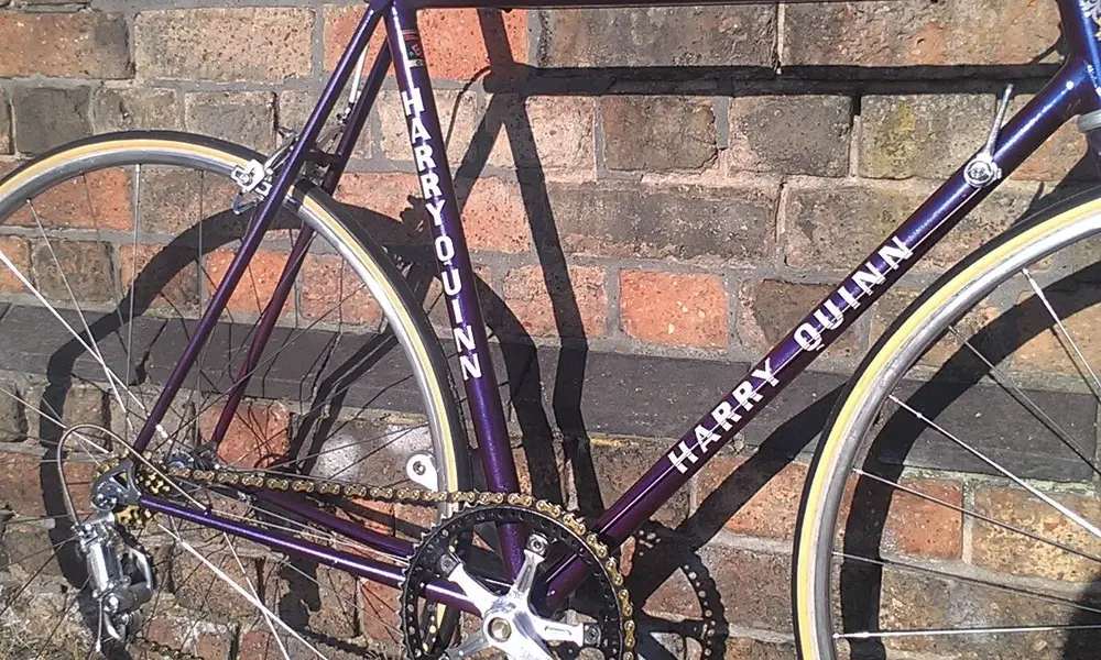

So to that 5 'digit' frame number 03439 - it wasn't until I'd completed the primer and 1st coat I was inspecting my first attempt at spraying a frame that it caught my eye - it wasn't a 0 but a Q. Straight away my hunch was Harry Quinn so I contacted RB member Blightyinfurs and asked him how the Q was constructed - "a 0 with a 1 struck under to create the Q" came the response. There we are, not a Poyner but a Harry Quinn. Cross referencing ClassicRendevous the frame number would be somewhere between '72 & '75 by my reckoning.
I must say at this point, knowing more about what I'd actually bought and then knowing that it was a genuine HQ built in Liverpool, I was pretty bloody happy. So despite ordering Poyner decals from H Lloyds and buying what was principally a pile of components based around 1977 or thereabouts, the build had new impetus, just needed new decals...

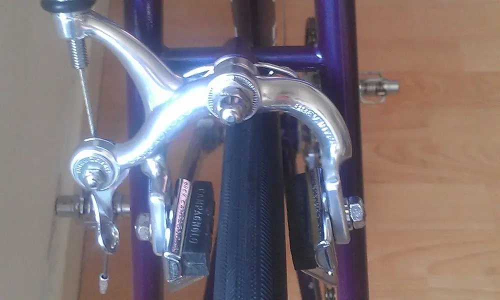

The brakes are pretty difficult to set up as the braze on bolts hold the tension spring and therefore alignment is limited - to this end the calipers aren't quite sitting correctly and pressure isn't applied quite equally via both brakepads. All in all though, I'm pretty happy with how this turned out even though it wasn't what I had planned when I originally bought the bike. However, I'm delighted to add a Quinn to the stable and I've learnt a lot and thoroughly enjoyed this project.

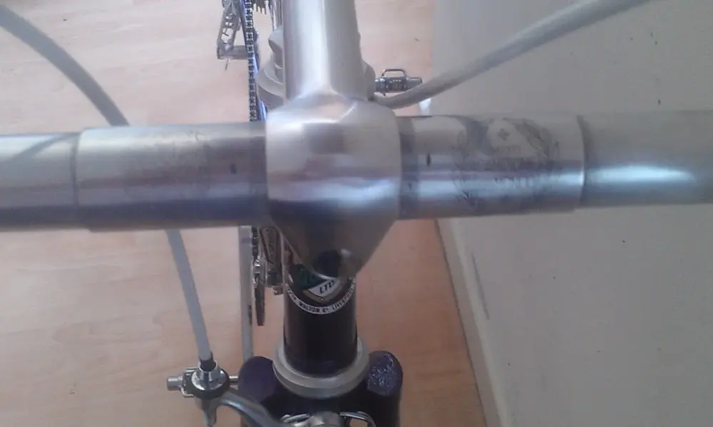

File comment: Cinelli
File comment: Caliper

File comment: Harry Quinn

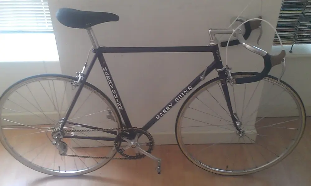

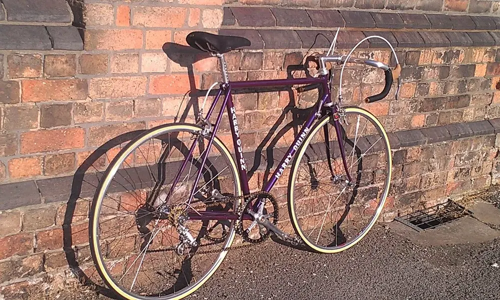

Bathed in sunshine....it could almost be the summer of '76....
File comment: Should sign up for a photography course
File comment: Or just buy a proper camera
File comment: Is Jessop's still in business?
File comment: Useless camera phone...
