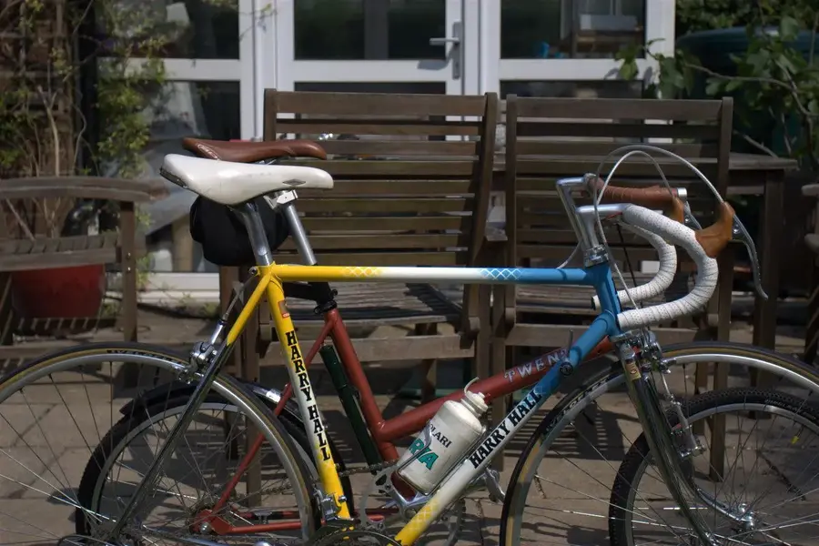

I'm 5'9 or so. You can see from the picture below that It's possible to get a very similar position to a road bike despite the completely different geometry. It's actually really comfy.
Obviously you can't get the same gear ratio as with a 700c wheel but the SRAM with the 50 and a 19 on the back is pretty good for the flat

Cool, thanks. I'm a bit taller, but I've been comparing it against my Specialized to give me an idea and I think I'll be able to get quite a usable geometry.
