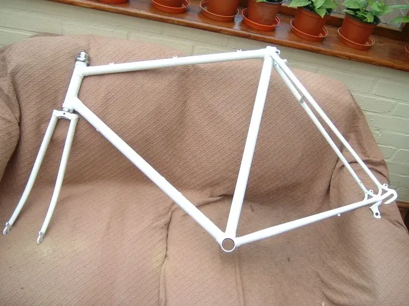

Hi all,
Thought I'd show you my Galaxy that I picked up from the Bay a few months ago for around £60 for the whole bike.
All the parts came off the frame without too much trouble, which is always a bonus!
531 tubing (or so the stickers said so!) Paint was bad, decals worn out, couple of dinks that I silver soldered (they were nothing structual)
Basically, I nitromored & sanded the frame to death, bead blasted & my mate powdercoated it for me.
I picked up a new headset that I've fitted (it was a JIS which is 30.0 cups & 27.0 fork race.) The old plastic pipe over the steerer tube worked a treat to get the race installed :D
I have a new Tange BB to fit. The rest of the Suntour kit came up OK, so will use that.
The freewheel & chain also seem OK.
Stripped, polished & rebuilt the front wheel as the spokes were rusted badly, just need to do the same to the rear now!
I don't really want to cut the steerer tube down, so used some of the old 1" spacers from the old headset, but they're a bit wide, so if anyone knows where I can get some narrow ones from, I'd appreciate the advice.
Anyway, here's the before & very basic after.
Would anyone be interested in photos as & when I've completed "the next bit?"
Richard :D

File comment: After Powdercoating and headset fitting

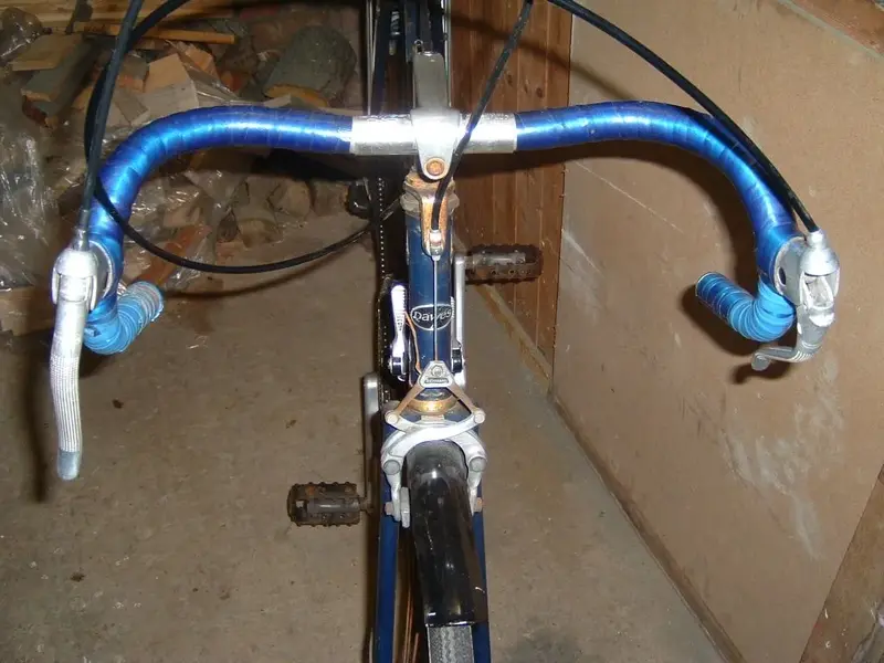

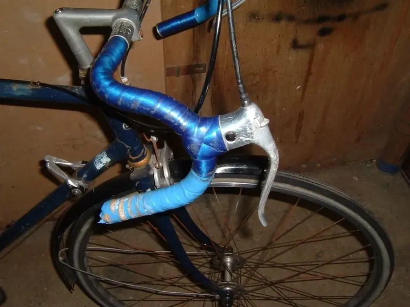

Here ya are, all before pics :D

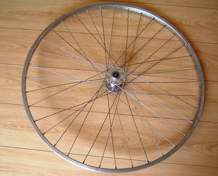

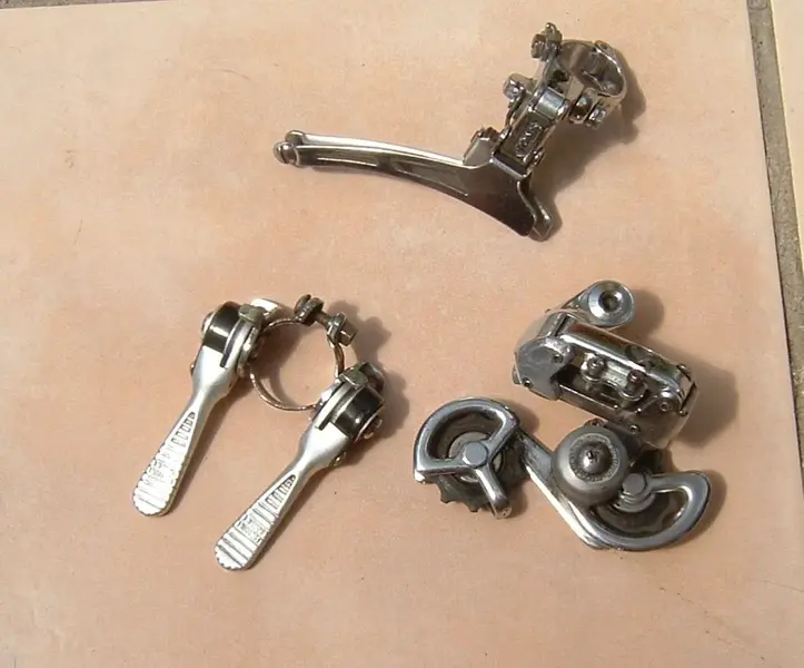

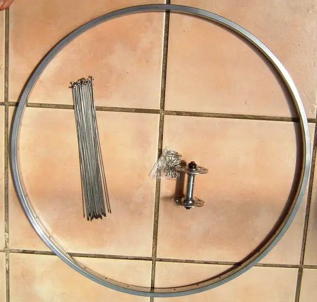

A couple of updates as I've had some time this weekend.
The front & rear mech & down tube shifters have been part cleaned (I'll do some more on them very soon)
Front wheel stripped. Rim was rubbed down with a kitchen scourer & fine wire wool, then autosol magic.
Hub stripped, degreased & bearing replaced. The cones were OK, so will go with them.
Laced pretty much as they were... 3 cross. I need to true the wheel now. :D
