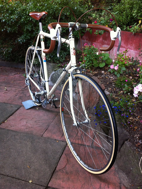

Its time we started a Rotrax appreciation society :)
Lovely job you've done. Did Tim Maund help you out with details?
I've read somewhere that Rotrax are the oldest bicycle company in Britain who are still in operation.
Here's mine, much younger at 1986 but it also started life in Brunswick Green.
