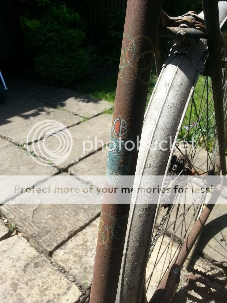

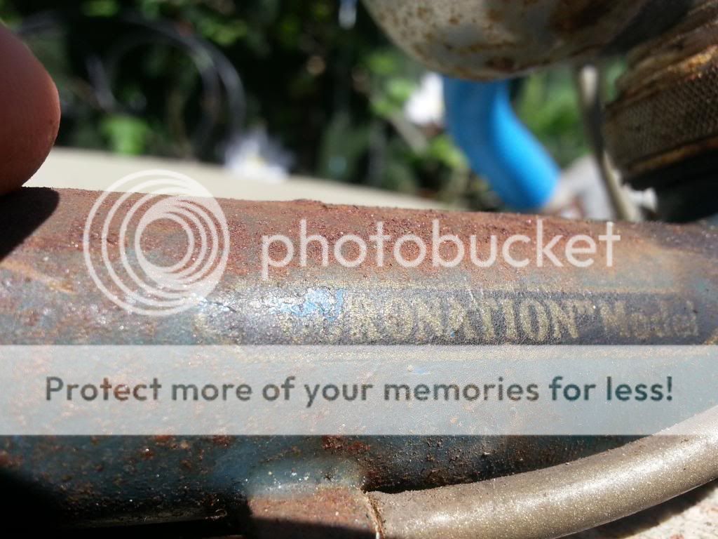

So I drove over the next day, bike looked as rusty as it did in the advert, I had a quick look over, Brooks saddle, Miller dynamo (retro-fitted) and a lugless frame which I thought was cool for a C.B. the one thing that really stood out to me from underneath the surface rust was a little decal which said 'Coronation Model'

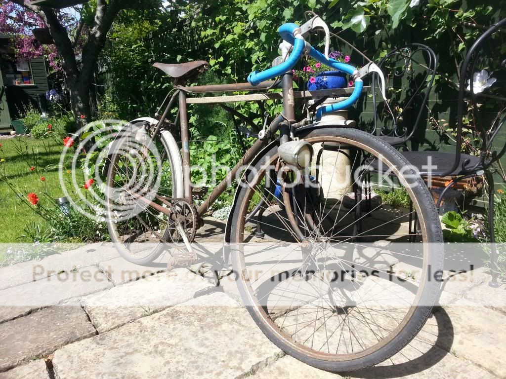

So I shoehorned it into the back of the fiesta and drove home, unloaded and got some pics.
After a bit of research, I found out it is a 1954 Coronation model, 3-speed. I've found incredibly little information on these bikes (just nkaligriff!)
Does anyone have any more information on the Coronation model? I've only seen a snippet from the 1953 brochure and I've not seen another on here either!

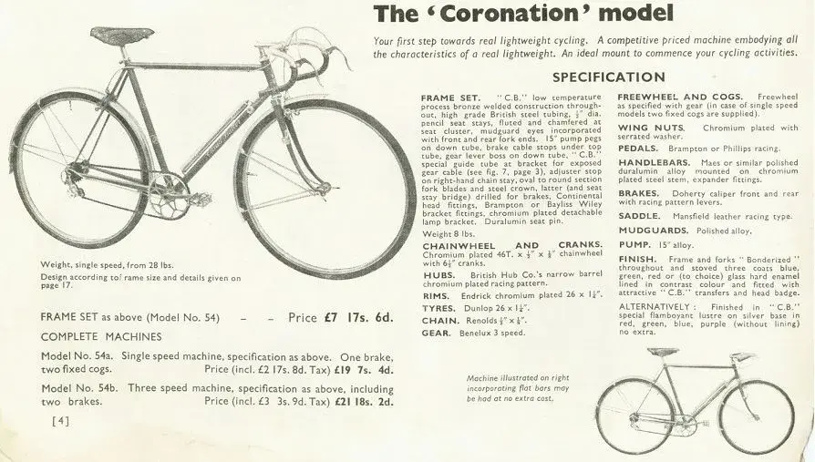

Hi, nice project, looking forward to seeing it complete, a long way to go, get the plus gas out first. As far as decals http://www.hlloydcycles.com/ is the best bet and ring him, he may have that coronation one. Below is the cat page from the 1954 one. Good luck Terry.

Amazing machine, looks completely original, and the 3 speed version too.
Best of luck with the build.

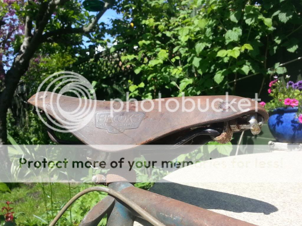

Yeah it's a complete bike which is even better. It all looks original except for the added dynamo and it has a Brooks B15 which I don't think was standard.
