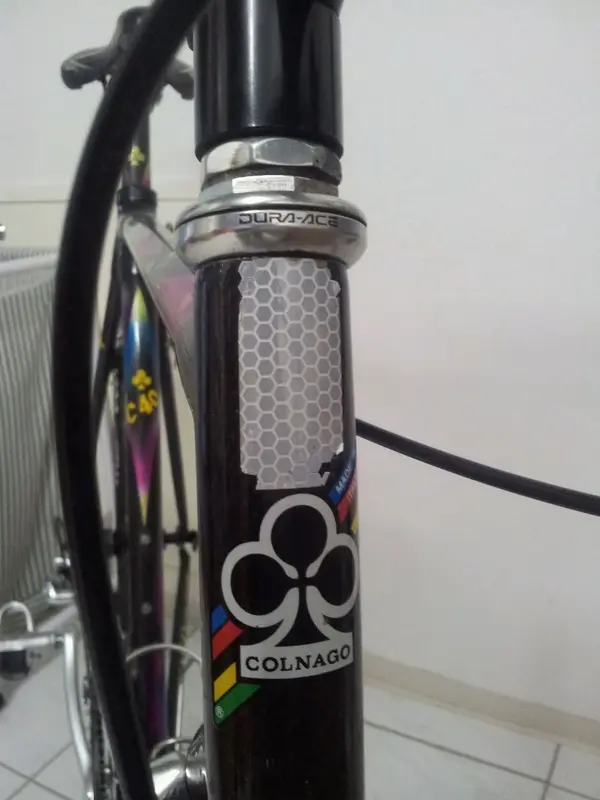

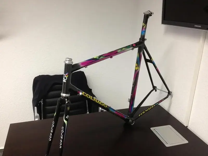

Here are 2 nice pics of the frame set incl. original seat post
Thank's in advance
Grettings from Germany
