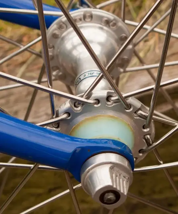

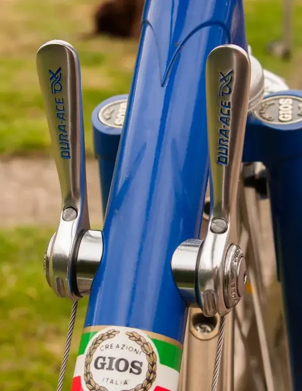

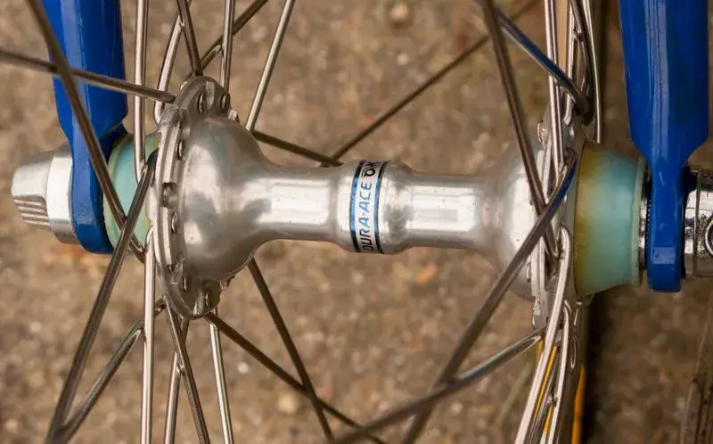

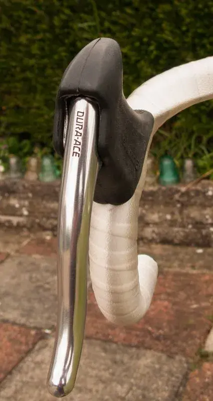

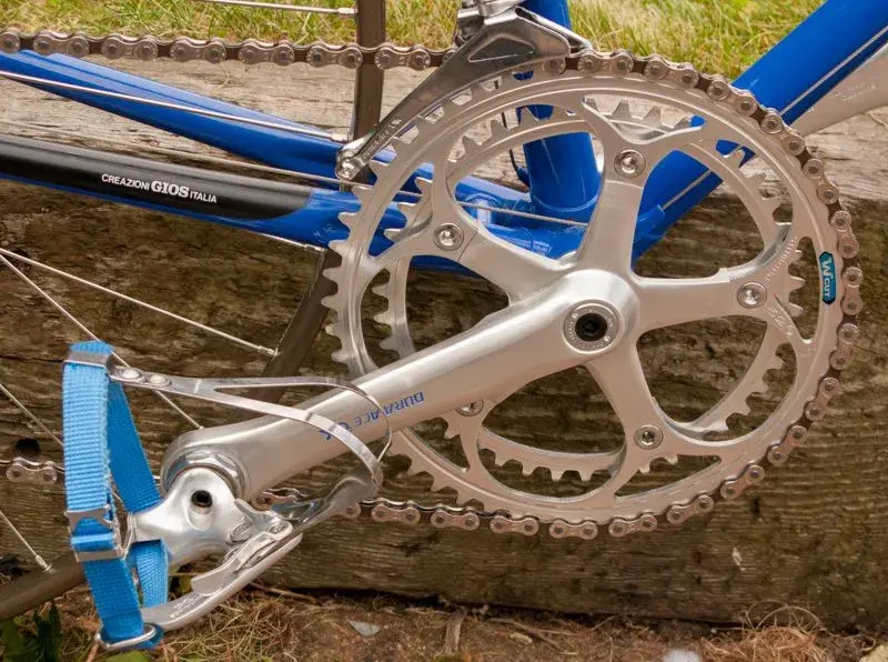

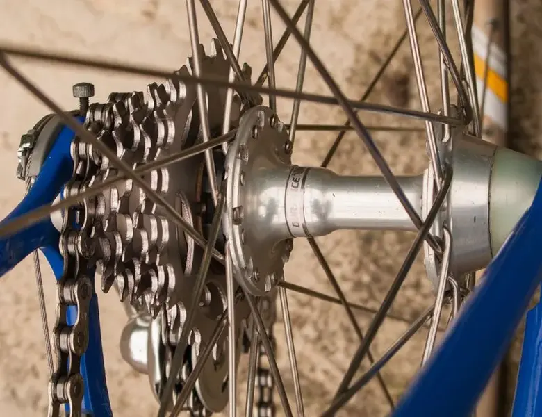

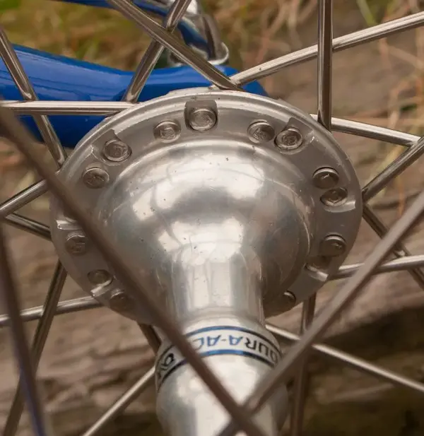

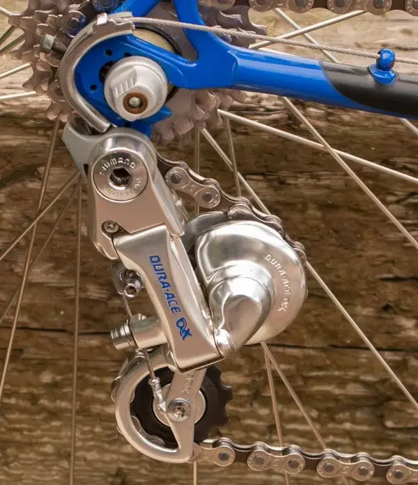

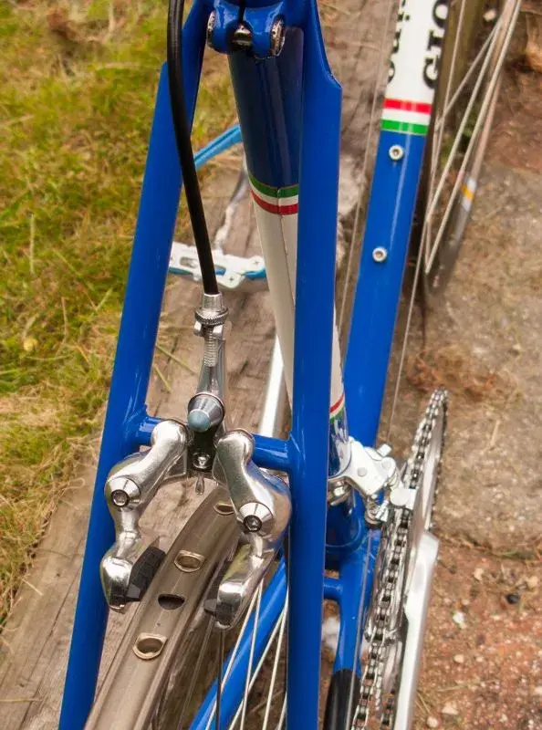

A Gios Torino Super Record from 80s!! OK before you all start, I know it should have a Campagnolo Super record groupset fitted BUT I wanted to show this a with the very rare Dura Ace AX 7300 Groupset only made for a couple of years 1981-84. With the Delta Style brakes & Aero Brake Levers (were these the first?). Also this groupset had the strange hubs that were all laced from the inside to the out & you can only build these one way. (see the photos) The rear gear is a real strange piece of kit. Believe it or not but its Indexed, & needless to say it doesn’t work (or at least I can’t get it to bloody work) So I assume Shimano couldn’t get the bugger to index either as all the later index gear systems had the indexing in the gear levers & not the rear mec. This also has a 7-speed cassette hub. (very early days for cassette hubs). Pedals with toe straps now that’s a novelty on a road bike now days. Anyway I hope you enjoyed looking back at some of this old ground breaking kit that pioneered the way for the stuff we use today.

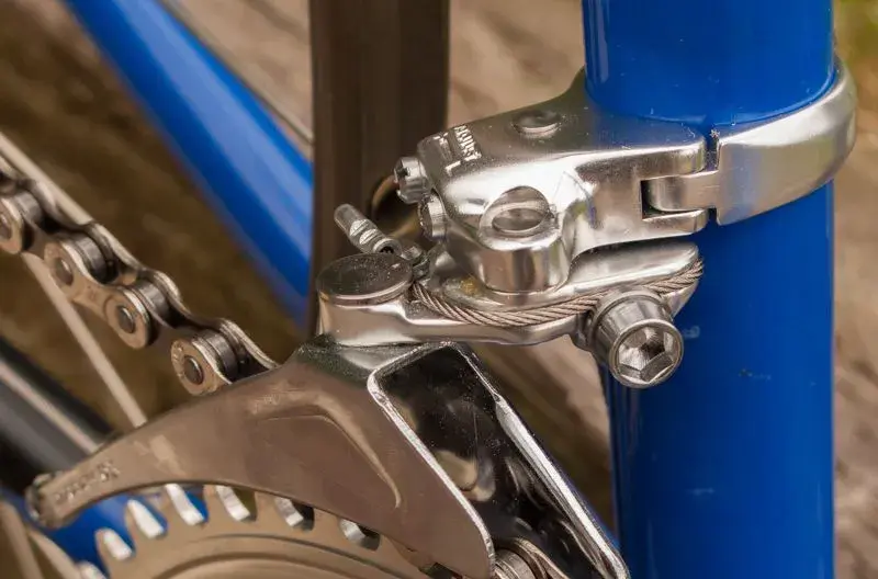

Brilliant stuff! And as said before: just great to see another different group set than the nowadays oh-so familiar SR groupset! I love the mechanics of the front derailleur!

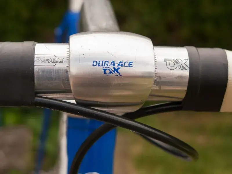

That grouppo looks incredible, such brave engineering. Even the downtube levers look so neat with the flush bolt. Totally agree with your comments on groupsets - my father demanded I rode european when I was young so ultimately campag has dominated most my bikes, but there are so many gems out there - parts of ofmega's mistral for instance. Love the pics, but we need some more of the components!
