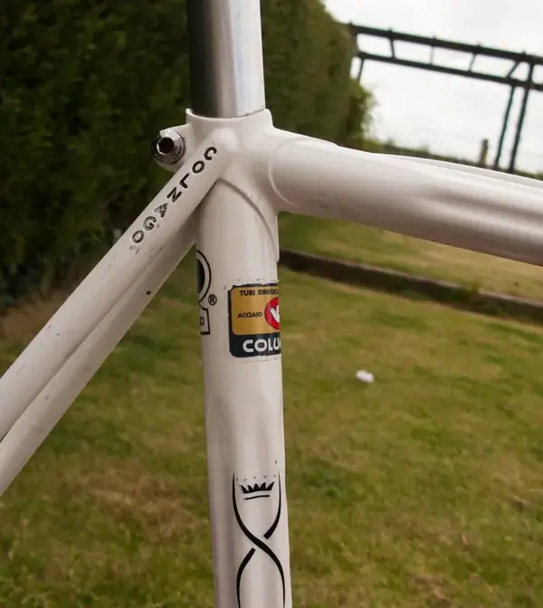

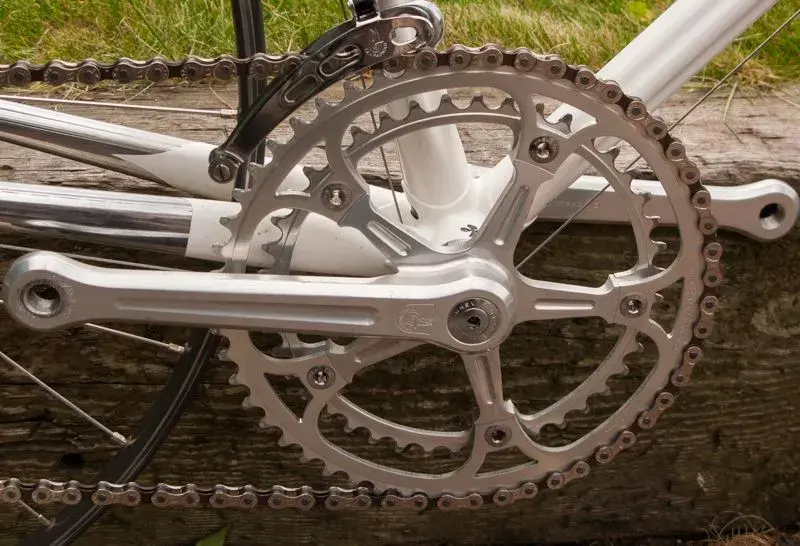

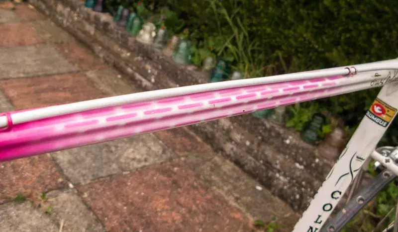

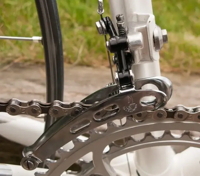

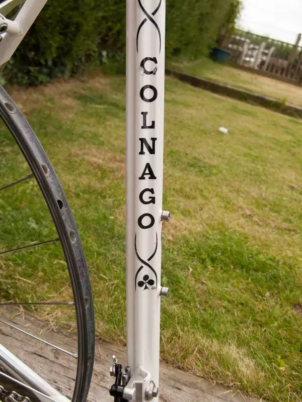

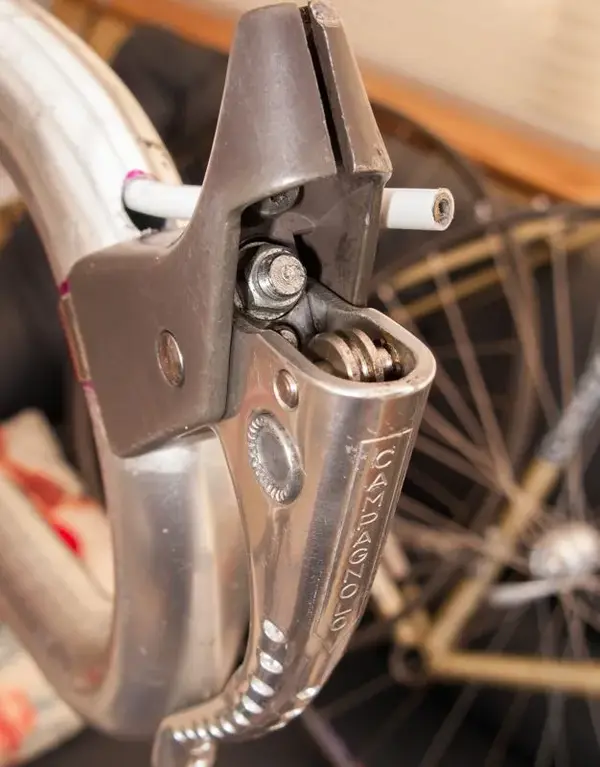

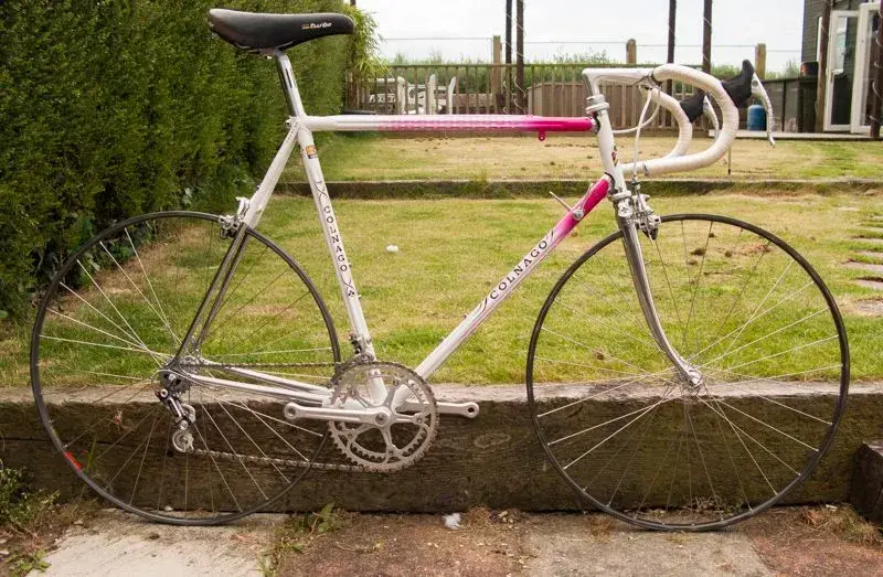

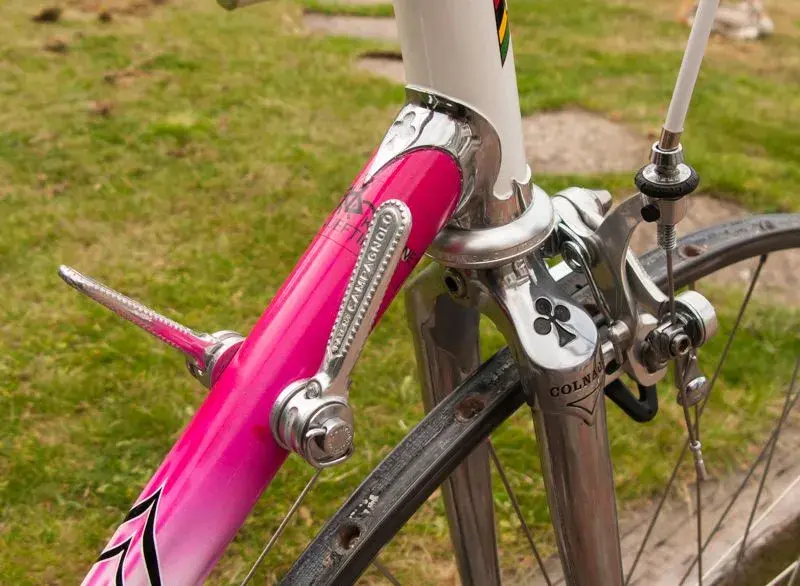

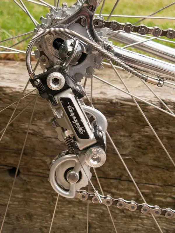

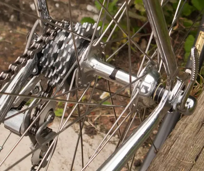

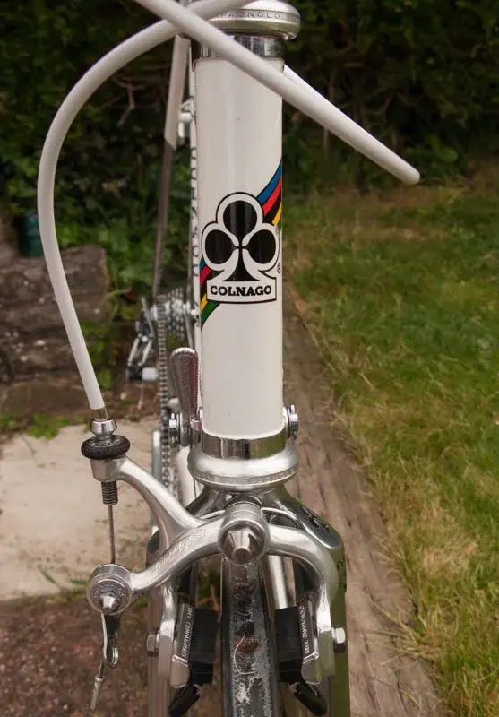

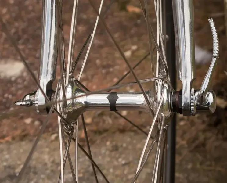

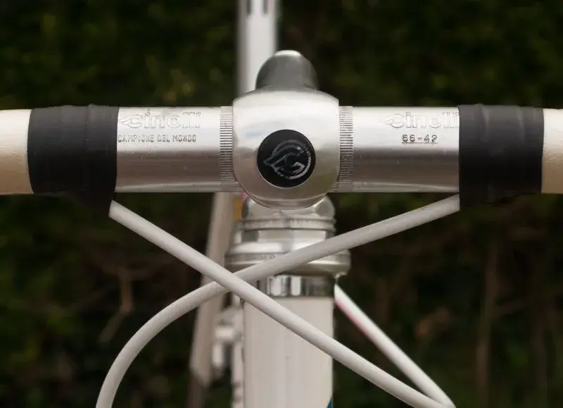

This is the much Rarer of the 3 Colnago Mexico's (The ESA Model) with the 6 crimp's in the tubing, which was used before the change to the 4 crimp Gilco tubing used on the later Colnago Master's. I have tried to show this in many of the photos the 6 crimps on the Seat, Down & Top tubes. Also on this one I have used some unusual Super Record Aero Brake levers these I think???... were a modification by Scalpin. The genuine Campag Aero levers first appeared on the later C-Record groupset. As you can see from the photos this was not some amateur bodge up but done professionally & from what little I can find out about these they were available to the public. I drilled the bars to keep the cable runs as straight as possible out of the brake lever.
The rest of the groupset is just the very common or garden Super Record with Mavic GP4 rims.
