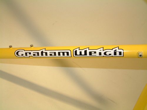

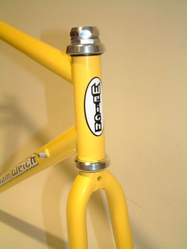

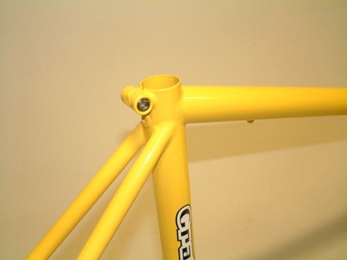

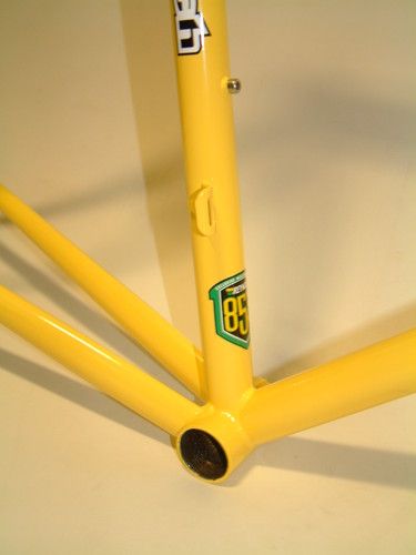

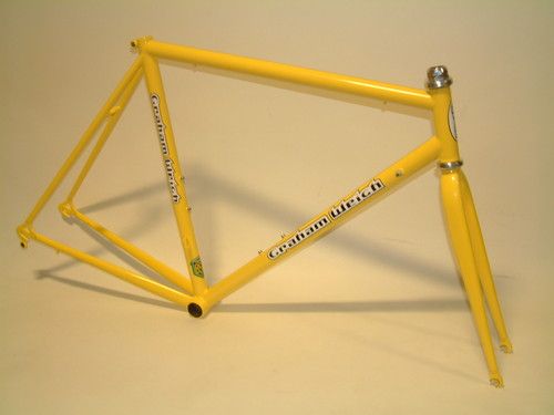

Just bought this frame, not exactly retro but it is around 14 years old.
My original plan was to use the Shimano 1050/1051 groupset from my Peugeot P10L but I'm not sure if it will work out
A few of questions if anyone knows the answers.
What groupset would have been fitted when new?
What is the stem diameter?
What is the rear spacing, is it 125oln or 130oln or something else?

Nice looking frame, really clean and sleek. It is likely a standard 1 inch headset and thus any 22.2 stem will work, similarly the rear spacing is very likely 130. But hey just grab a ruler and find out. As far as the group is concerned Graham Weigh is still around so you could ask them?

+1 on the rear end - 853 is such a modern tubeset that for a geared road frame, anything other than 130mm would be odd.
Frames (built by Paul Donohue IIRC) were supplied built up to customer order with varying combinations of groupset (Campag and Shimano available) and finishing kit, based on hazy memories of the old Deeside Cycles adverts in Cycling Weekly. So, pretty much any spec you wish would work.

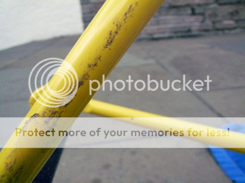

The frame arrived today and when I removed it from the packaging my heart sank
The good news was that upon closer inspection it was just some muck and adhesive from lying around so a rub with the polish cloth removed it
The only mark on the paintwork is where a front wheel has been clamped onto the fork

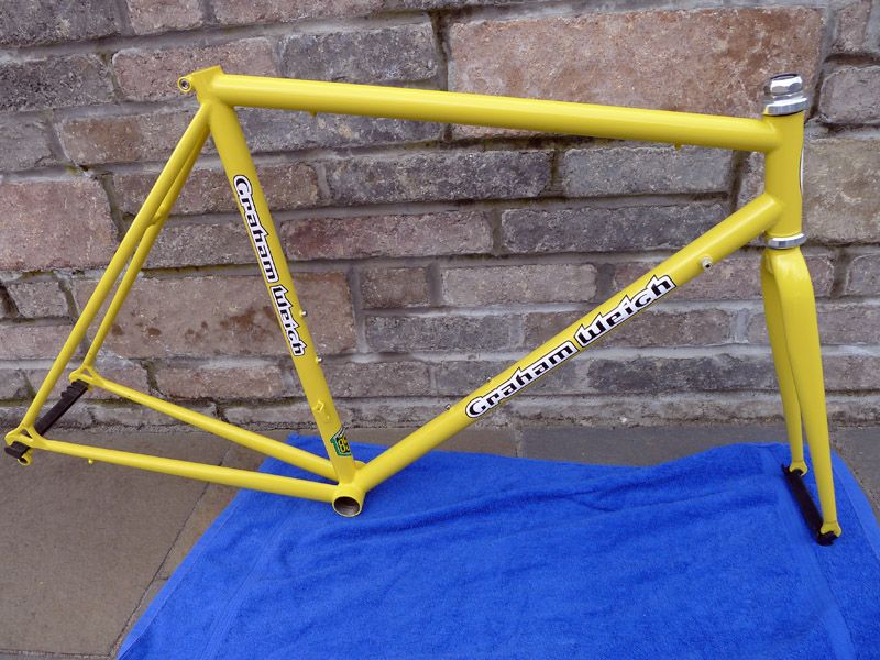

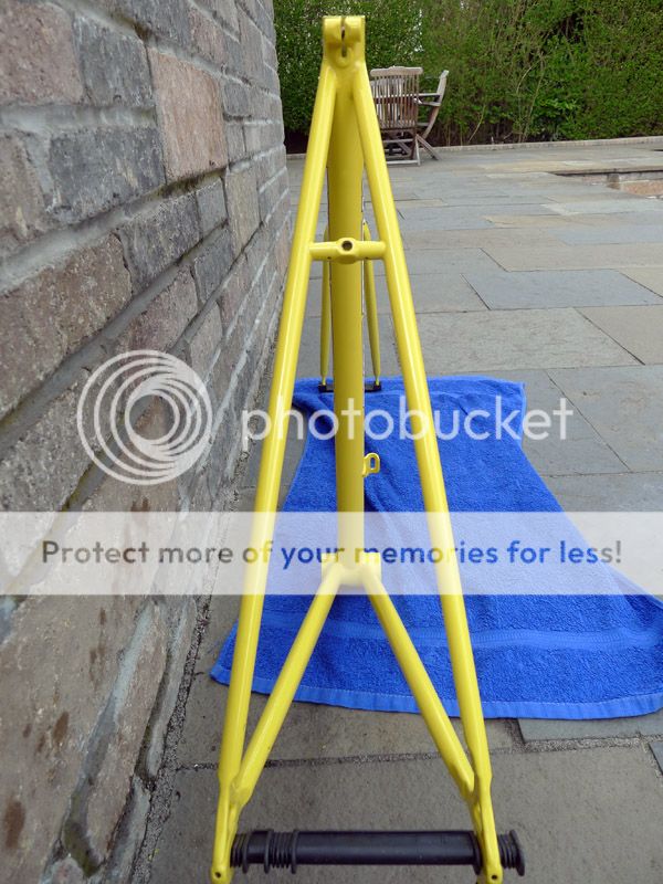

Frame, forks, headset, boss screws and seatpin weigh in at 2.735kgs which from what little information there is on the net is on the light side for 853 framesets
Next question, are all drop out screws the same size?
