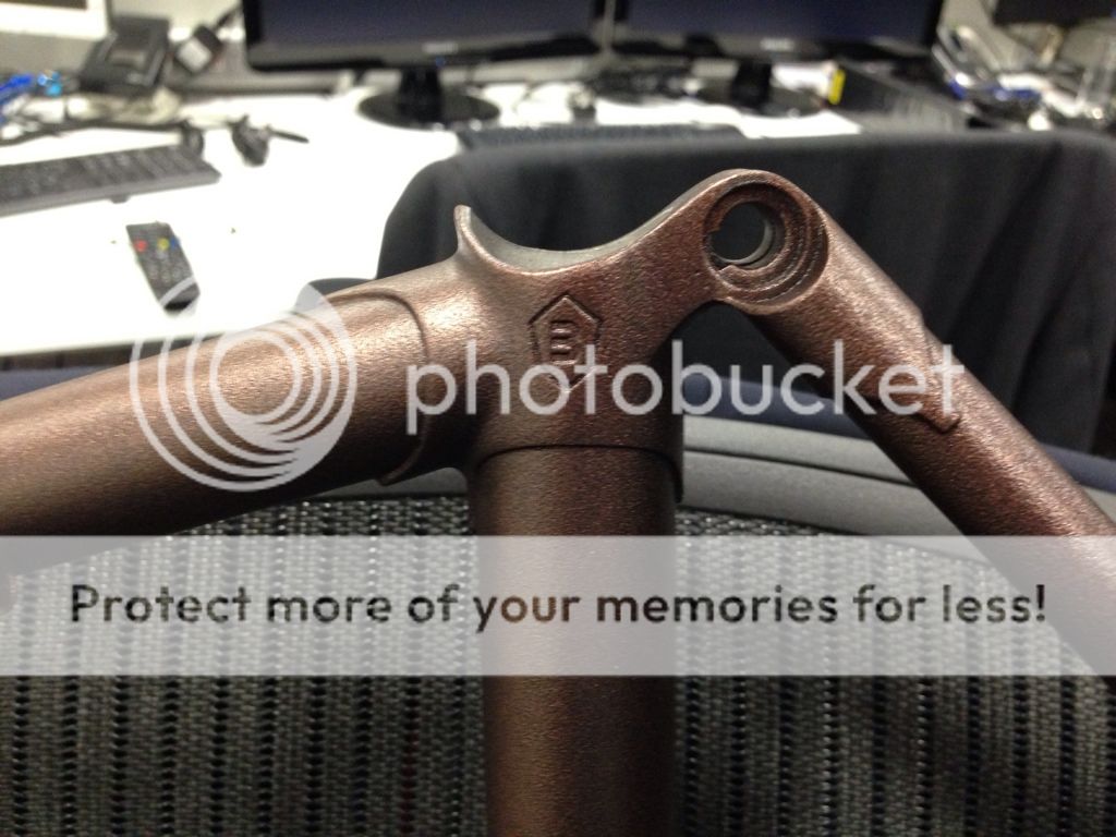

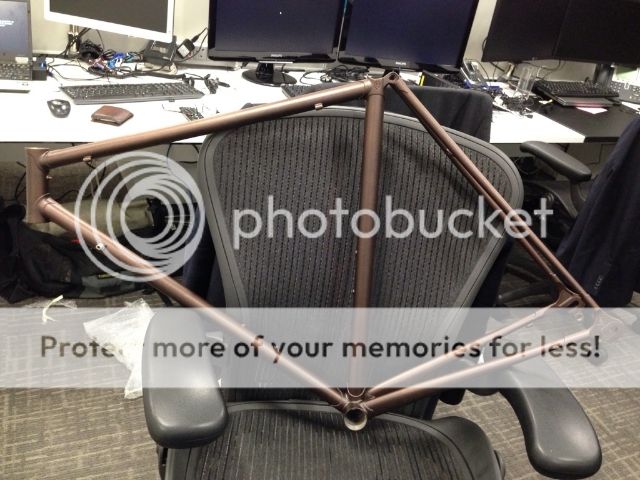

The paint was a lovely cherry red, and looked to be in top condition... But yeah .. Paint is just paint to me and I wanted something a little more unique / modern. A trip to the powdercoaters later, and the frame came back in an awesome textured copper/brown.
The finish is a special kind of paint from armourtex called 'phosphorous' .. but it definitely doesn't glow in the dark! Often a Powder coat is too thick and will soften the lugs - looking horrid.. But in this case the lugs and pantographing are lovely and sharp.

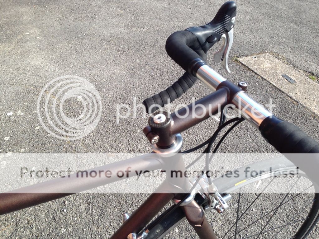

Next up - a conversion to ahead - and some straight blade forks... Plus a KELLY stem I had knocking around painted to match.. Using a 110mm ZERO degree stem allowed me to get the 'slammed' look without adding 2" of spacers with a negative rise stem

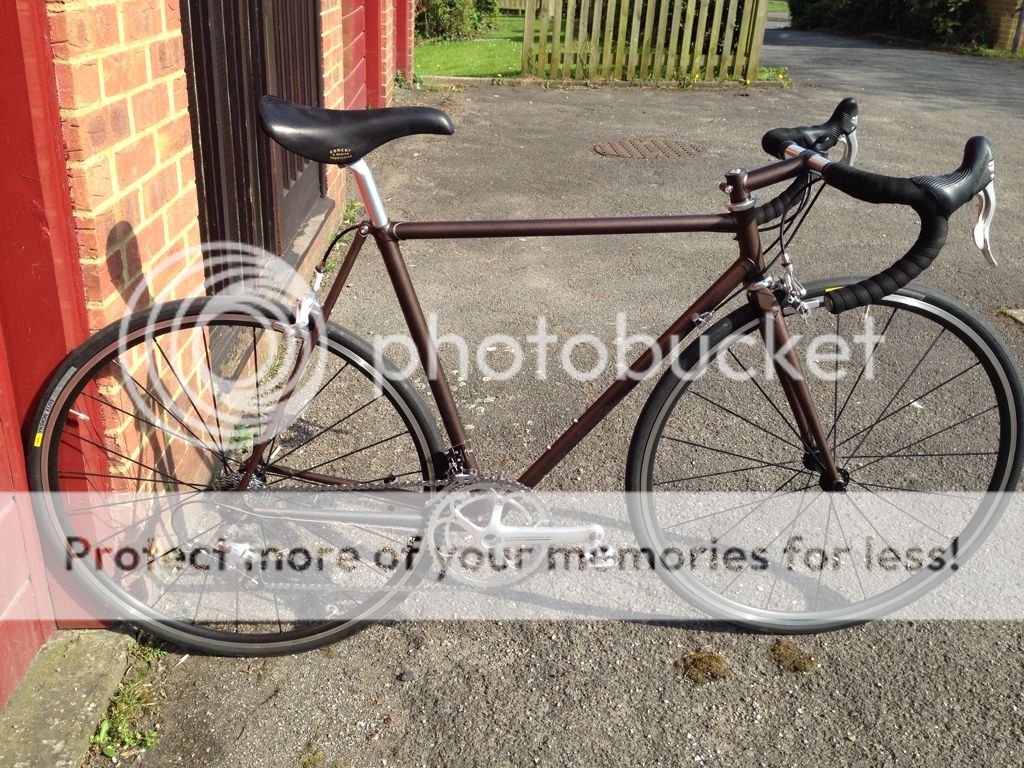

Finishing kit is not-too-modern looking - so NITTO S65 seatpost, Concor Saddle, Silver Centaur / Athena Mix... with athena shifters and skeleton calipers... A compact bar from Soma and some de-stickered DT swiss Wheels (with the groovy star ratchet hub). The rear mech is 105 running on a 9-speed hub - which works perfectly with the 11sp athena shifters! (shimergo)
I'm very happy with the final product, it rides like a dream and weighs a not-too-bad 9.8kg - with a steel fork and steel stem. I could go lighter quite easily but it'd be far less classy with a carbon fork / seat post or skinny modern saddle.
The bike is used to cycle my 20 mile daily commute and it's sturdy construction, steel fork and 25c tyres shrug off the worst of London's potholes! The 9 speed drivetrain is harder wearing and cheaper to maintain than a 10 or 11 speed set-up - so makes sense for commuting.

i like the idea of painting the stem to match for this build.
