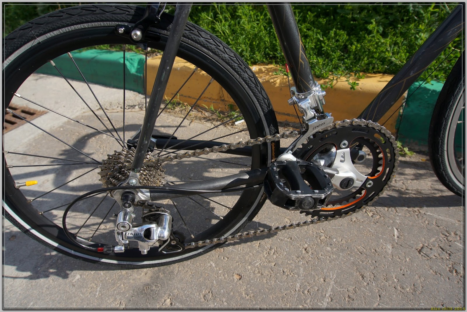

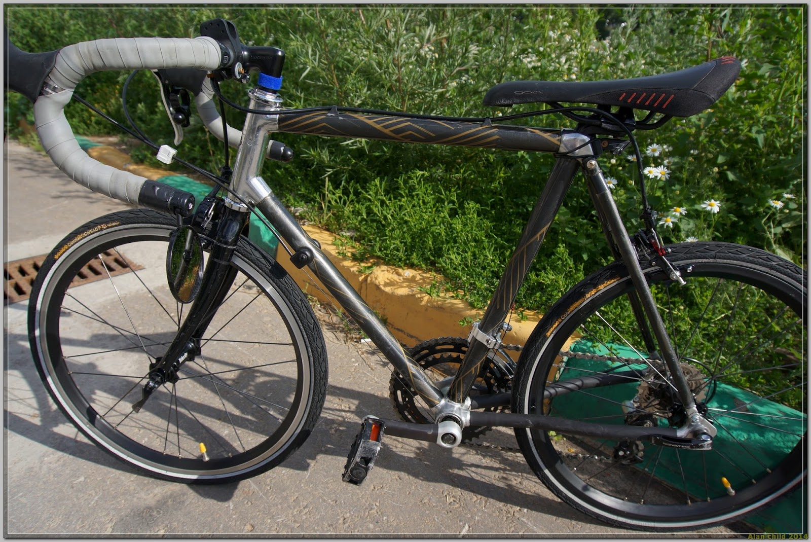

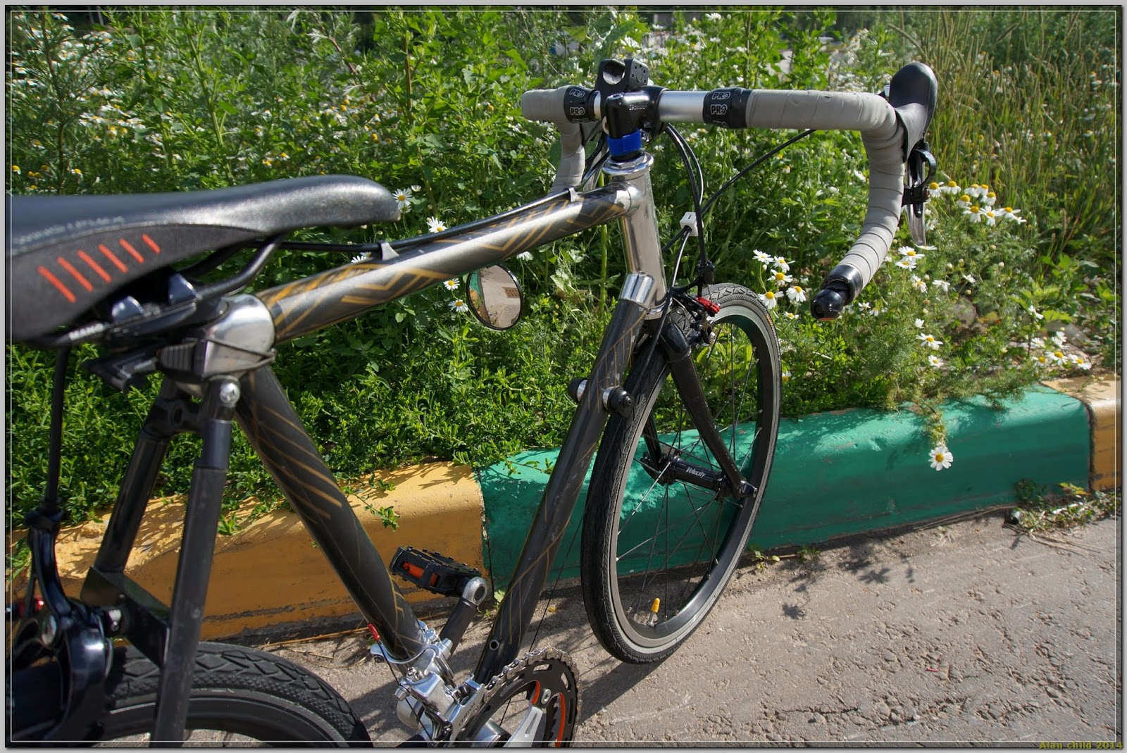

New 2016 project : adult frame to kids road 24"
Was:
The purpose of this project was making the small road bicycle on the Vitus's normal adult frame basis.
UPD Alan carbonio restoration...
Here you can see full story

Jesus H Christ, this is brilliant, I've often wondered how possible it would be to do this. Even with the 992 round to ovoid tubes, this is more than possible if you have the knowhow to de-bond and jig-up a smaller frame of usable geometry. I assume you sized the frame around the wheels? Theoretically you could go smaller still.

I've bought (ebay) already cracked frame especially for this project, vertical tube had small defect.
So during this project any normal frame didn't suffer. :D
I've plan to change saddle ( small one), replace red housing to black, remove decals from wheels.
And wait untill my son will grow up enought... 8)

I sized frame around the wheel ( 20 inch is very suitable for this age)naturally, but the main limiting factor is fork. I can' imagine how to make road fork shorter than for 20" ( due to fixed lenght of front axle )

:D That is superb, what did you use to rebond the joints?
