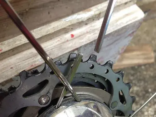

Arghh! Only my second proper ride and a spoke has snapped on the rear wheel. I noticed it had a small kink in it near the hub - I suspect a derailleur had collided with the spokes at some earlier point. So I'm gutted and left with a Vento rear wheel that's unusable. Any thoughts on rebuilding it? Or should I right off the wheel? Something I can't really afford to do as the whole bike has been on a tight budget really...

I would say getting wheel fixed at local bikeshop (if you can't do it yourself/can't bribe somebody with beer) should cost less than a new wheel? If the rim etc. is still in good nick and it's just one spoke that went...

The difficulty is finding the right spokes - I believe they are straight pull Sapim CX spokes... Anyone with experience of sorting out these wheels, I'd love to hear from you

Those wheels were made for about a decade so finding a replacement spoke should not be a problem. Plus Campagnolo was always good about making replacement parts available.

I spoke to Velotech Cycling who are a stockist of Campag spares and they said Campagnolo ran out of spare spokes over 5 years ago :-(
