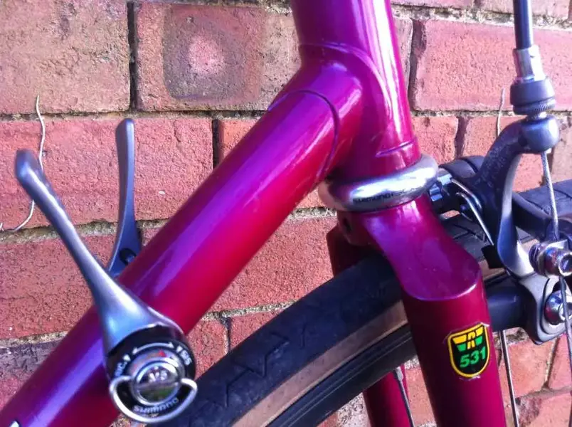

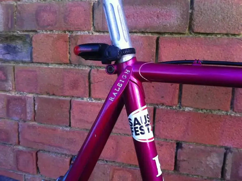

Evening all,
Thought I'd share the following, and hopefully stir up some thoughts on precisely what I've got.
Bought last year as a frame and forks and built up with a Shimano 600 Ultegra groupset, it's got the serial number WB6000511. Based on posts elsewhere on the forum I've taken this to mean it dates from 1986. Frame size is 25".
It's clearly had a respray at some point in its life- from the colour I'd guess early to mid-90's- and although the top tube has picked up a noticeable ding up towards the head tube everything is still straight and true. The rear brake bridge has a recessed allen key fitting, whereas the front fork doesn't- taken with the dented top tube I wonder if it was crashed and the forks were replaced? Or were unmatched brake fittings common at that time? Both front and rear drop outs are Campagnolo, so if the forks were replaced it was with a very close match. Only the forks have 531 decals, but as the total weight of the bike is 24lb complete I've been working on the assumption that the main frame tubes are 531 as well, if not the stays. Annoyingly I forgot to weigh the frame and forks separately before building the bike up, so I'm missing any clues to be had there.
Looking at the 1987 Raleigh Lightweights catalogue scan that's also posted on here, I could see a few similarities with some of the named frames, but not enough for me to confidently say it's one thing or another. My gut feeling is that it's a decent but middling frameset, possibly built to order, but I'd love to hear from anyone who knows a bit more!
The most important thing though, regardless of that, is that it's great fun to ride and as far as I'm concerned looks fantastic into the bargain!
File comment: 1986 Raleigh
File comment: Front fork- allen key fitting brake is bolted on inside the fork crown, not ideal but no problems so far!
File comment: Rear brake bridge
File comment: Seat cluster

That is a lovely bike, but i cant help you with the model.
As a guideline of weight i have a 25" 1982 raleigh competition (full 531 frame & forks) and it weighs 22.5lbs.
But mine has campag gears & wheels, with weinmann brakes which may be lighter than the 600 groupset, i wouldnt know. It weighed 19.4lbs minus the tyres, tubes, chain & pedals.

Looks like a triathalon with an older set of fully sloping crown forks..........lovely colour though :)

I'm not that hot on later tubesets, but I think if it takes a 27.2mm seatpost, it'll be a butted 531 frame or comparable, especially if it has Campagnolo ends. The lugs suggest this also IMO..

I see what you mean about similarities with the Triathlon, but it doesn't have mudguard eyelets or clearance for them either.
And I'll need to check the seatpost measurement but that's a good pointer, thanks!
