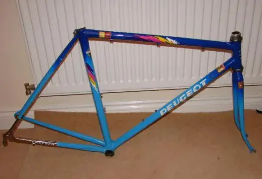

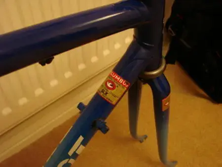

Heres the frame...amassed some Campag Chorus bits to go on too...

Very nice .
Had a 75km ride on mine yesterday , and it rides so nice .
Have you serial number ?
The catalogue only seem to have the 753 version , no slx .

Dont think they ever made a frame with SLX, it looks more like the Chorus 753

They did infact sell an SLX framed model in Europe in 1991/1992, it was also offered as a frame only here in the UK as part of the 1991/1992 model year...same colours as the 753 chorus.
This is most definitely SLX due to the helicoil ribbing evident when I rammed my finger up the chainstays and seattube...oooo eerrr matron!
Frame No is - 0042590
Rear O.L.D 130mm on this too.
A nice compliment to my Record equipped 992 in sig
