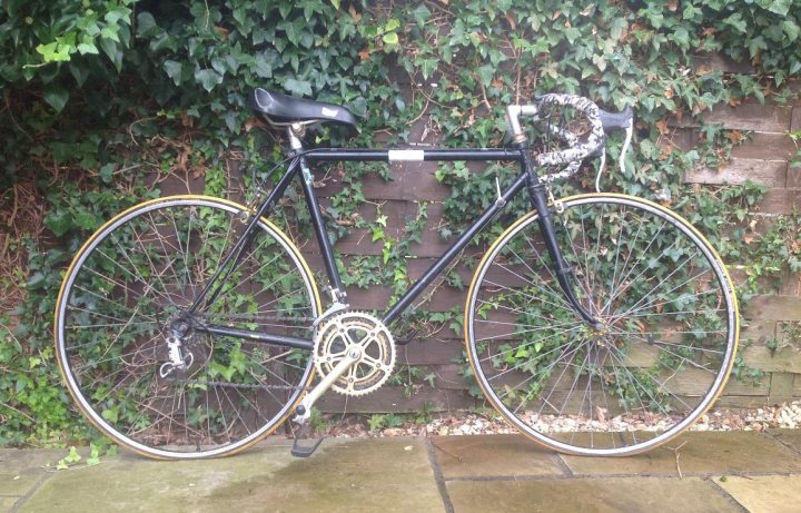

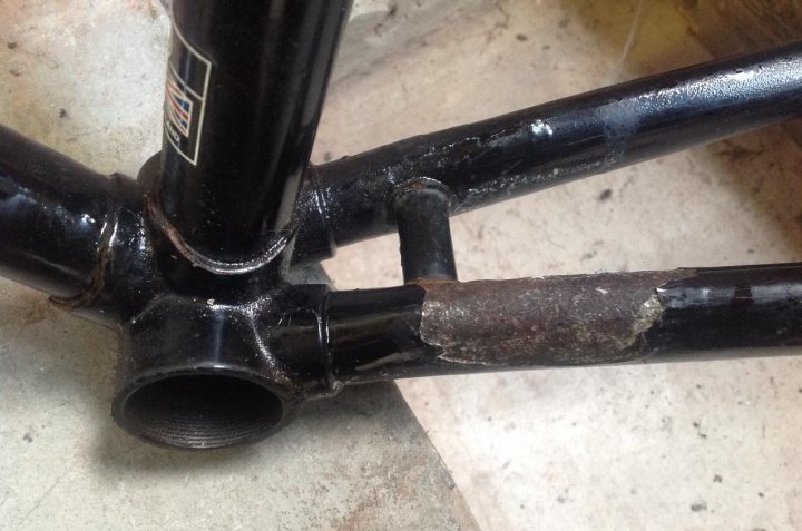

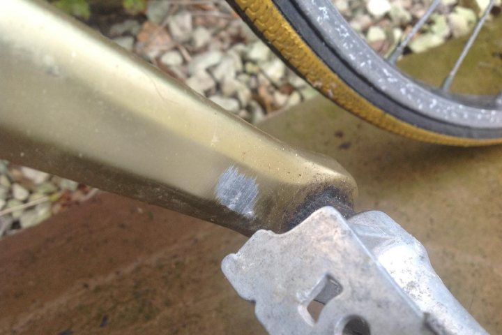

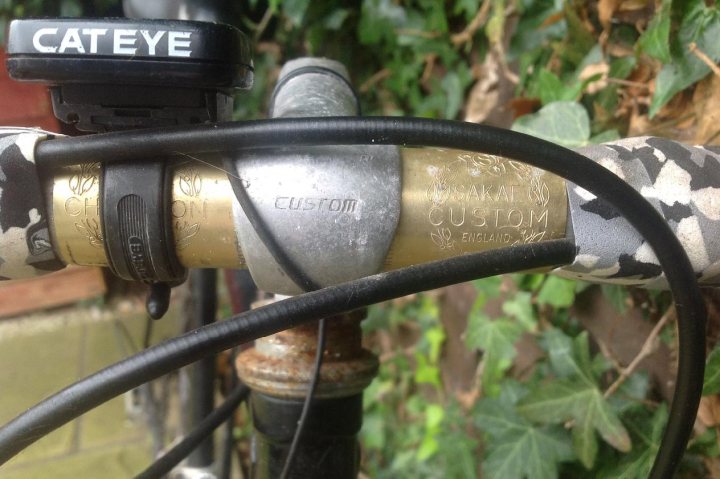

...and having hacked away the ivy that had grown around it in the shed, this is what I was left with:
Not particularly promising, but the only real concerns were the rust on the chainstays, the corroded spokes and the fact that some of the gold anodising had been scuffed away.

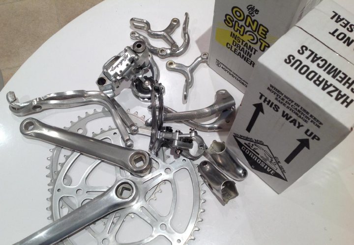

Having wasted a morning painstakingly trying to sand off the remains of the original finish, I discovered (thanks to Google) that simply chucking anodised parts in caustic soda for a minute or two is all you need to do to strip the surface away.
Sure enough, they came out silver (well, grey) and a bit of wet n dry and a tin of Silvo brought out the shine.
Now the hard part – re-anodising them. Beyond the basic concept, I didn’t know anything about anodising. All the websites I found seemed to imply that while the chemical process is simple, achieving a good finish could be tricky and required all sorts of specialised chemicals and equipment.
The more I read, the more complex it sounded. There were all sorts of variables – temperature, acid concentration, current, time, dye solution, cathode size, etc. On the grounds that various people claimed to have achieved good results with very different methods I just decided to experiment and see what happened. The first stumbling block was finding some sulphuric acid. Online suppliers seemed expensive and wanted to charge extra for specialist couriers. In the end, B&Q came up trumps – they sell something called One Shot Instant Drain Cleaner which turns out to be 91% sulphuric acid.
A bit of trial and error followed – various proportions of acid to water (and if you’re going to have a go, do make sure you add the acid to the water and NOT the other way around), different lengths of time, etc.

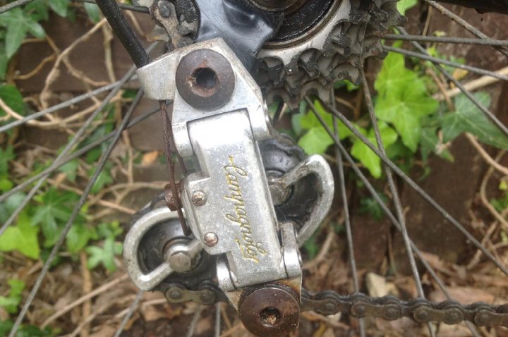

It didn’t help that the different components were made by different companies, using different alloys. Some took dye quite well, others not so well. At one point I considered doing the derailleurs and downtube shifters but the parts that were meant to be gold were causing enough headaches without adding to the problem by trying to dye bits that were originally silver.

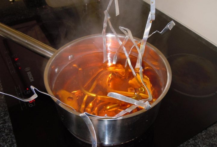

After several unsatisfactory efforts, I abandoned the printer ink and my dad repeated the process with some proper gold anodising dye he’d found online. You can see the colour being fixed in hot water here:

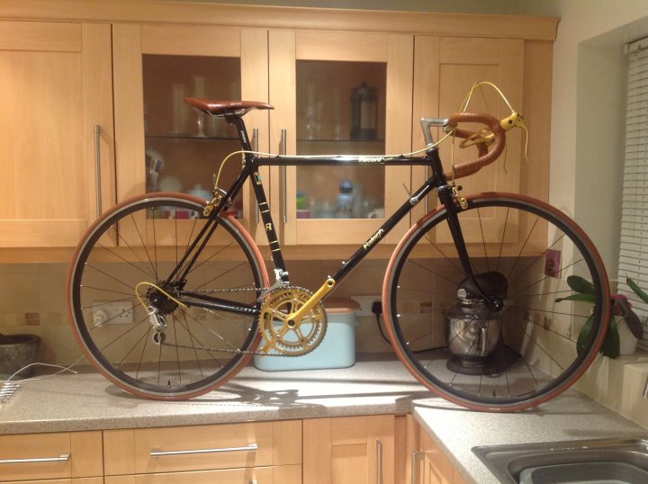

There were a few parts that were too manky for someone with my limited skills to sort out. Chief amongst them were the wheels - the hubs were fine but the rims were gouged and the spokes were shot. I did polish one or two spokes but within a week or so they were showing signs of corrosion again. I looked into stainless spokes but I’d have needed quite a few and the cost (not to mention the prospect of trying to tension them correctly) put me off a bit. In the end, I found a set of used Ritchey Pro wheels on eBay. Nothing fancy in wheel terms but infinitely lighter and more modern that the originals. The new hubs were wider than the frame was designed to accept but, being steel, there was enough flex in the frame to accept the wider wheels without any trouble. Unfortunately, the new wheels didn’t come with a cassette and the original one was no use as it was a screw-on freewheel. Having bought a new cassette and chain, it would probably have been cheaper to repair the old wheels – you live and learn I guess!
Aside from the wheels, I replaced the seat post, seat, brake cables, bar tape, tyres and headset. I thought I’d go for brown bar tape, seat and tyres just to make it stand out a bit but now I look around on the web it seems like a lot of other people with black bikes have had the same idea!
