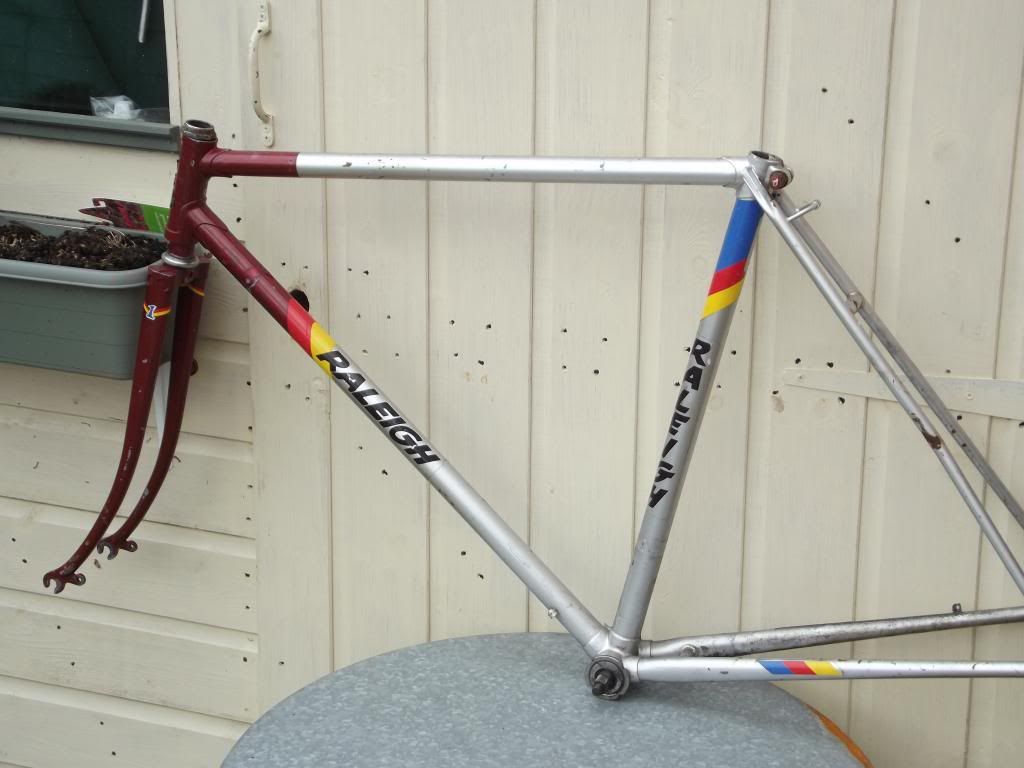

Anyone know what model this is ?
Does anyone know what size headset bearings and cups fit
Thanks
Chris

Look on the LH BB cup, it will tell you the thread pitch there:
If 1.37(or 1 3/8) * 24tpi then it is British
If 1.37(or 1 3/8) * 26tpi then it is Raleigh.
The headset thread should be the same as the BB, so if a British BB, it should have a British headset.
If it is for a beater project AND it is Raleigh thread (which I suspect it may well be) you can get the threads re-cut to British, not a big job and any LBS or friendly bodger with the right tools should be able to do it for you.
You will have a hell of a job, if you haven't got a large, heavy workbench and a large vice, getting the DS cup out though (BTDTGTTS)

Had a look at the BB all I can find is IN49 in very small letters, the frame number on the seat tube is NE1434021, Any ideas ?
Thanks
Chris
